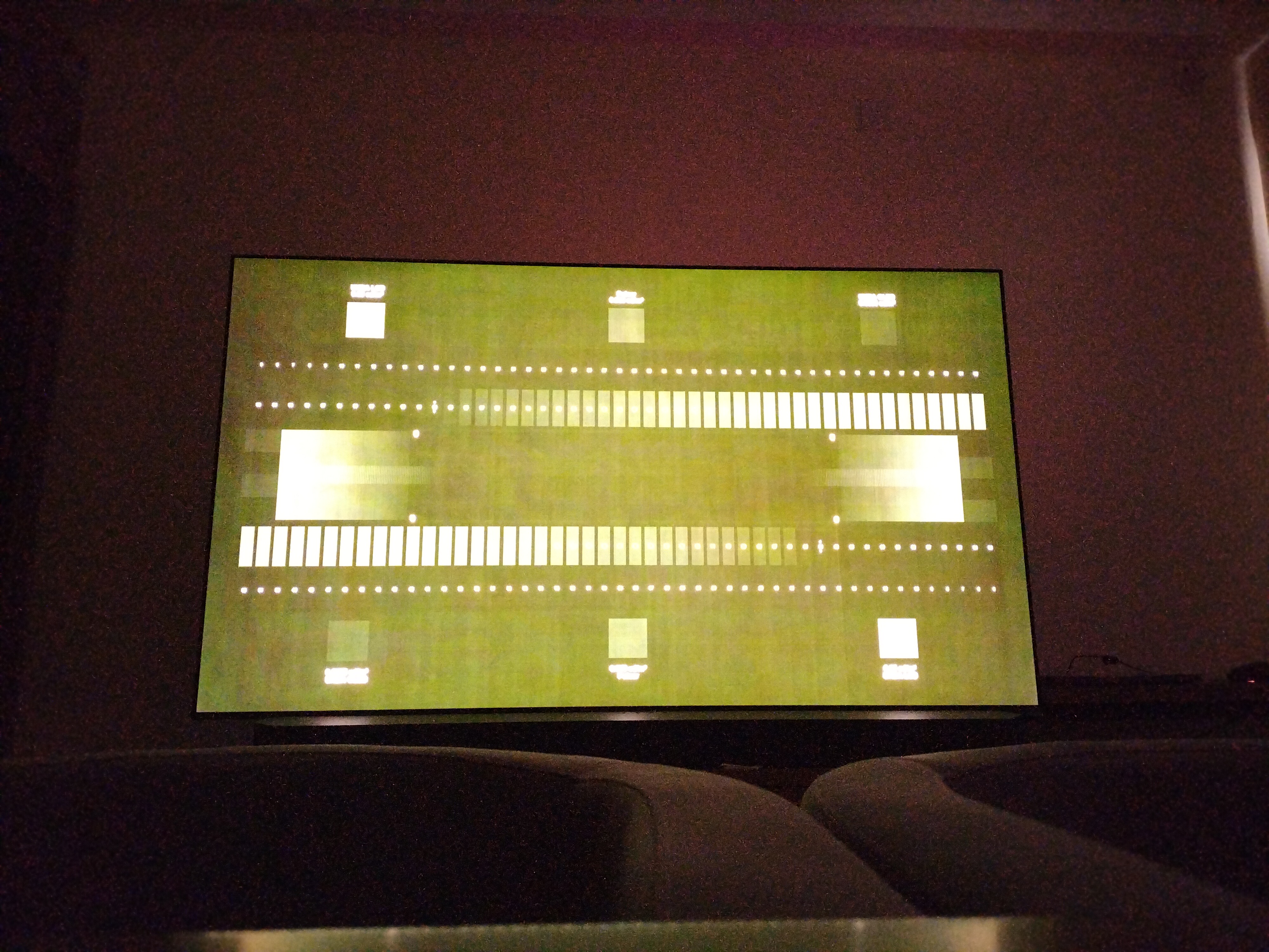

#9669 Post by sw5163 » Fri Feb 02, 2024 2:34 am
RESET_9999 wrote: Fri Jan 26, 2024 7:34 pm Same story on my PC monitor(samsung 400nits) with the Energy player.
Hi RESET, I still notice raised black level when using Microsoft Hardware Video Decoder in the Energy player. I've tried both on Oled G8 monitor and S95C TV. Does this happen to your samsung monitor? I began to worry there's something wrong with my settings.
Currently, I set output to 10bit Full Range RGB HDR in the AMD control panel, and Full Range input in samsung menu. I've tried restoring all other settings to default, but it doesn't change anything. Do you know if any other setting that may cause the problem?

#9671 Post by RESET_9999 » Fri Feb 02, 2024 12:24 pm
sw5163 wrote: Fri Feb 02, 2024 2:34 am Hi RESET, I still notice raised black level when using Microsoft Hardware Video Decoder in the Energy player. I've tried both on Oled G8 monitor and S95C TV. Does this happen to your samsung monitor? I began to worry there's something wrong with my settings.
I'll check on my C2. On the Samsung LS49CG932SNXZA , it seems fine. I use 444 12bit and the video I did on youtube about this player was captured/played in 422 12bit.

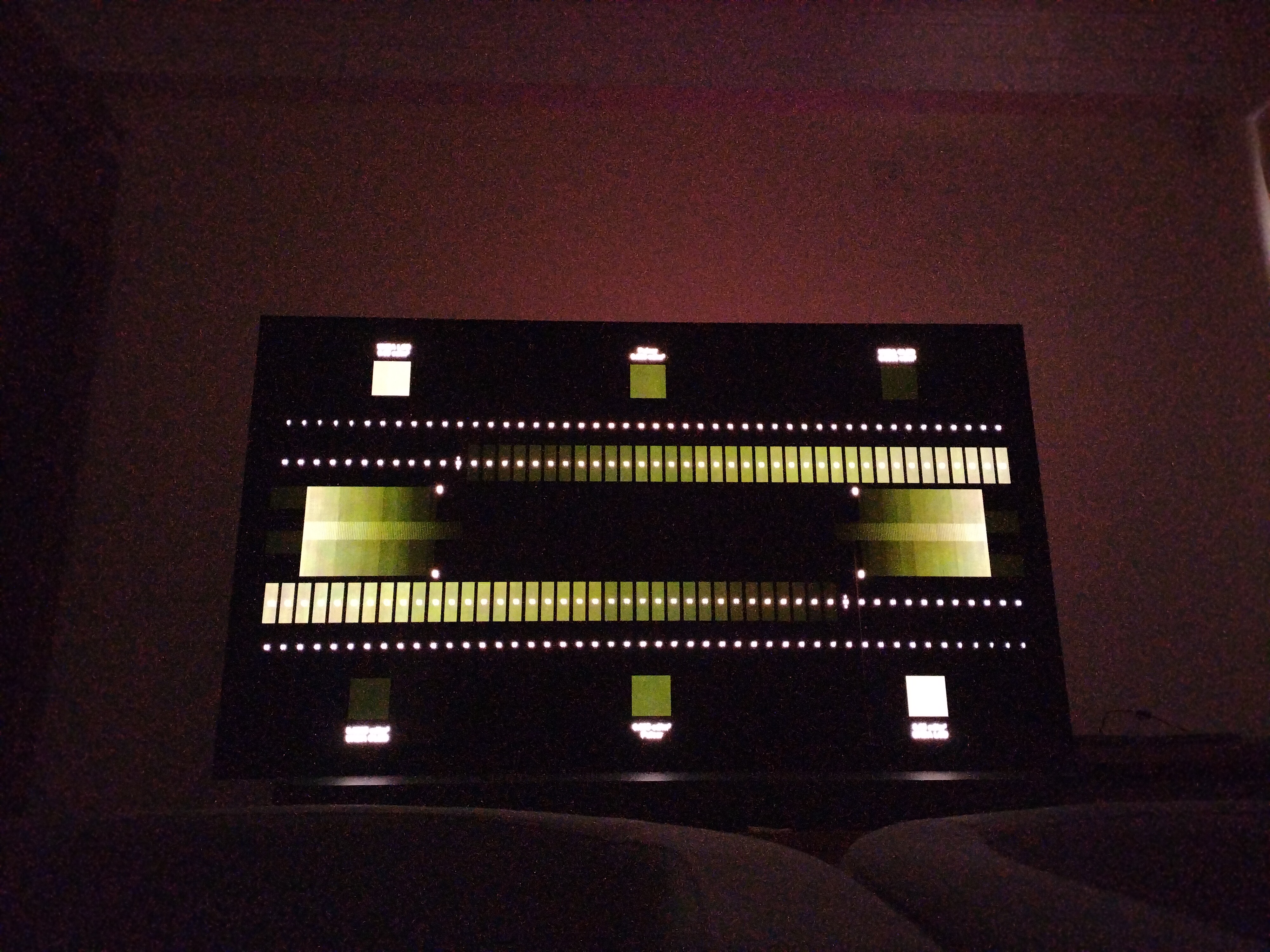

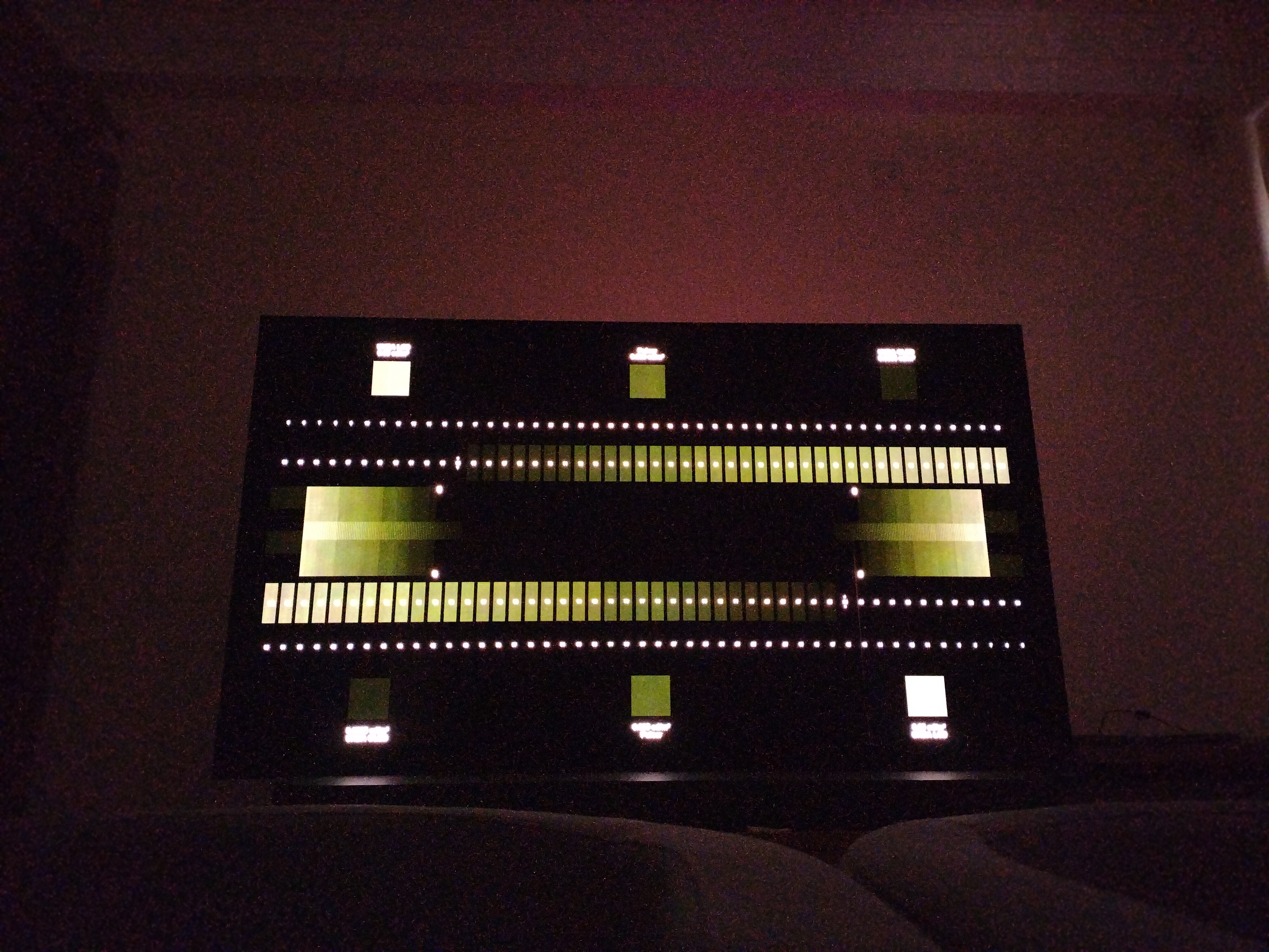

#9673 Post by sw5163 » Sat Feb 03, 2024 7:30 am
RESET_9999 wrote: Fri Feb 02, 2024 12:24 pm On the Samsung LS49CG932SNXZA , it seems fine.
Do you have Game Mode on or off on that monitor?
RESET_9999 wrote: Fri Feb 02, 2024 12:24 pm I use 444 12bit and the video I did on youtube about this player was captured/played in 422 12bit.
I just tried YUV 444 12bit, still the same. Both P5 and P8.1 contents have raised black on my setup. I also tried your black test file.
Playing directly in Samsung internal player:
Playing in Movies & TV app:
These photos were shot with 6400 ISO and 32 seconds exposure, the green is actually dark grey and wasn't that bad to naked eyes. I'm going to check with another Nvidia laptop later in case it's an AMD APU problem.
powdeau

sw5163 wrote: Sat Feb 03, 2024 7:30 am These photos were shot with 6400 ISO and 32 seconds exposure, the green is actually dark grey and wasn't that bad to naked eyes. I'm going to check with another Nvidia laptop later in case it's an AMD APU problem.
wow, ok no there's no such issue on my setup (nvidia). Blacks are actually better than in HDR10 when I put them side by side.
And no crush, I can see 65 flashing. I forgot to check on the C2 but if it was as bad as in your photo, I would have noticed the other day.
this is on the Samsung G9
