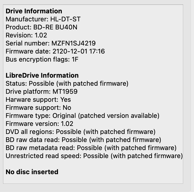

Hi All,
I'm a bit new here but I'm trying to flash a drive using my Mac. I thought I had successfully flashed a drive. See text from the terminal session I ran.
boldenamt@Allens-Mac-mini MacOS % ./makemkvcon f -d '/IOBDServices/72B3EF48' -f ~/Desktop/sdf.bin rawflash main -i ~/Desktop/HL-DT-ST-BD-RE_BU40N-1.03-NM00000-211810241934.bin
Reading input file /Users/boldenamt/Desktop/HL-DT-ST-BD-RE_BU40N-1.03-NM00000-211810241934.bin
Current Drive ID: HL-DT-ST_BD-RE_BU40N_1.02_212012011716_MZFN1SJ4219
yes
100% Operation finished
Done successfully
After running this operation and opening MakeKKV, it still shows the drive is on Revision 1.02. Does anyone have any idea where I went wrong?
Any help appreciated. I'm using a archon MD-8107X-U3YC-UHD.
Thank you!!!!
