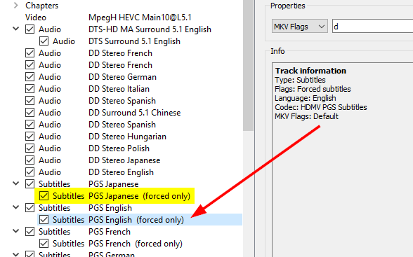

When ripping this 4K, the playback contains Japanese subtitles by default since its first in the list and contains the default flag (as highlighted in yellow).
Setting the default MKV flag to the English Forced doesn't change the behaviour, as the Japanese subtitles is still selected by default and appears on playback.
Which title should be set to default as I don't want either Japanese or English subtitles to appear (other than English Forced)?

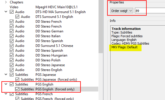

In the end, all I really had to do was follow this post to change the order weight:
viewtopic.php?f=1&t=31815
The default order weight was 90 for all subtitles, so I changed the Eng and Eng Forced weight to 89 giving them priority.
As soon as I did this, the Eng Forced became the 'default' as shown for the MKV Flags.
MPC-BE now shows Eng as the first subtitle (previously it was showing Japanese as the first) and the titles come up as English.
