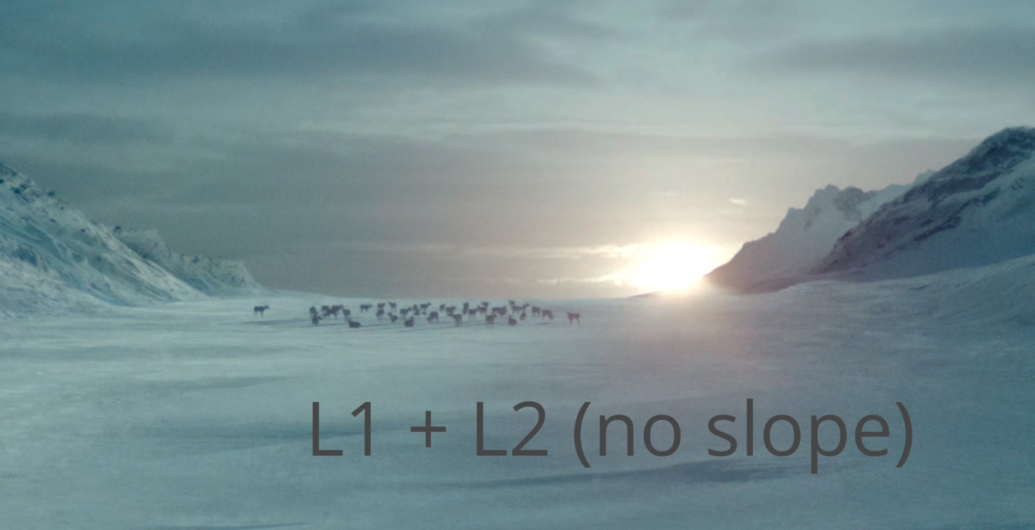

The L2 offset metadata with positive lift (over 2048) has no effect on TV-LED HDMI devices which makes the image darker than the TV's internal player. I just checked on my C2 and its quite noticeable.aboulfad wrote: Fri Jan 19, 2024 11:50 pmSorry what's supposed to happen (I forget a lotRESET_9999 wrote: Fri Jan 19, 2024 9:21 pm new test file like the eagle beak sample but this time, the L2 trims are a positive lift..). Tried it on Oppo (TV-Led)/E7 & maybe noticed a change in brightness in the first transition.
I made another test file with even lower nits and you still can see the effect is missing on HDMI devices. It's not as obvious as the true detective sample but look closely in the background, the vegetation..
P8: https://drive.google.com/file/d/1heOJEH ... drive_link
P5:https://drive.google.com/file/d/1UfXlDb ... sp=sharing
PS The files are not generated metadata, they are real scenes, original L2 trims and L1.

- true-detective.jpg (173.15 KiB) Viewed 13105 times

I did 3 new samples in total now.
One more test file, The L2 trim offset bug is a lot more obvious in this one because I took the latest Mission Impossible which has a huge positive lift well over 0.025 so it should be also a good test for raised black bars on device that ignores L5.
P5 https://drive.google.com/file/d/1HcrR1q ... drive_link
P8 https://drive.google.com/file/d/1ndR6_S ... sp=sharing

no photo is needed, you should see a visible change for L1 + L2 (no offset) on your TV internal player but not on your Oppo or ATV in tv-led. Same story if you take any of the patterns quietvoid and I did but these new test files are with real content.
True Detective sample: Offset response is quite obvious on the internal TV player
Role Play: almost unnoticeable, the vegetation in the background is brighter with L2 offset on the internal TV player
Mi death reckoning: you cannot miss this one, there is a huge positive lift.
Batman (just added in my GD): very slight change with trims offset on TV internal player only
