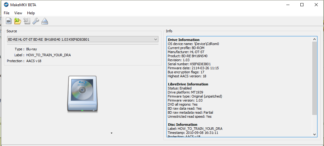

MakeMKV is now showing the below. If it rips OK I'll leave it as is. I bought it off eBay where it's been mislabled so i'll try and get my money back. Not what i was intending to buy. I already have a drive that can read blu-rays. I was looking for a new UHD drive. I had the LG BU40N previously and it was fine but the form factor annoyed me.
Would you have a recommended drive to go for?
