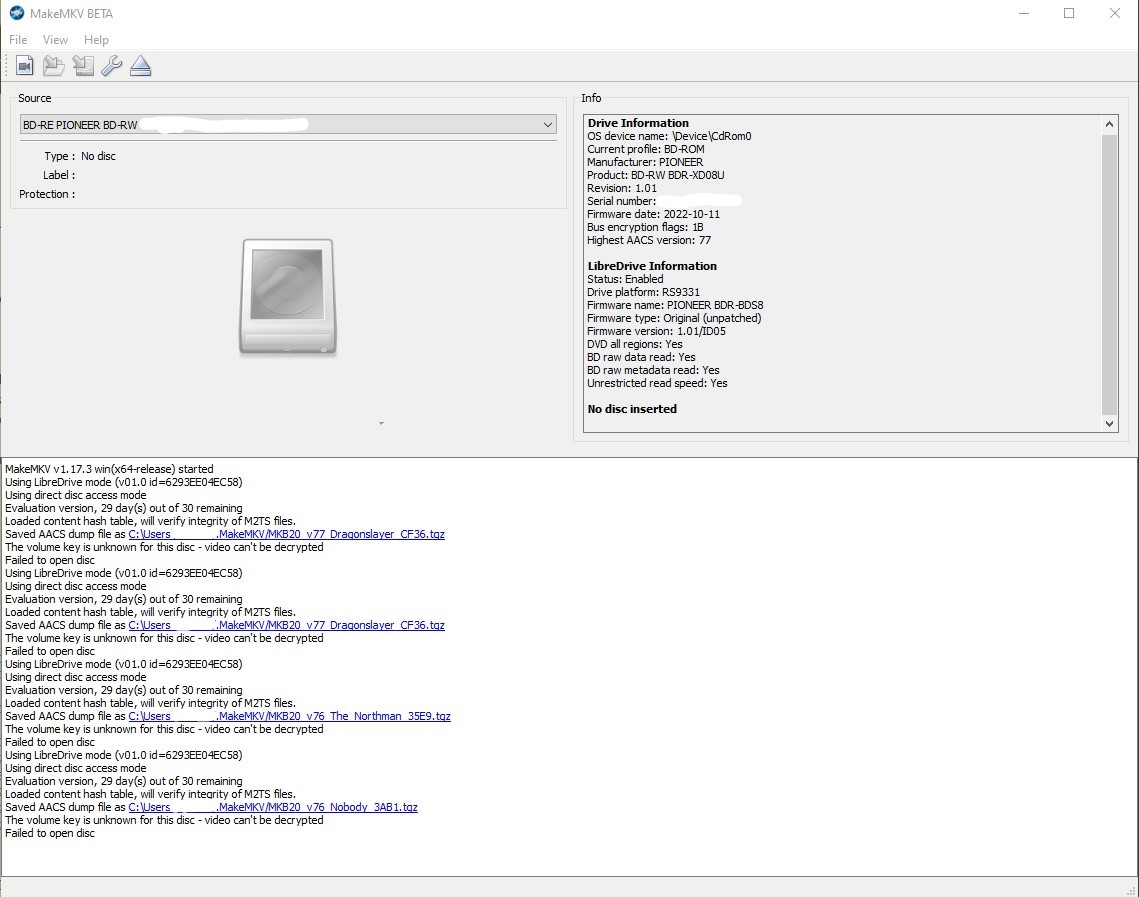

Smith
- Posts: 2
- Joined: Sun Apr 02, 2023 4:06 am
Hello. I am a novice and have not copied 4k discs before, so I don't know if my problem is user error or an unsupported drive.
I just tried and failed copying three 4k discs.
Pioneer BDR-XD08U
firmware BDR-BDS08, version 1.01/ID05, dated 2022-10-11
Pioneer BDR-XD08U
TeddyRaspin
- Posts: 202
- Joined: Thu Dec 28, 2017 1:41 pm
You have to allow internet connection for MakeMKV in order to download latest Hashed Keys
in order to rip UHD content from a protected disk.
Smith
- Posts: 2
TeddyRaspin wrote: Sun Apr 02, 2023 10:42 am You have to allow internet connection for MakeMKV in order to download latest Hashed Keys
Enabling internet worked, Thank You
