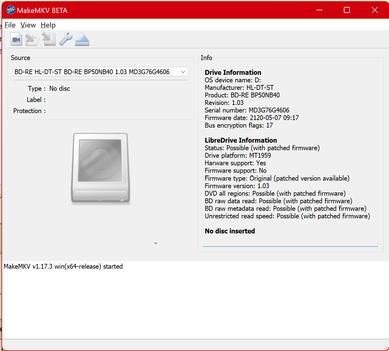

Help with LG BP50N40
Hi, I have an LG BP50NB40 SVC NB40, it has MT1959 and all the requirements. I flashed it to NB50 and then to BP60 but now the tray doesn't open. If I open it with a paper clip it doesn't read discs anymore, it doesn't even spin. MakeMKV recognizes the drive but not the discs. I restored the backup firmware and it's the same. I even used the official LG firmware installer and it's now on 1.03, MakeMKV says it has the original firmware again, but it still doesn't work. I just want it to work again, even if it doesn't support 4k Blurays, I just don't want to buy another one for my 3D blurays. Thanks in advance.
- Posts: 6251
NB 50+ on that one NB 40 it's bricked .
You can recover though with Marty's sdf gui and the nb40 fw
