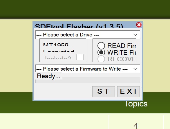

Good Afternoon All,
I'm trying to flash a new LG WH16NS40 to the most recent 102 MK file. However, it does not seem to be working. I cannot see if I have all the settings set up because the app is crushed into a tiny box. I'm using Windows 11 64 bit.Image
Screenshot 2023-03-26 142756.jpg (43.32 KiB) Viewed 28619 times
Posts: 1716
Post by d00zah » Sun Mar 26, 2023 8:17 pm
rellog321 wrote: Sun Mar 26, 2023 7:29 pm Good Afternoon All,
viewtopic.php?p=114370#p114370
rellog321
Joined: Wed Feb 15, 2023 6:28 pm
Post by rellog321 » Sun Mar 26, 2023 9:01 pm
No go with that method. The window completely disappears with those settings. Oh, and I realized I'm on Windows 10, not 11- if that matters....
Posts: 1716
Post by d00zah » Sun Mar 26, 2023 10:52 pm
rellog321 wrote: Sun Mar 26, 2023 9:01 pm No go with that method. The window completely disappears with those settings. Oh, and I realized I'm on Windows 10, not 11- if that matters....
Interesting. Probably best addressed in SDFtool Flasher where the author might have some additional insight. I see he added the note:
NOTE: If the GUI looks a bit deformed (happens on a 4k monitor), you can right click the exe and select properties. In the compatibility tab, click "Change high DPI settings" then under "High DPI scaling override" tick the box and select "System (Enhanced)" in the dropbox.
so it might be something unique to your setup?

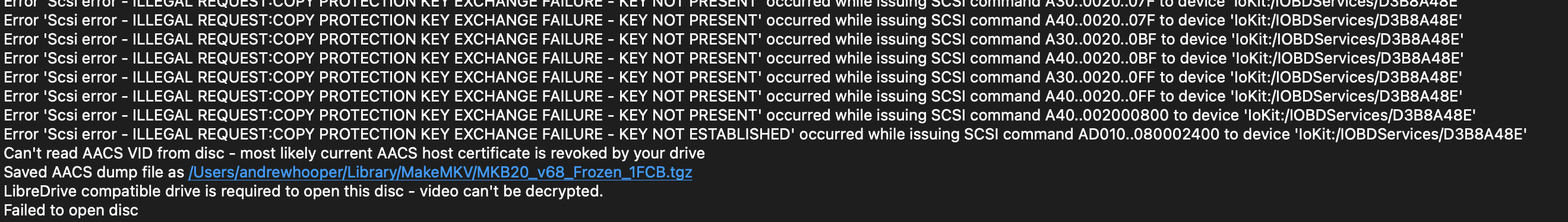

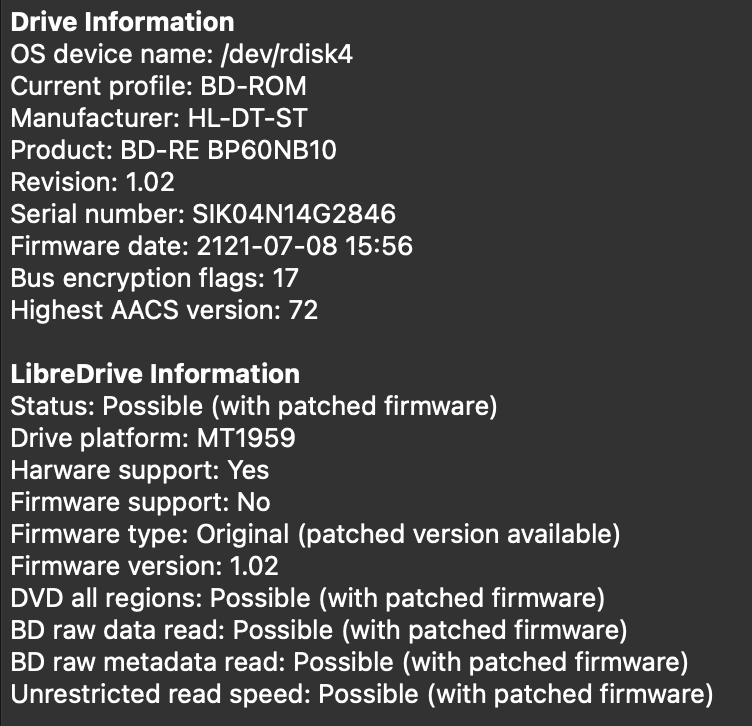

LG BP60Nb10 with SVC NB12 using a Mac M1 to flash. I have followed the guide and to no avail! MakeMKV tells me the disk cannot be decrypted. I have tried 3 different LG firmware options out of the all you need firmware pack. Can someone point me in the right direction? Which exact firmware should I be selecting?

Posts: 6016
Post by Billycar11 » Fri Mar 31, 2023 3:14 am
andrewtopher wrote: Thu Mar 30, 2023 9:28 pm LG BP60Nb10 with SVC NB12 using a Mac M1 to flash. I have followed the guide and to no avail! MakeMKV tells me the disk cannot be decrypted. I have tried 3 different LG firmware options out of the all you need firmware pack. Can someone point me in the right direction? Which exact firmware should I be selecting?
Your flashing it wrong forgetting enc probably
