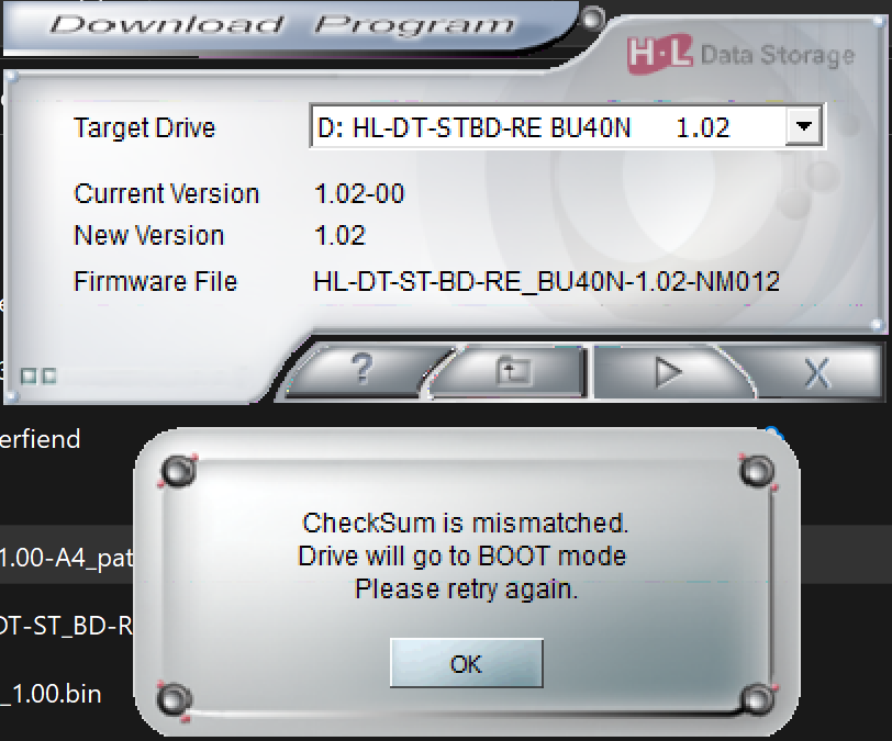

I have tried several methods to flash my Archgon MD-8107-U3 so far with no luck. Here is the information I get from MakeMKV:
Product: BD-RE BU40N
Revision: 1.02
Serial number: MO8M2QI0627
Bus encryption flags: 1F
Highest AACS version: 77
Harware support: Yes
Firmware support: No
Firmware version: 1.02
I've tried flashing HL-DT-ST-BD-RE_BU40N-1.02-NM01201-211711301218.bin from the old directory of mk-firmware-pack-20200720 if I run the CLI command
makemkvcon64.exe f --all-yes -d D: rawflash -i "HL-DT-ST-BD-RE_BU40N-1.02-NM01201-211711301218.bin"
I get what appears to be a successful message:
Reading input file HL-DT-ST-BD-RE_BU40N-1.02-NM01201-211711301218.bin
Current Drive ID: HL-DT-ST_BD-RE_BU40N_1.02_212012011716_MO8M2QI0627
 100% Operation finished
Done successfully
But when I restart my computer and run MakeMKV again the drive info is unchanged. I know I am missing something and would appreciate any help that can be given.
As to why I ran the CLI and not a GUI the GUI would fail immediately see attachments for a screenshot.

Your firmware is encrypted. Add the enc flag to your command.

Thanks Marty! I added the ENC indicator but now its failing before its done sending the firmware.
C:\Program Files (x86)\MakeMKV>makemkvcon64.exe f --all-yes -d D: rawflash enc -i "HL-DT-ST-BD-RE_BU40N-1.02-NM01201-211711301218.bin"
  98% .................................................
Write DRAM NG 05/26/03
Command produced error code 0x82052603

seen that before either its a whatever error or the case is bad and it cant be flashed through it, recheck your drive info in makemkv see if it flashed it likely did happens alot with amd usb drivers
tegid1977
Joined: Mon Mar 13, 2023 11:27 pm
Post by tegid1977 »
No luck still shows unpatched in makemkv. Does that mean this drive wont work with uhd for makemkv?

Your not using 1.03 like the guide says missed that the first time :roll:

BU40N 1.03 is in the OLD folder of the firmware pack.
tegid1977
Post by tegid1977 »
That did it! Thank you!!
