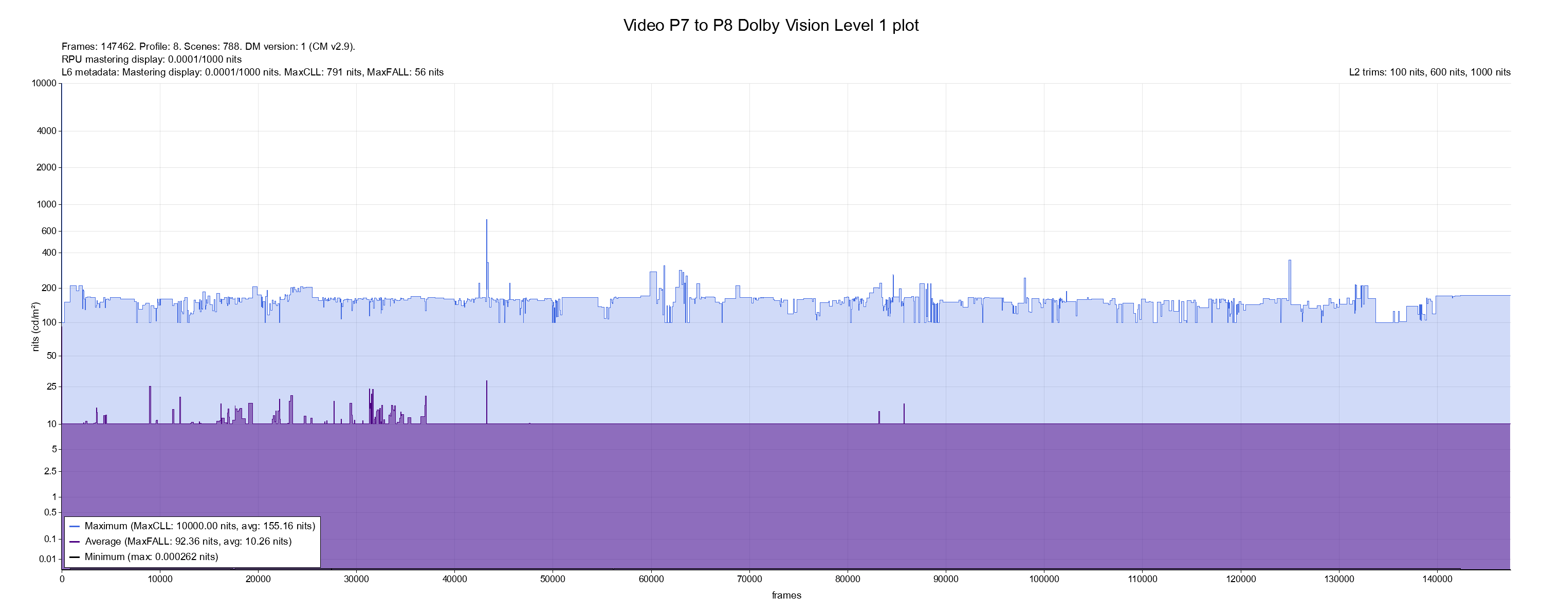

Is this a video that might benefit from a Resolve generated RPU? Original file is BL+FEL+RPU.

Post by RESET_9999 » Wed Mar 01, 2023 8:36 pm
Gatorman wrote: Wed Mar 01, 2023 8:02 pm @RESET_9999
not sure i understand your question... Why would you generate DV when you have the original retail metadata?

Post by Gatorman » Wed Mar 01, 2023 9:16 pm
RESET_9999 wrote: Wed Mar 01, 2023 8:36 pm
That's fair. Is it common to see an "Average" line flat for so long?
Post by RESET_9999 » Wed Mar 01, 2023 9:22 pm
Gatorman wrote: Wed Mar 01, 2023 9:16 pm That's fair. Is it common to see an "Average" line flat for so long?
yes and you would get the same metadata with resolve.
AS long as it's not static or incorrect, the graph (L1) is supposed to be a perfect representation of the HDR grade.
