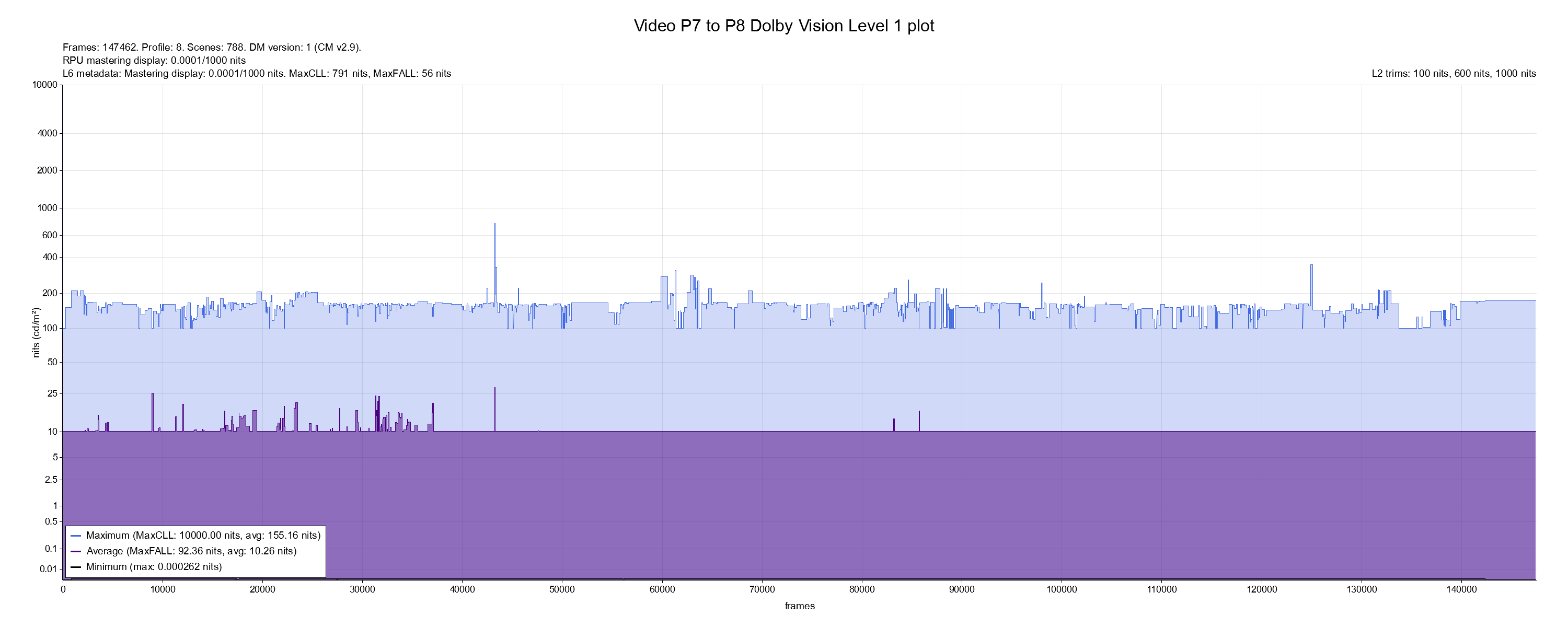

Is this a video that might benefit from a Resolve generated RPU? Original file is BL+FEL+RPU.
Video P7 to P8_DoVi_plot.png (105.43 KiB) Viewed 17391 times
Gatorman wrote: Wed Mar 01, 2023 8:02 pm @RESET_9999
not sure i understand your question... Why would you generate DV when you have the original retail metadata?
Gatorman
Posts: 84
Post by Gatorman »
RESET_9999 wrote: Wed Mar 01, 2023 8:36 pm
That's fair. Is it common to see an "Average" line flat for so long?
Gatorman wrote: Wed Mar 01, 2023 9:16 pm That's fair. Is it common to see an "Average" line flat for so long?
yes and you would get the same metadata with resolve.
AS long as it's not static or incorrect, the graph (L1) is supposed to be a perfect representation of the HDR grade.
