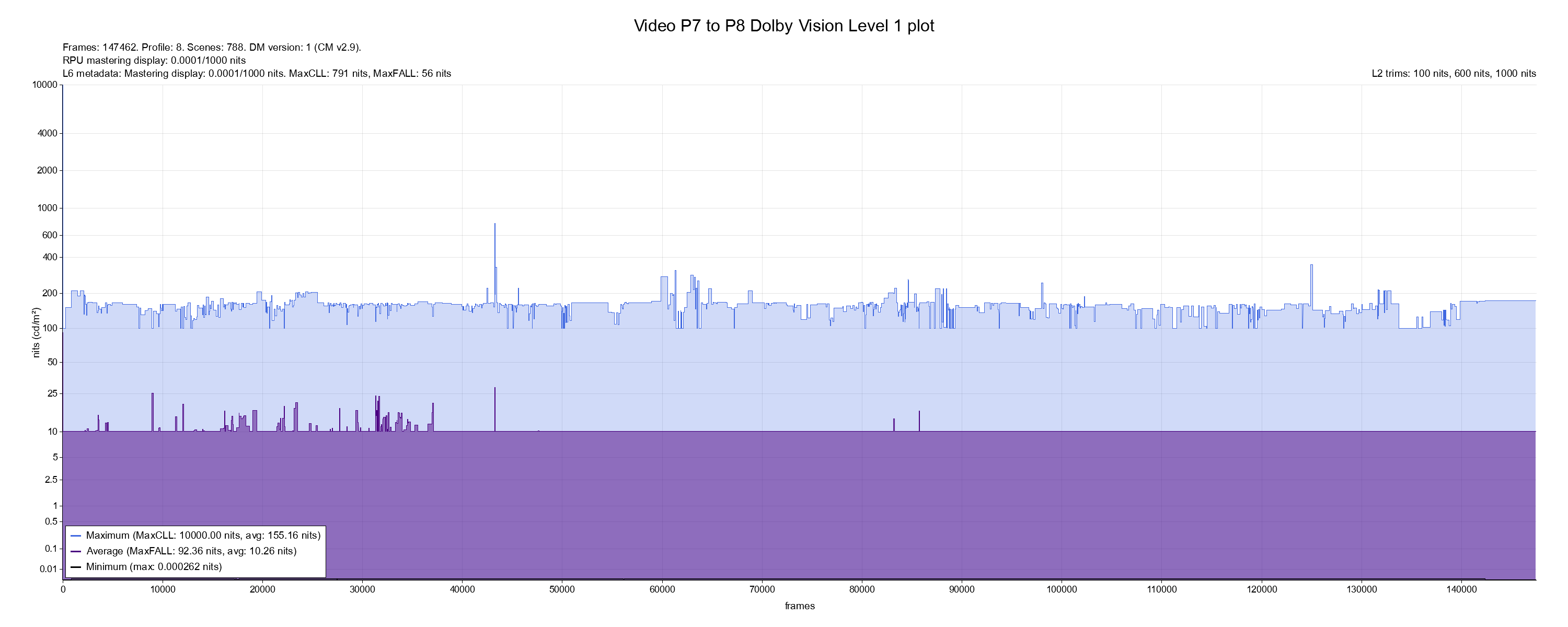

That's fair. Is it common to see an "Average" line flat for so long?RESET_9999 wrote: Wed Mar 01, 2023 8:36 pm

yes and you would get the same metadata with resolve.Gatorman wrote: Wed Mar 01, 2023 9:16 pm That's fair. Is it common to see an "Average" line flat for so long?
AS long as it's not static or incorrect, the graph (L1) is supposed to be a perfect representation of the HDR grade.
