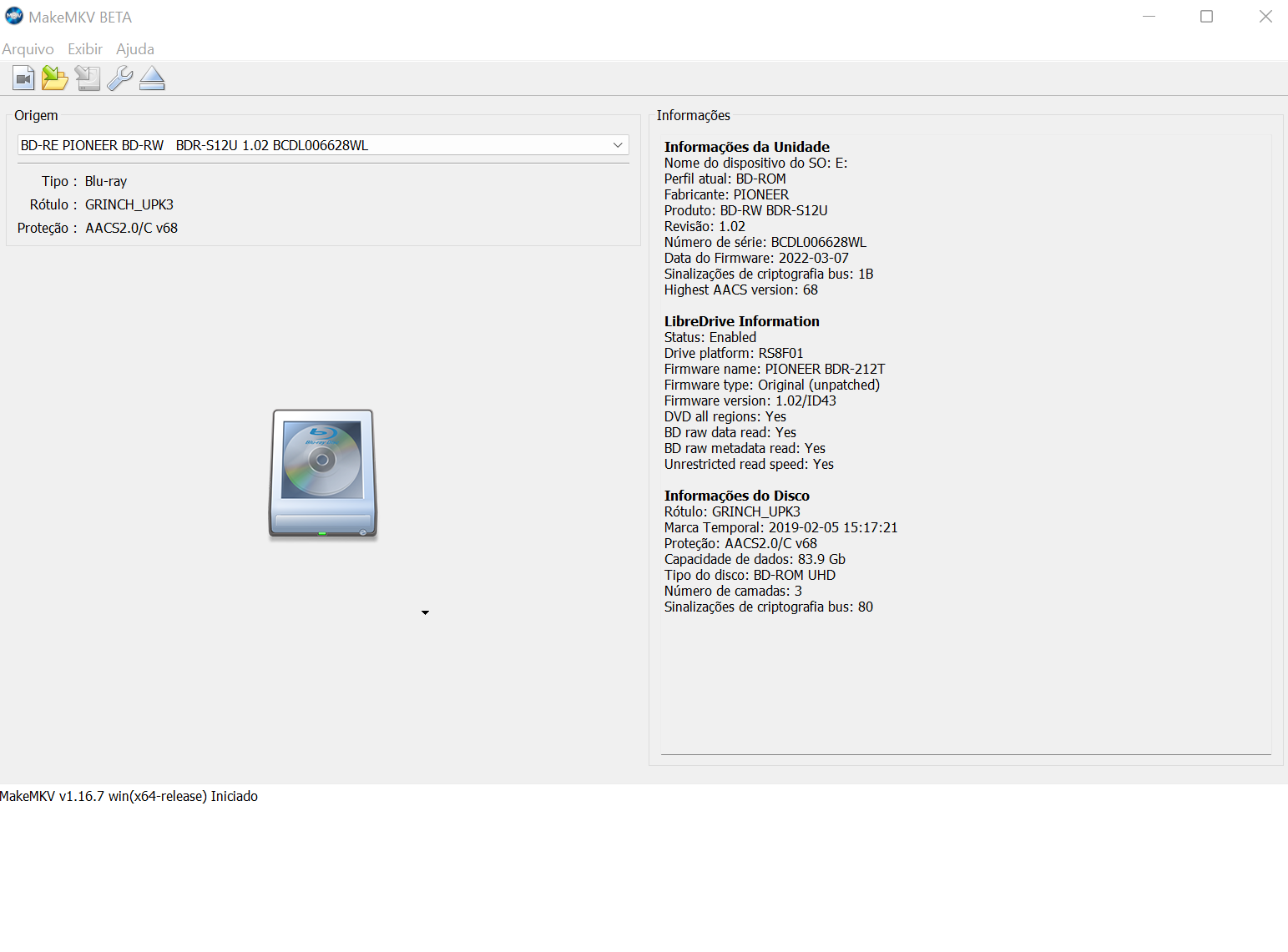

Pioneer BDR-S12UHT
Post by Lbento »
Pioneer BDR-S12UHT Firmware 1.02
Captura de ecrã 2022-05-26 225933.png (107.98 KiB) Viewed 39853 times

Woodstock wrote: Thu May 26, 2022 11:19 pmAnd?
Can update to 1.02, Not UHD frendely but can rip blurays
Posts: 6028
Re: Pioneer BDR-S12UHT
Lbento wrote: Fri May 27, 2022 12:01 pm
You should be able to rip UHD with that
Post by Lbento »
Yes. With makenkv i can.

Lbento wrote: Fri May 27, 2022 12:01 pmCan update to 1.02, Not UHD frendely but can rip blurays
I have FW 1.01 on my BDR-S12U.
Weren't you afraid to lose UHD rip capabilities when updating? And may I ask how you did that?

ArArdin wrote: Fri May 27, 2022 2:20 pm I have FW 1.01 on my BDR-S12U.
You will never lose UHD rip capabilities because the new firmware adds only few improvements
while the libredrive mode is running in RAM (firmware is not overwritten).
In order to upgrade fw, here is the link:
https://pioneer.jp/cgi-bin/device/downl ... W102EU.exe
You have to scrool down page and press "AGREE" button in order to download fw file.

TeddyRaspin wrote: Fri May 27, 2022 2:28 pm
well i just got burned by this post. Went to 1.04 firmware and lost libre. Two brand new never used drives.
Posts: 6028
Mike the developer said few weeks for a fix

gerard143 wrote: Mon Mar 06, 2023 2:46 am
A fix will come. Keep your drives safe.

Hi, any updates on this? It's been a few months. It's showing the following for my BDR-S12UHT:
Drive platform: Pioneer RS8F01
Firmware version: ID43
Posts: 4651
Show the whole status information. If your firmware date is Dec. 2022 or later you have to wait.
