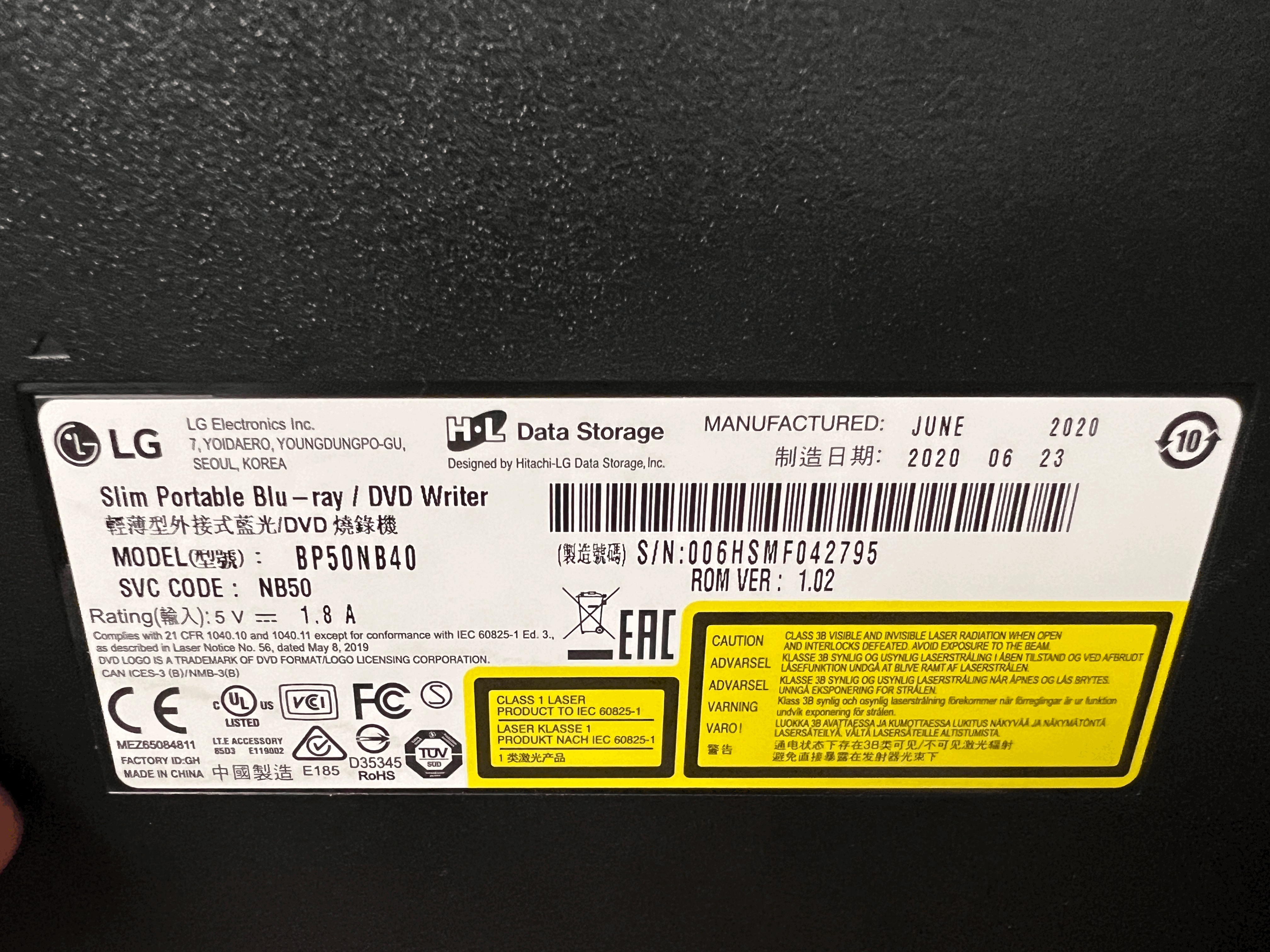

d00zah wrote: Sun Feb 05, 2023 9:27 pm 1.02 is on the 'encrypted' list. Are you using 'enc' as part of the command line?
Billycar11 wrote: Sun Feb 05, 2023 10:05 pm this 100%
Oh goddamnit. For some reason I was thinking they did the encryption crap with 1.03. Thanks, guys.

SamuriHL wrote: Mon Feb 06, 2023 1:49 am
i mean they did after 1.03 so your right its just that archgon is using the Taiwan version of the drive and the version numbers are different 1.02 tw is basically 1.04 us
Oh no kidding?? I didn't know that. Jesus they really threw me on this one. I'll deal with his drive Wednesday and get it back to 1.00 like mine. He'll be using his on a new Samsung book3 ultra with an i9 and 4070. Going to be a sweet little setup.

Yeah take it from me who's flashed several drives using command line on both windows and now Mac, you will need to read and follow it exactly. And know what you're flashing which I clearly didn't. Lol the instructions in the first post are correct. You list the drives to find its id, then use that to flash, making sure to know if the firmware is on its encrypted or not.

SamuriHL wrote: Mon Feb 06, 2023 4:04 am
Shockingly (LOLOLOL), it worked this time. :D Thanks for the help.
