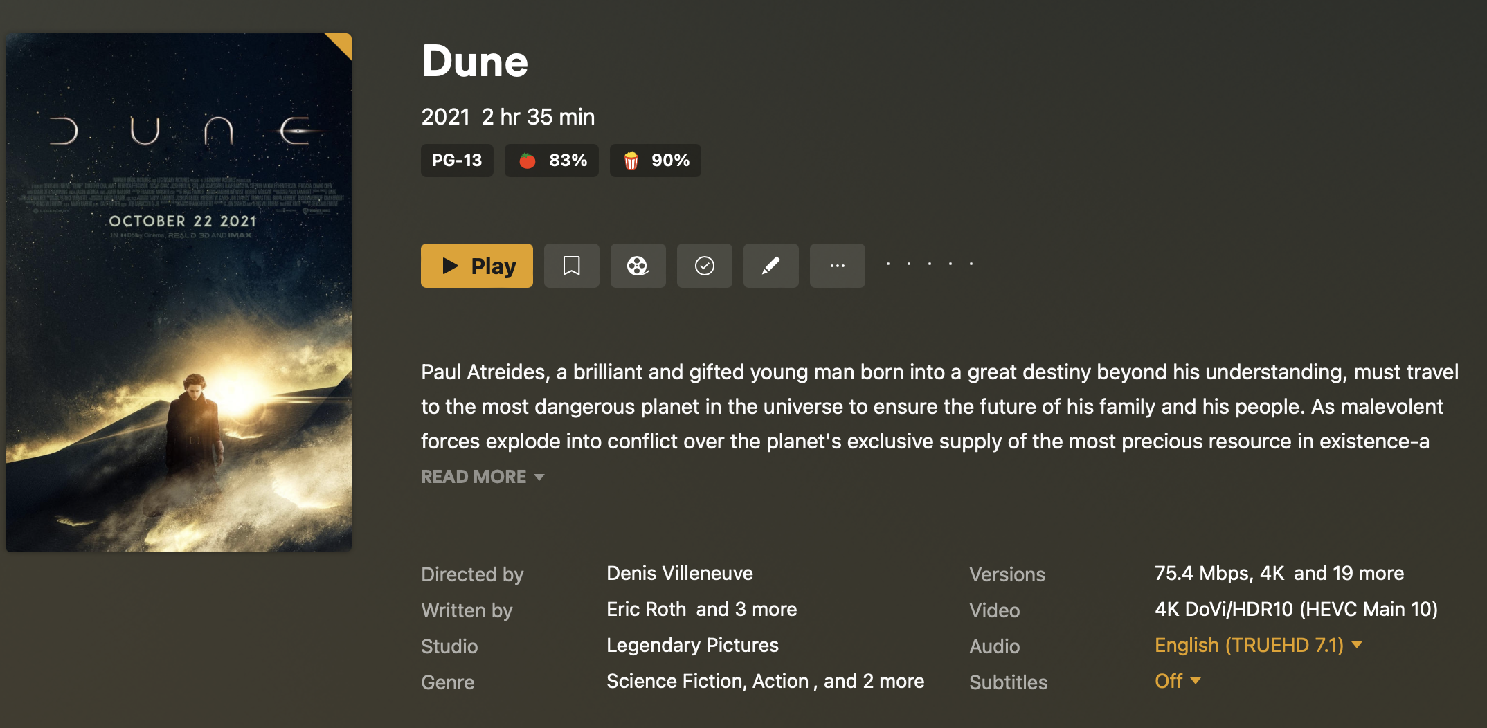

ChromePlanet
Joined: Sat Dec 03, 2022 11:24 pm
Post by ChromePlanet »
Forgive me if I sound like an idiot, but I thought I was already getting Dolby Vision-encoded MKV files from MakeMKV. They are showing up in my Plex Media Server as having both Dolby Vision and HDR-10. This was ripped from MakeMKV with an LG drive to a TS folder for archiving, then used MakeMKV again to rip the TS folder into MKV files.
Screenshot 2023-01-21 at 7.58.35 AM.png (1.85 MiB) Viewed 40957 times
