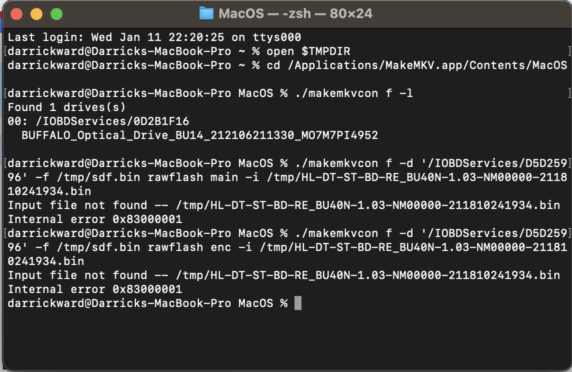

Looking at the Mac/Linux Command instructions
I understand everything except step 4, "copy sdf.bin and the firmware file extracted from theall you need firmware pack into /tmp folder"
Where is /tmp folder and how would I do this? The commands are included for the other steps but not sure I'm fully comprehending how to do this
Posts: 4523
JacobV wrote: Tue Dec 27, 2022 8:44 pm Looking at the Mac/Linux Command instructions
On Mac, Linux, or other Unix based computers, the path separator is '/'. When a / is the first character of a given path, that means start at the root of the filesystem. So, where is /tmp? It is literally at /tmp; a folder called 'tmp' at the root of the filesystem.
However, in the context of the steps to flash a drive on a Mac or Linux machine, '/tmp' just means in a temporary folder somewhere. It doesn't really matter where, just so long as you know where. Then, in step 7, instead of /tmp/sdf.bin, it would be wherever you unzipped it all to.
For example, if you're on a Mac, and you created a folder on your desktop called 'makemkvstuff' and you download sdf.bin into that folder, then the path would be something like:
/Users/<your user name>/Desktop/makemkvstuff/sdf.bin
One of the handy things a Mac can do is if you find a file in Finder and you'd like the full path of it in Terminal, drag the file from finder into Terminal, and the full path of that file will show up on the Terminal command line.
https://support.apple.com/guide/termina ... rml106/mac
