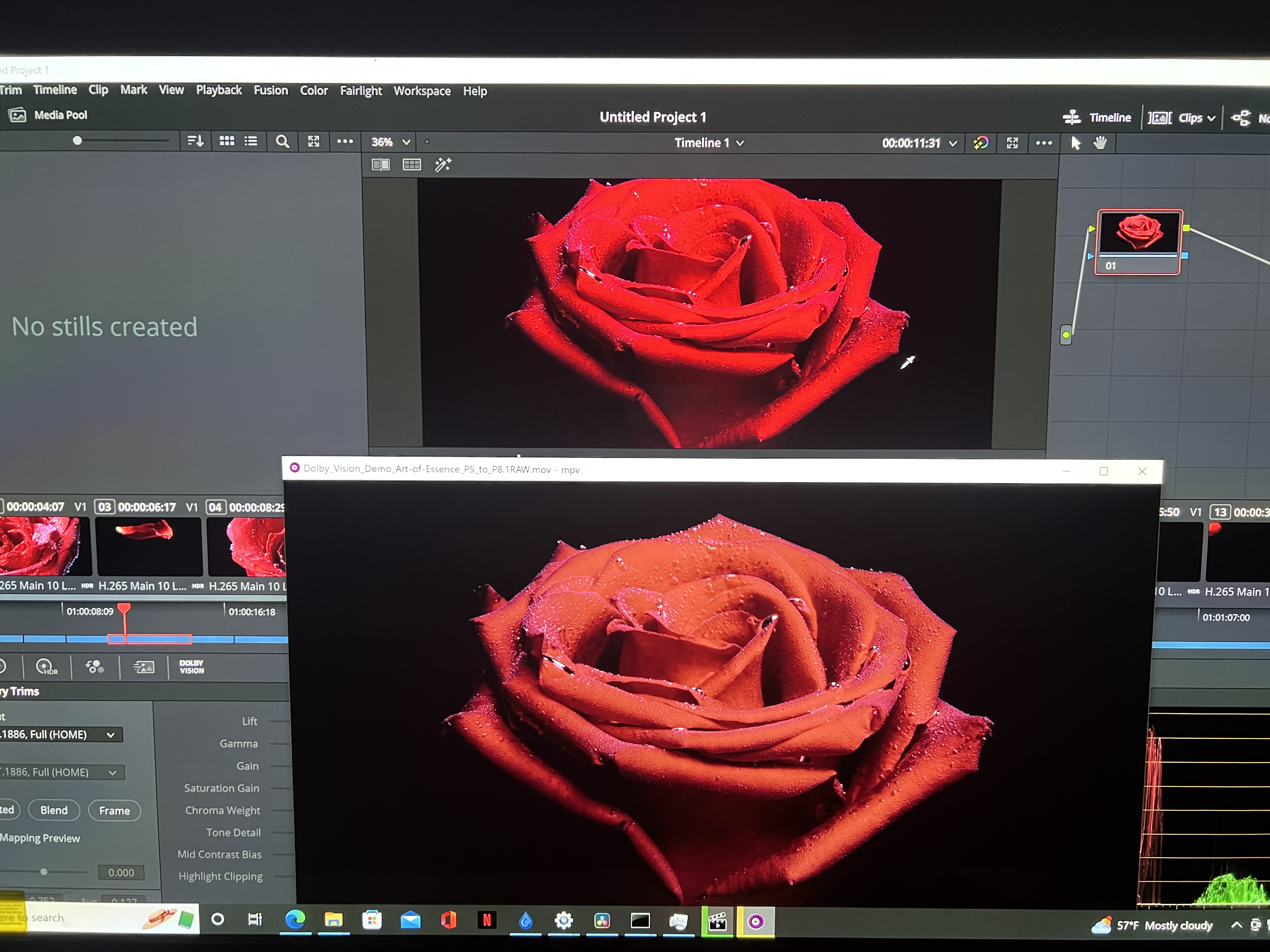

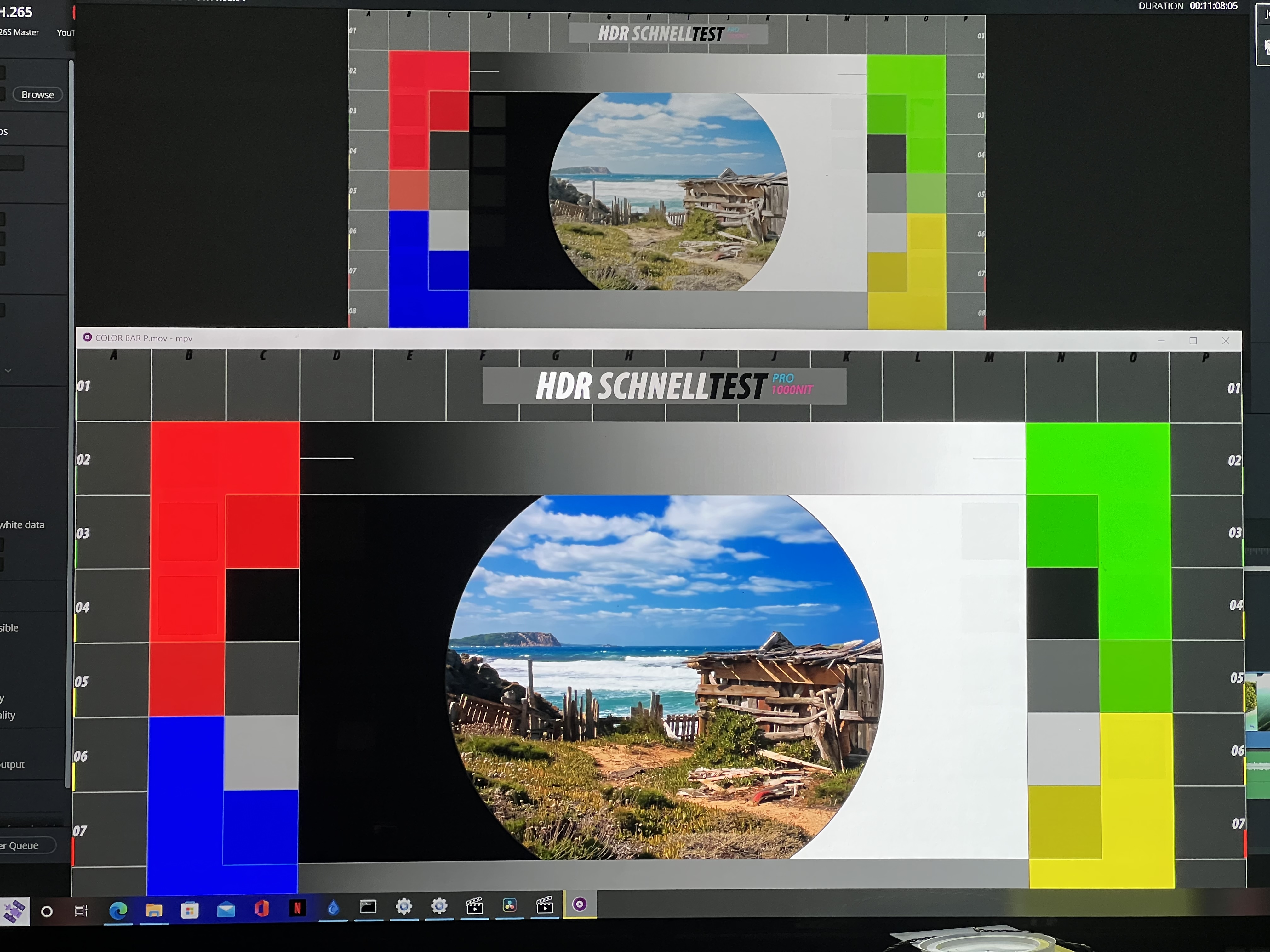

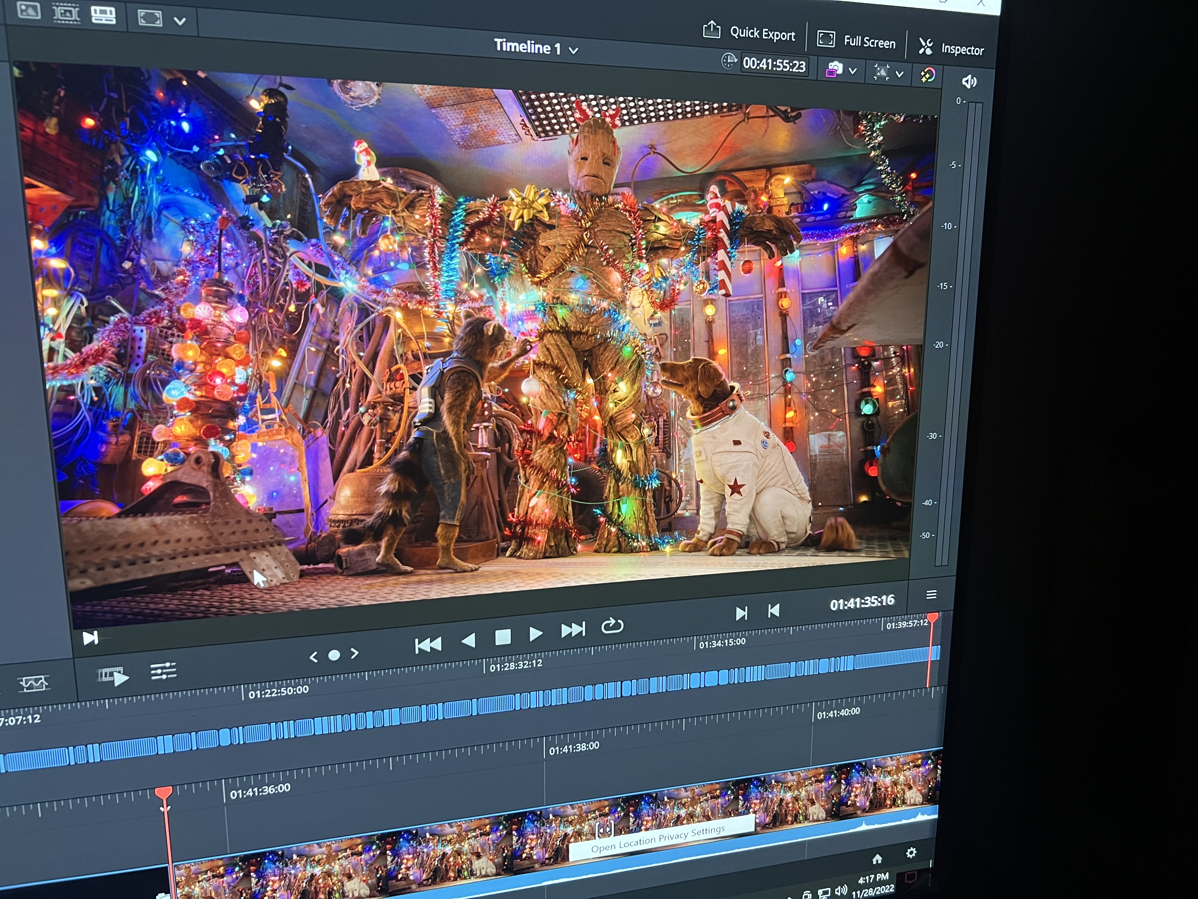

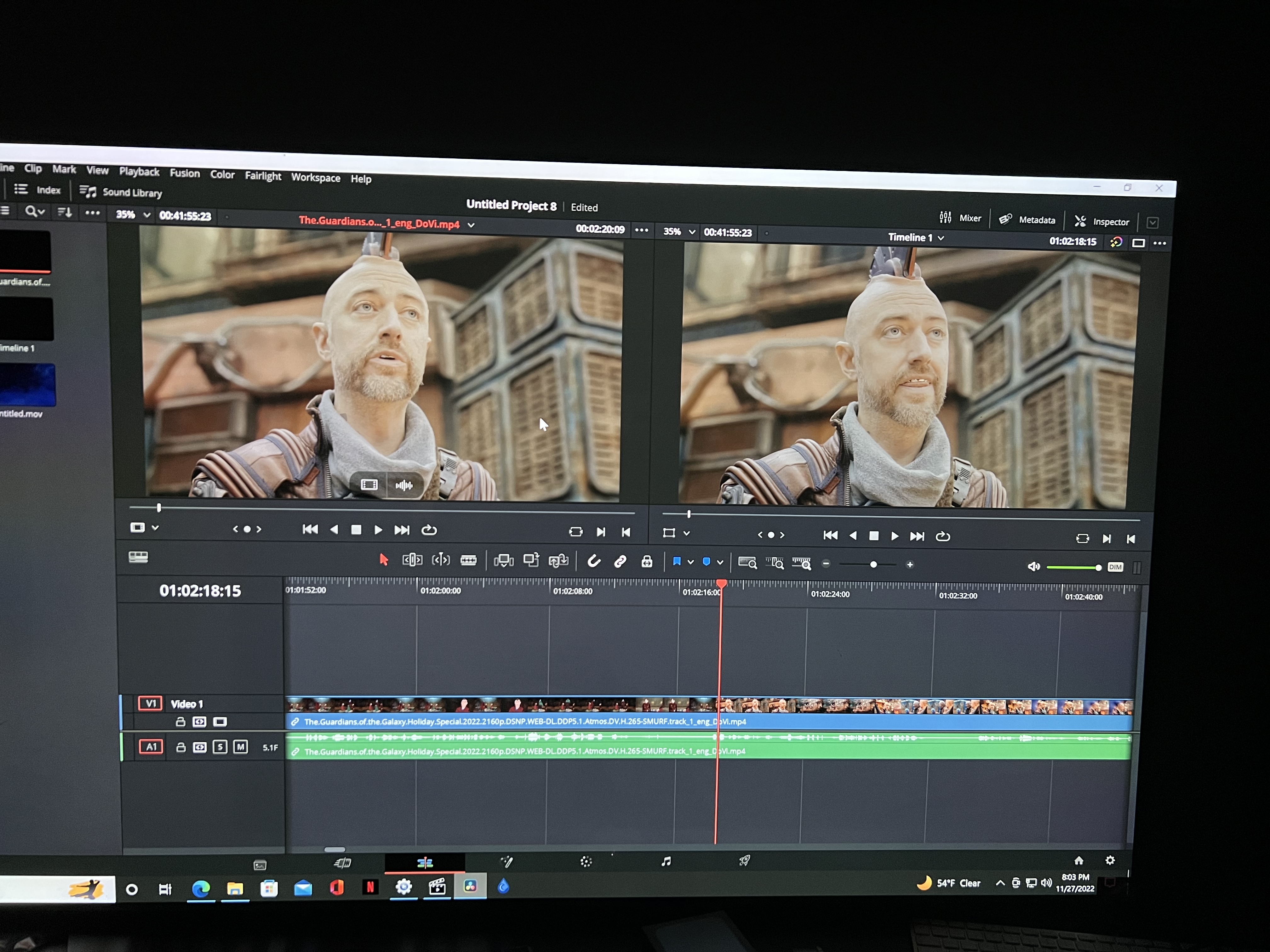

Post by Manixx2020beyound » Sun Dec 11, 2022 9:19 pm
Dv web dl’s movies in resolve.
Testing all export options to see which 1 produces the best or identical reproduction, same file size as well, even tested hevc 444 main 10 which no device can decode yet, but plays well on the pc,
Guardians of the galaxy holiday special (kbacon) dv/WB/dl
Here is a small test sample of the conversion.
Mdl on the encode is incorrect on purpose.
There are a few things i see in some of the results
I’m getting, both negative & positive feedback is welcomed.
Color range from Full to Limited plus yuv is tricky
I’ve seen banding in some scenes on 10bit yuv on some of the tests. No banding on raw exports samples. EDIT: banding solved.
In my opinion results are promising and looks better than the hdr10 version my sample is 4000nits colors are on point with the exception of the brightness shift,rpu is original p5 to p8.1 Looks more like a natural p5.
https://drive.google.com/file/d/1WlHhYU ... p=drivesdk
