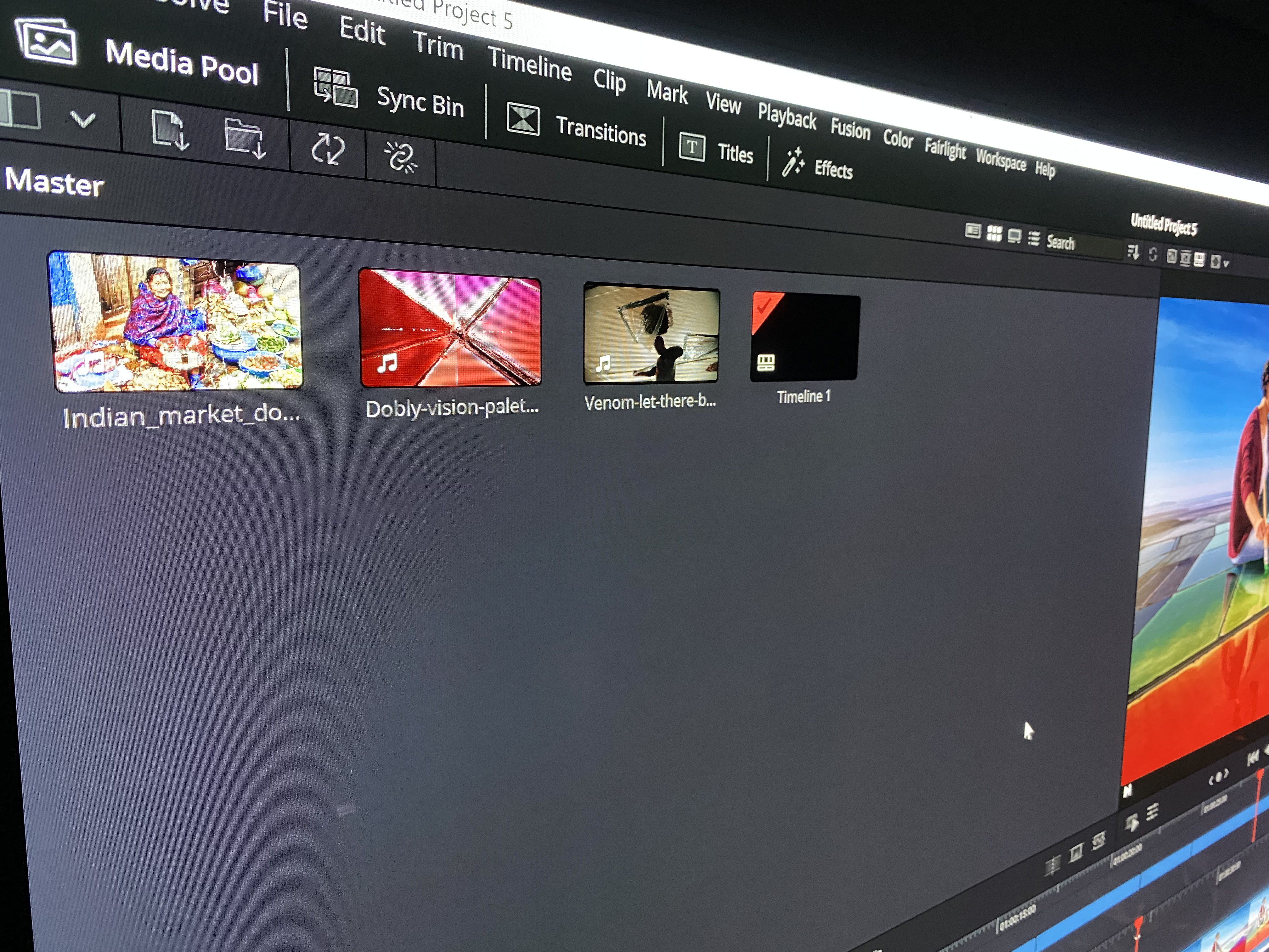

#7786 Post by Manixx2020beyound » Fri Nov 25, 2022 7:56 pm
Gatorman wrote: Fri Nov 25, 2022 7:52 pm
Manixx2020beyound wrote: Fri Nov 25, 2022 7:05 pm Are u using a Mac ?
If so did u try Glass blowing??
It should happen automatically but it does not for 99% of the demos & p5 web dl I tested at 1st.
But they do now.
I did not update my mac yet just been testing on windows but I am curious about the mac as well.
I'm running Windows.
Do U have the p5 encoding options are u using one of those new laptops?
encoding options & decoding options are both enabled at the same time.
If u have like the picture then it’s enabled

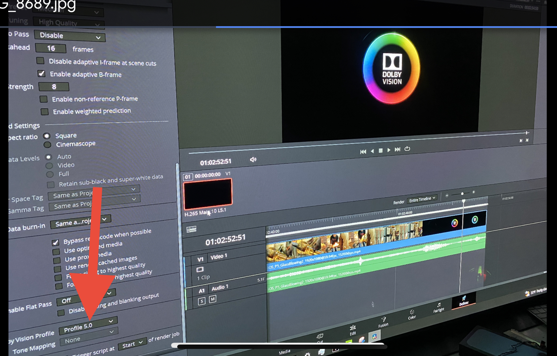

Manixx2020beyound wrote: Fri Nov 25, 2022 7:56 pm Do U have the p5 encoding options are u using one of those new laptops?
Running ZEN+ with Nvidia desktop. I do not have those settings. I guess a Dolby Vision License is needed?
#7788 Post by Manixx2020beyound » Fri Nov 25, 2022 8:29 pm
Gatorman wrote: Fri Nov 25, 2022 8:20 pm
Manixx2020beyound wrote: Fri Nov 25, 2022 7:56 pm 5DE4528D-D47B-4645-81B1-25344E128D1A.jpeg
Running ZEN+ with Nvidia desktop. I do not have those settings. I guess a Dolby vision license is needed?
For windows yes. Or a hack I found which allows resolve to think it’s connected to a doblyvision monitor, that was discussed here a while back.
