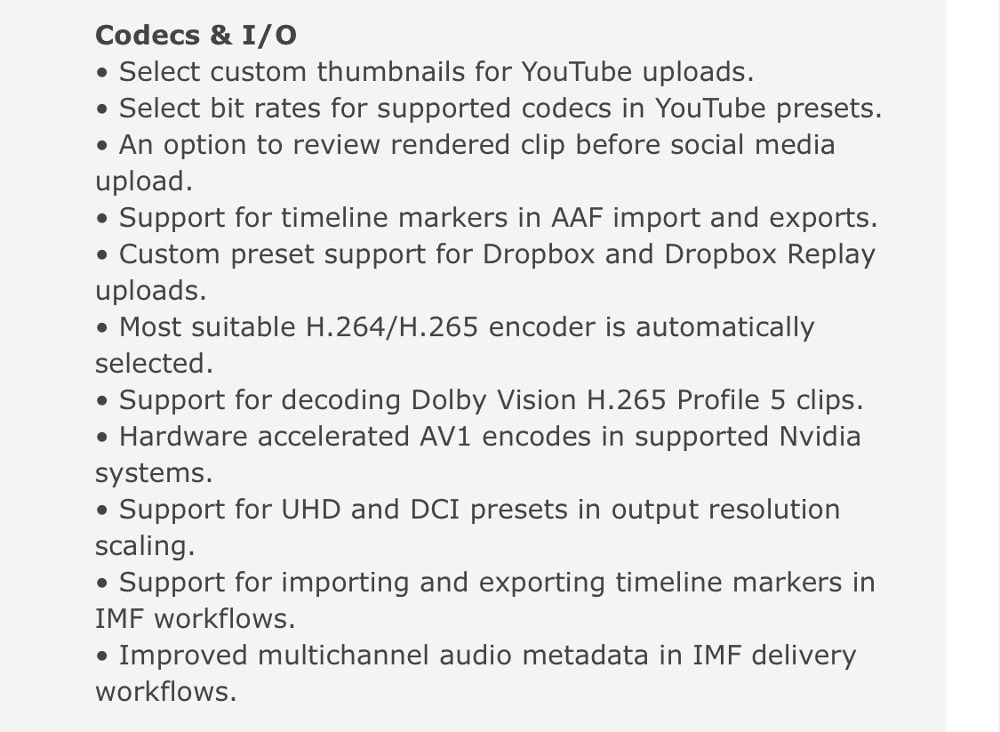

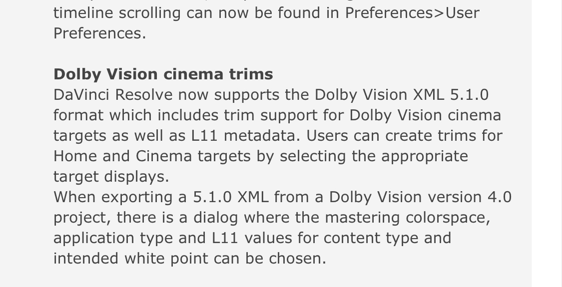

Post by Manixx2020beyound » Mon Nov 14, 2022 1:13 pm
For those using resolve 18.1 update can now decode profile 5 clips on the time line.
https://professionalsupport.dolby.com/s ... ntent_type
L11 metadata specs
