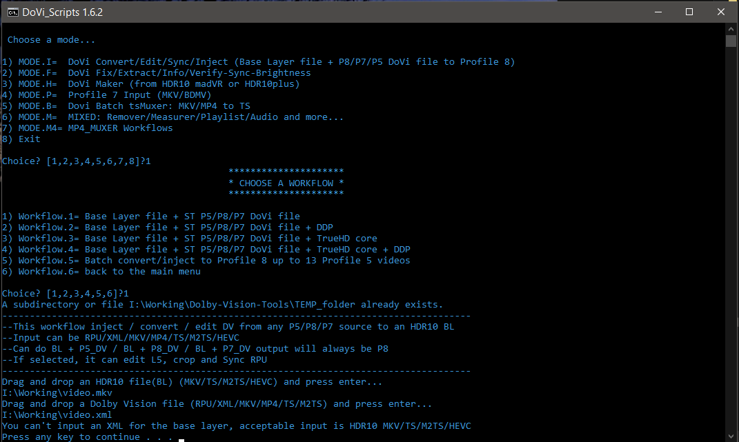

Got it! Thanks for your help.

@Reset_9999
Would it be possible to have a video.mkv.measurements file as an input file?
Post by RESET_9999 » Sat Oct 22, 2022 6:58 pm
6-2-2 can do that.

RESET_9999 wrote: Sat Oct 22, 2022 6:58 pm 6-2-2 can do that.
This workflow allows an already generated .measurements file? It's asking me for a video file. I'll have to get back to my workstation to get the error.
Post by RESET_9999 » Sat Oct 22, 2022 8:21 pm
ha yes, I introduced a bug for that in the latest versions. you can try the older versions as 1.5.8, and it should work.
will fix next time

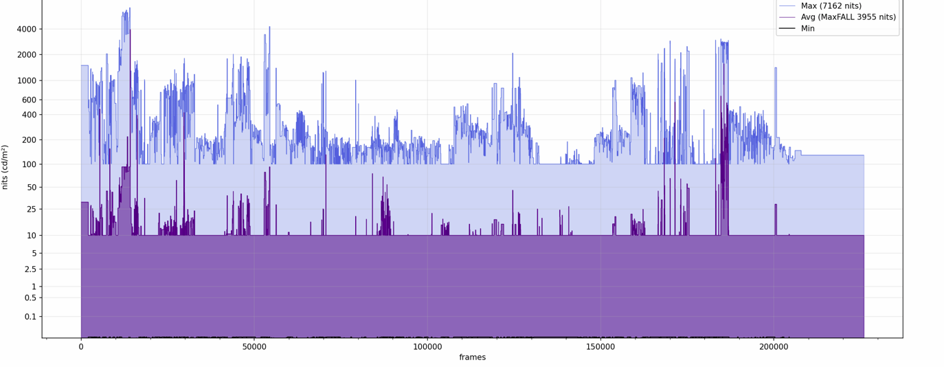

Does this comparison look typical? HDR10 Resolve generated DV.
https://slow.pics/c/fVBUu802
Post by RESET_9999 » Sun Oct 23, 2022 2:53 pm
yes, as you can see madvr min_pq is always 0 which makes avg_PQ inaccurate.
Resolve's scene cut detection is also substantially better than madvr. With madVR, there will be (sometimes) one shot very bright and the next one(within the same scene) darker. I never had this issue with Resolve.
