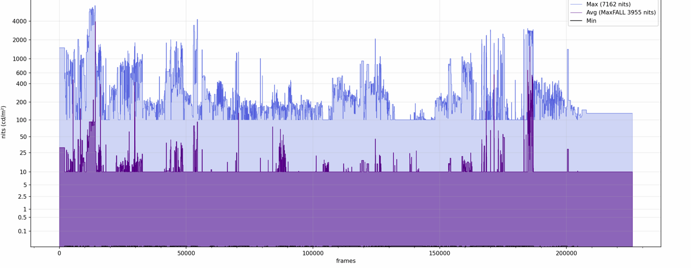

RESET_9999 wrote: Thu Oct 20, 2022 10:15 pm
Gatorman wrote: Thu Oct 20, 2022 10:06 pm All of my recent DaVinci Resolve generated RPUs have a min_pq value of 0. This includes variable aspect ratio files as well as cropped files. Am I doing something wrong?
Did you plot L1 ? because if you just look at a random frame with the dovi_tool it can be hard to find one.
If you did your blanking(or timeline resolution) correctly it should not be always 0
I can see the values changing within Resolve. :D

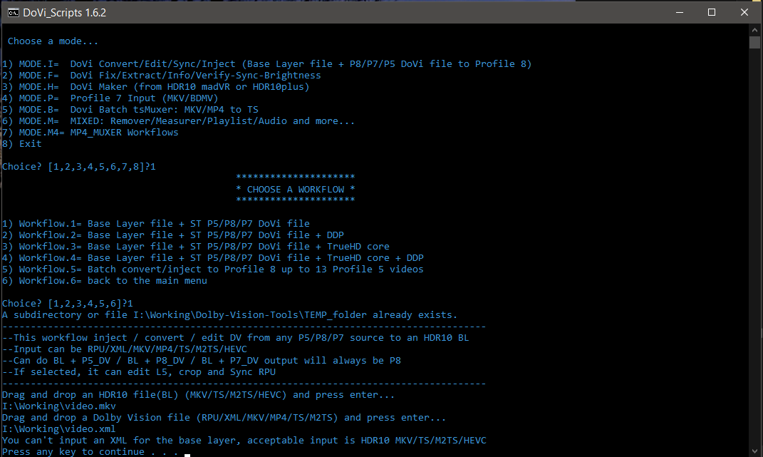

Gatorman wrote: Fri Oct 21, 2022 11:08 pm I'm still working on getting the script to run correctly.
yes, it's not easy to install, I struggled myself.
you have to install python and a couple of modules.
https://www.python.org/downloads/
you can install a module(ijson in that case) by typing this in a cmd window
pip install ijson
Gatorman
Posts: 84
Post by Gatorman »
RESET_9999 wrote: Sat Oct 22, 2022 6:29 pm
pip install ijson
Got it! Thanks for your help.

@Reset_9999
Would it be possible to have a video.mkv.measurements file as an input file?
6-2-2 can do that.
Gatorman
Posts: 84
Post by Gatorman »
RESET_9999 wrote: Sat Oct 22, 2022 6:58 pm 6-2-2 can do that.
This workflow allows an already generated .measurements file? It's asking me for a video file. I'll have to get back to my workstation to get the error.
ha yes, I introduced a bug for that in the latest versions. you can try the older versions as 1.5.8, and it should work.
will fix next time

Does this comparison look typical? HDR10 Resolve generated DV.
https://slow.pics/c/fVBUu802
yes, as you can see madvr min_pq is always 0 which makes avg_PQ inaccurate.
Resolve's scene cut detection is also substantially better than madvr. With madVR, there will be (sometimes) one shot very bright and the next one(within the same scene) darker. I never had this issue with Resolve.
