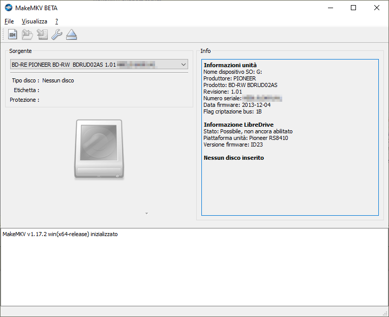

AlamosIT
Joined: Sun Oct 16, 2022 5:58 pm
Post by AlamosIT » Sun Oct 16, 2022 6:10 pm
Hello! I use LibreDrive and MKV with my Hitachi-LG BH16NS55 on my desktop PC and it works like a charm (thank you!).
I've noticed only now that also the BD drive on my old laptop could have LibreDrive as well. How can I make it work?
(I know that this drive will never be able to read UHD Blu-Ray)
Pioneer LibreDrive.png (31.88 KiB) Viewed 24539 times
Blackened2687
Posts: 42
Joined: Fri Jan 25, 2019 5:21 pm
Post by Blackened2687 » Sun Oct 16, 2022 9:38 pm
AlamosIT wrote: Sun Oct 16, 2022 6:10 pm Hello! I use LibreDrive and MKV with my Hitachi-LG BH16NS55 on my desktop PC and it works like a charm (thank you!).
In order for it to work it will be necessary for Mike to add your drive to the LibreDrive database.
By the way, there is a WIP project for crossflashing non-UHD to so-called "UHD-friendly" drives, and your drive's hardware should be capable to work with BDR-UD04 firmware. I will need a memory dump from your drive to add its support, please check your PM for further instructions. Thanks in advance!
