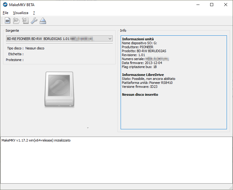

Hello! I use LibreDrive and MKV with my Hitachi-LG BH16NS55 on my desktop PC and it works like a charm (thank you!).
I've noticed only now that also the BD drive on my old laptop could have LibreDrive as well. How can I make it work?
(I know that this drive will never be able to read UHD Blu-Ray)
Blackened2687
- Posts: 42
- Joined: Fri Jan 25, 2019 5:21 pm
In order for it to work it will be necessary for Mike to add your drive to the LibreDrive database.AlamosIT wrote: Sun Oct 16, 2022 6:10 pm Hello! I use LibreDrive and MKV with my Hitachi-LG BH16NS55 on my desktop PC and it works like a charm (thank you!).
By the way, there is a WIP project for crossflashing non-UHD to so-called "UHD-friendly" drives, and your drive's hardware should be capable to work with BDR-UD04 firmware. I will need a memory dump from your drive to add its support, please check your PM for further instructions. Thanks in advance!
