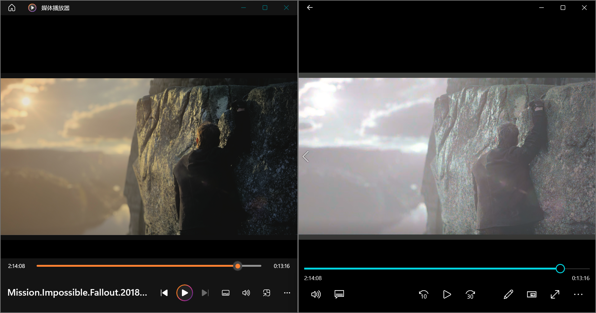

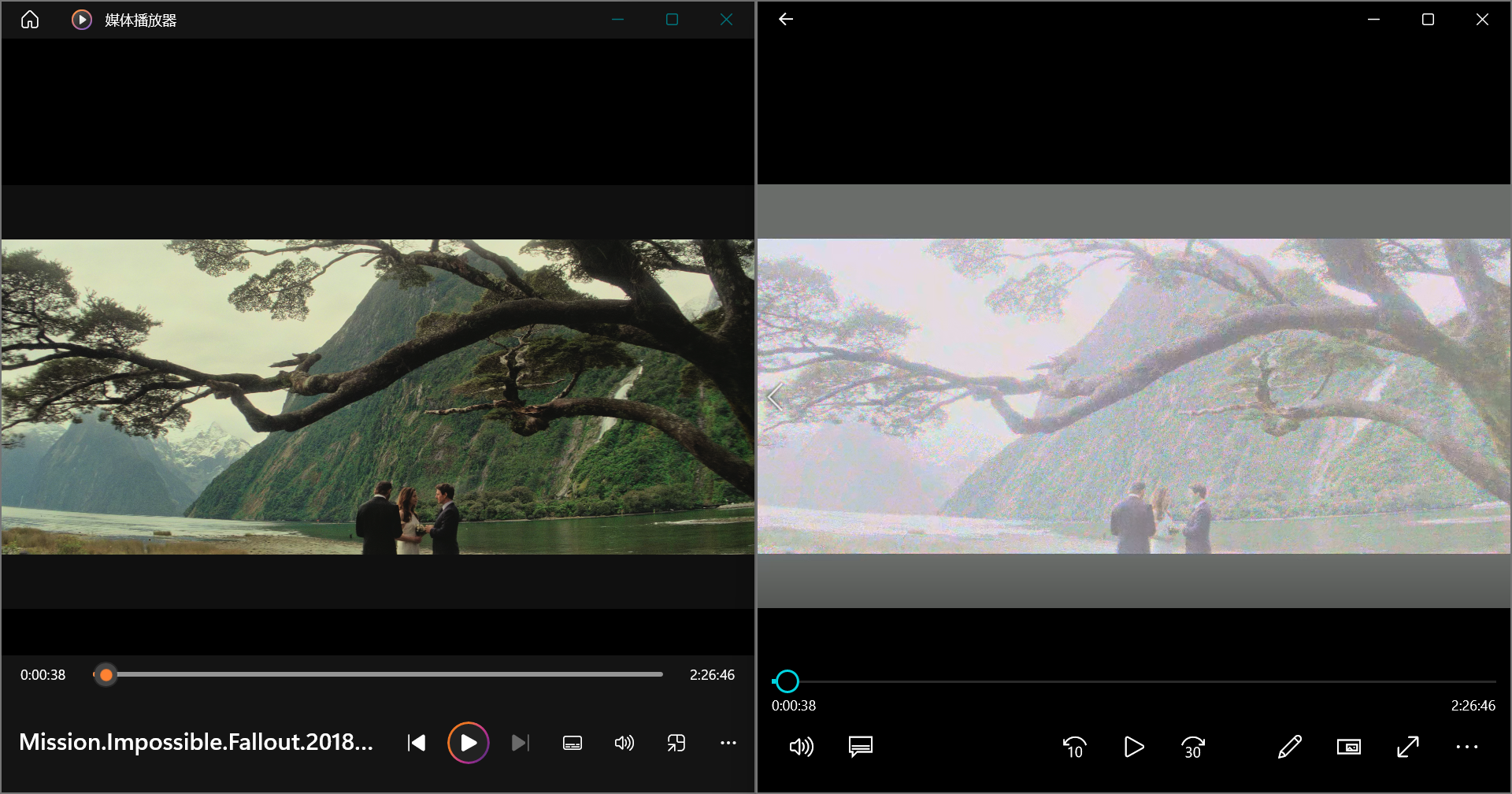

Manixx2020beyound wrote: Wed Oct 05, 2022 5:35 pm Got an off topic question for u guys,(should know this but never really checked myself)
If a fel is present in an imax enhanced disc
Does a 1080p fel adjust aspect ratio to reflect the bl, im not in front a pc but more than likely it does.
The only two movies im aware of that are IMAX and FEL are Mission.Impossible.Fallout.2018 and Aquaman.2018.
I have checked Fallout and the EL changes its aspect as BL.
left=BL, right=EL

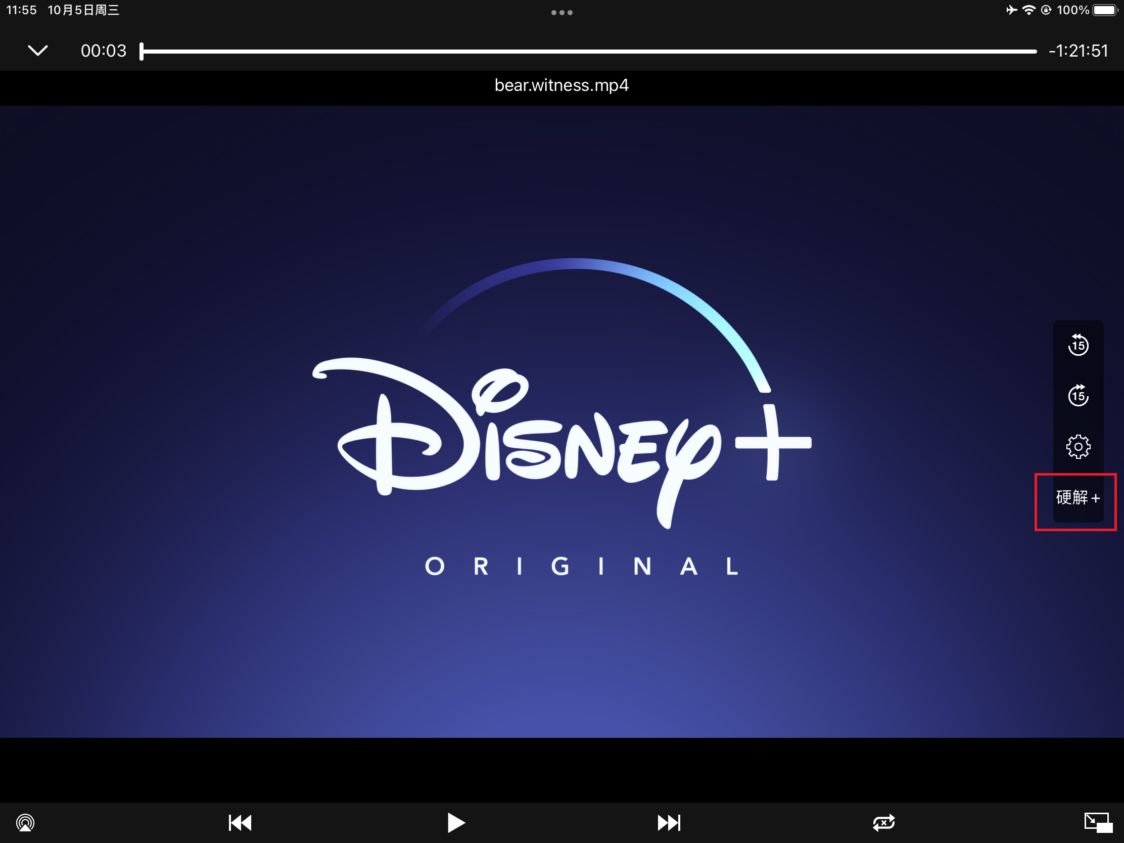

RESET_9999 wrote: Fri Oct 07, 2022 4:24 pm Someone should tell the mp4box devs that it cannot mux coreless 7.1 EC3 track properly. The audio stutter and it's probably exactly the same problem tsMuxer had before the latest version.
The coreless 7.1 atmos muxed by mp4box 2.1-DEV-rev351-gc99924ff-master seems to work in Movies & TV, I can't get it to work on my iPad, probably because of the 1664kbps high bit rate, lower bit rate 7.1 ec3 seems also fine. But currently i don't really have proper 7.1 playback device around.
