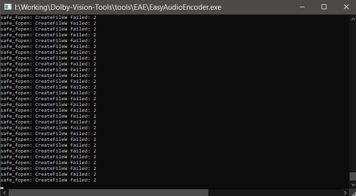

Is this normal when using EAE?
Screenshot (711).png (36.24 KiB) Viewed 12706 times
More reasons to collect physical media. Ugoos AM6B+.
Posts: 2392
Post by RESET_9999 » Fri Sep 30, 2022 9:06 pm
yes, I don't know why...
