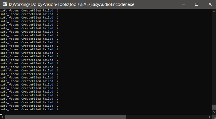

Is this normal when using EAE?
Screenshot (711).png (36.24 KiB) Viewed 12675 times

Posts: 2392
#7533 Post by RESET_9999 » Fri Sep 30, 2022 9:06 pm
yes, I don't know why...
The EC3 file seems ok, I watched 1 or 2 movies and had no issues.
