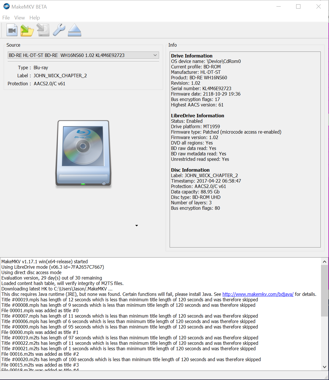

This is my first time doing this so please forgive me if my question is a stupid one. I bought the LG WH16NS60 and was able to successfully flash it down...downgrade the firmware to 1.02 or so I believe I did. MakeMKV does show the firmware 1.02.but it still says the type is blu-ray instead of 4K. When it's done properly will it say 4K next to type or will it say blu-ray? I used the SDFtool Flasher (v1.34) in case that makes a difference. I even tried seeing if DVDFab would show 4K, but it keeps prompting "Failure opening the disc due to unfriendly firmware installed on drive". It did it before the flash and it's doing after. I have attached a screenshot in case that helps.
- Posts: 6012
the flash is for makemkmv you need de firmware for other rippers look at the disk type it says uhd so its working properlyMrAshyElbows wrote: Sun Sep 18, 2022 1:33 am Hello all,
This is my first time doing this so please forgive me if my question is a stupid one. I bought the LG WH16NS60 and was able to successfully flash it down...downgrade the firmware to 1.02 or so I believe I did. MakeMKV does show the firmware 1.02.but it still says the type is blu-ray instead of 4K. When it's done properly will it say 4K next to type or will it say blu-ray? I used the SDFtool Flasher (v1.34) in case that makes a difference. I even tried seeing if DVDFab would show 4K, but it keeps prompting "Failure opening the disc due to unfriendly firmware installed on drive". It did it before the flash and it's doing after. I have attached a screenshot in case that helps.2022-09-17 18_31_36-Settings.png
