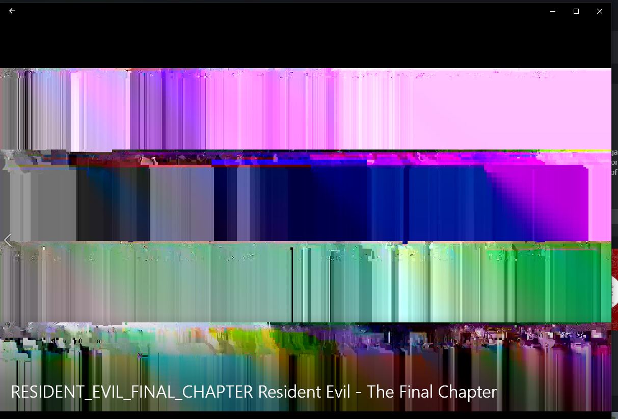

I delayed on updating makemkv from 1.15 to 1.16 for a little bit because I honestly didn't even realize there was an update. That being said, it the only thing different that I have changed when ripping my media. Recently I tried to rip my Resident Evil Blu-ray collection (new in box) and everything ripped to the hard disk just fine. No errors or anything. However, when i went to play them back they would start to play just fine then occasionally flash a screen (sound still playing) like a kid trying to watch the nudie channel on tv back in the 90's when it was just scrambled. (See attachment). On the flip side I tried another program I had (VideSolo) and ripped Lossless and it did the same thing. But if I rip it using compression (Hq1080p) the playback is just fine no scramble. Am I missing something? Its only doing this with Blu-ray's. thanks ahead of time.
- Randomly while playing back
- playback error.JPG (126.77 KiB) Viewed 34357 times
Re: Random Scramble in Blu Ray Playback
Play back in what?
The picture is typical of an overwhelmed video decoder - too many bits received compared to the ability to render them. If they always happened at the SAME point (usually a scene change), that would probably be the case.
But it can also happen when the decoder isn't getting the bits fast enough, due to transport issues. Those can be random, depending on the network or bus load.
In either case, processing to reduce the bit rate helps, but it doesn't solve the base problem.

typically, it's happening on all playback devices... Right now, I am just using my main rig to test everything after ripping them. little old but it should be more than enough to handle it. 4790k, 16gb ddr3 2400, 1080gtx. (Upgrading right now just isn't very feasible)Woodstock wrote: Fri Dec 17, 2021 6:13 pm Play back in what?
That being said then, I'm assuming what you're saying is that my 1080 GTX is overwhelmed? I mean I haven't had a problem with it up until now... But what you're saying is true cause I have pinpointed the seen to get that screen shot lol. 5:17

That rig should be able to play 1080p video without issue, assuming the data gets to the decoder. Your driver should be using the hardware H.264 decoder on the board, but even software decoding should keep up.
Defects in the files themselves should show up on ALL playback programs/devices at the same place. It's the random ones that are a pain to track down. Like having two network cables fail and turn a gigabit connection to the file server into a 10Mbit half-duplex connection when the cable is flexed.

Woodstock wrote: Sat Dec 18, 2021 12:46 am That rig should be able to play 1080p video without issue, assuming the data gets to the decoder. Your driver should be using the hardware H.264 decoder on the board, but even software decoding should keep up.
Drivers up to date, using h.264 etc. But yeah, defects show in ALL playback devices. Tried VLC, plex server, Window default, pot player, etc. Always the same seen. But like i said it's just Blu-ray and that's what's got me. I really had no issues till I updated to 1.16. But that's a moot point cause as i previous stated using other decoders I get the same issue. Only 2 things i can think would be possibly my Drive is dying on the Blu-ray side or something internal to my computer.
