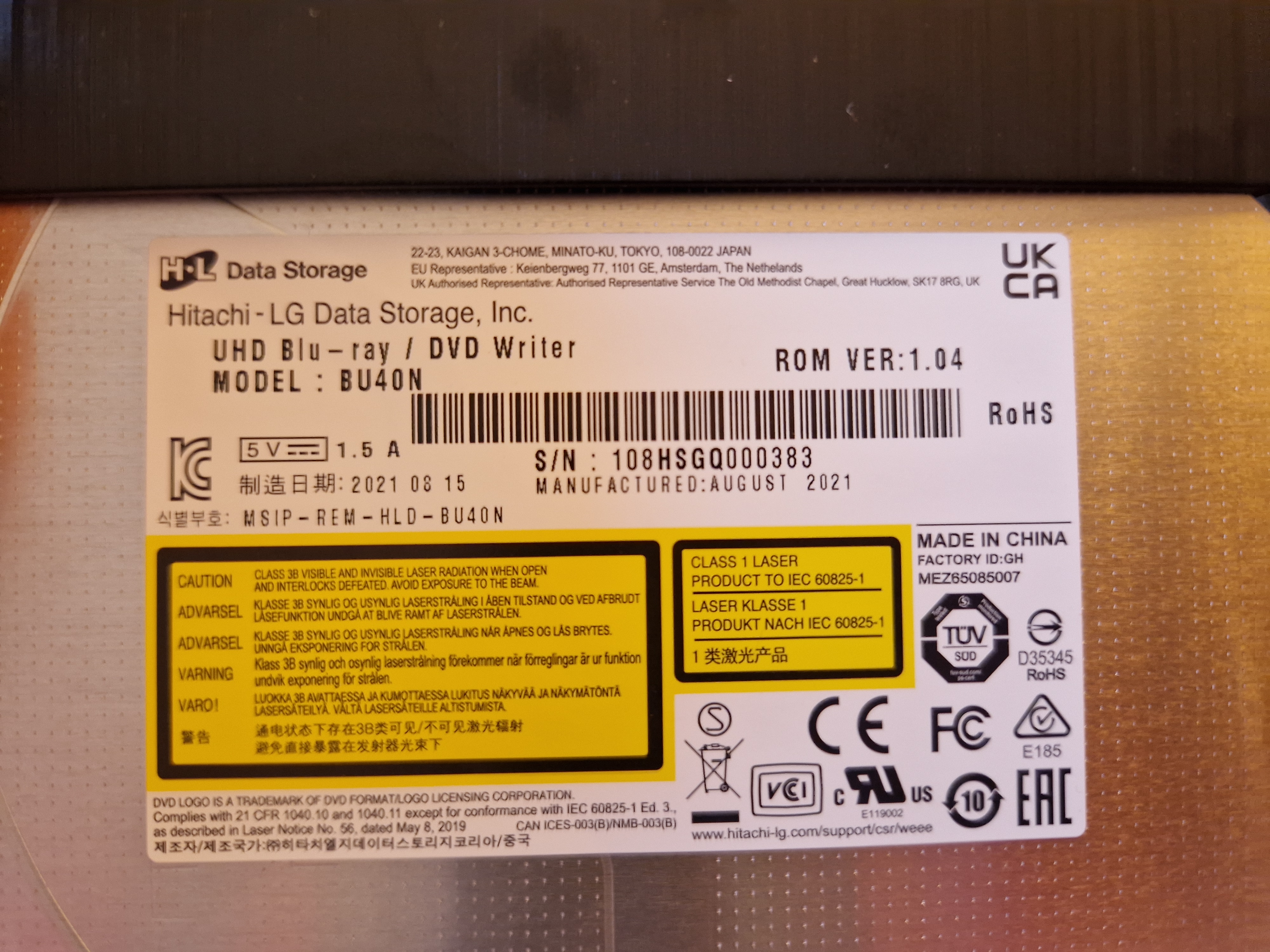

The BU40N is an official UHD drive so does not have the sleep bug at all.Torcain wrote: Sun Aug 28, 2022 4:59 pmThanks for the advice. Can the BU40n be flashed to a firmware version without the sleep bug? And if so, is it actually a version you'd recommend or is it just better to keep the bug in mind and make sure I start the rip within 2 minutes of inserting the disc?Billycar11 wrote: Sun Aug 28, 2022 4:43 pmYeah that should work but if it's dead then just exchange or return it personally I recommend a BU40n they sell adapters to fit it in a 5.25 bayTorcain wrote: Sun Aug 28, 2022 4:28 pm
I included that in my response when you asked me the first time time. The sticker says 2019 01 31. Just looked at it again, Manufactured January 2019 is to the right of it.

Hey Marty,MartyMcNuts wrote: Sun Aug 28, 2022 9:42 pmThe BU40N is an official UHD drive so does not have the sleep bug at all.Torcain wrote: Sun Aug 28, 2022 4:59 pmThanks for the advice. Can the BU40n be flashed to a firmware version without the sleep bug? And if so, is it actually a version you'd recommend or is it just better to keep the bug in mind and make sure I start the rip within 2 minutes of inserting the disc?Billycar11 wrote: Sun Aug 28, 2022 4:43 pm
Do the standard troubleshooting steps before returning new sata data/power cable different port different PC different os lot's to go wrong and try ect. But it's probably just a bad one
Do you know if my BP50NB40 SVC:NB52, flashed with BP60NB10 w/1.00 firmware still has the sleep bug? It's labeled as "officialish".
Considering returning it for a BU40N drive if my BP50 has the sleep bug still.
