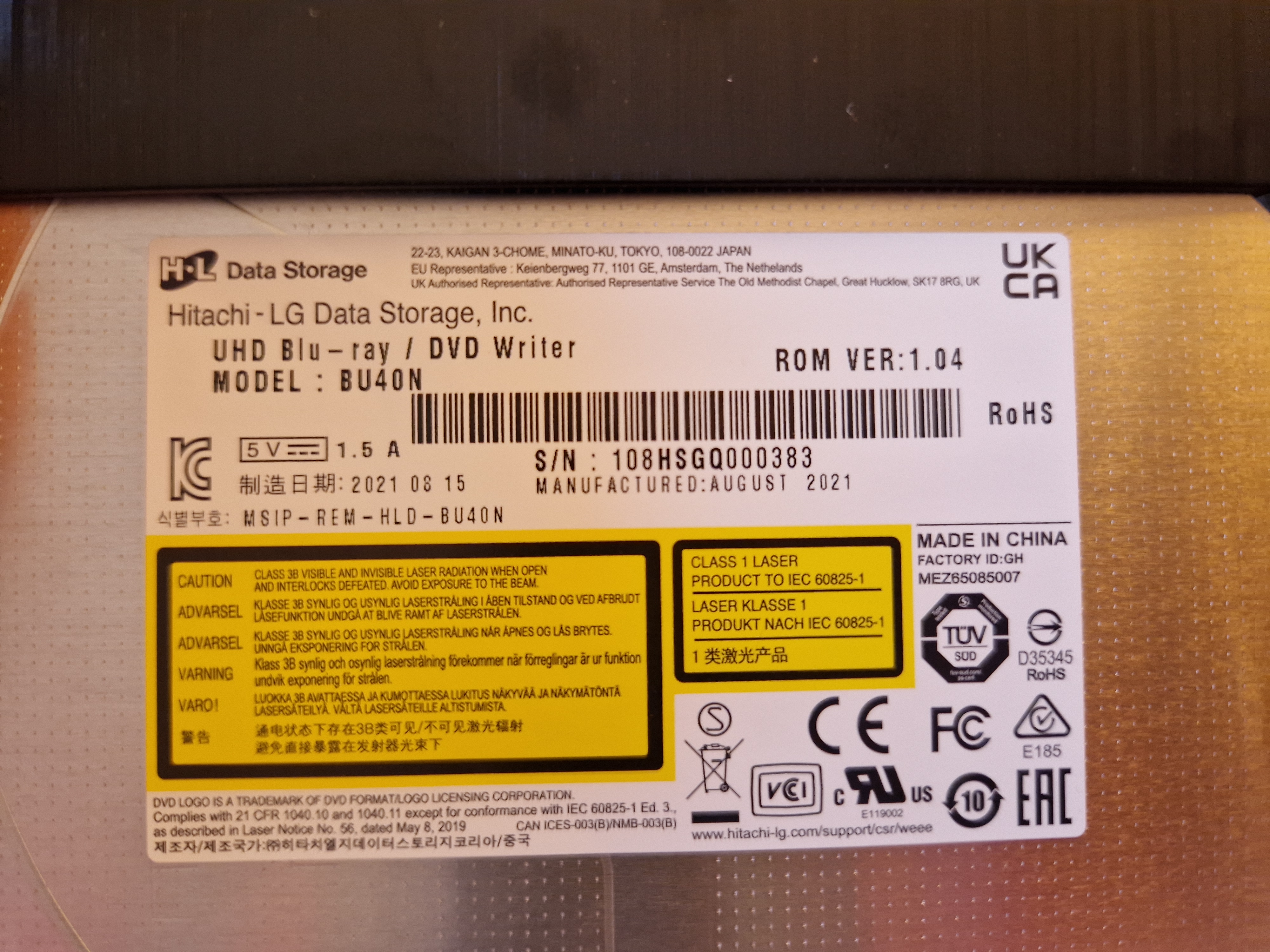

#1317 Post by MadsKvist » Wed Sep 07, 2022 5:51 am
Can someone help me out with this label? I don't see SVC NS50+ LG anywhere, it's it still safe to flash it?
Bu40 label
Bu40 label
