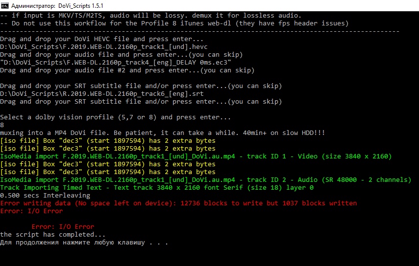

Hi Guys!
Could someone pls tell me what i do wrong when trying to "repack" mkv p8 to mp4 p8 using RESET_9999's DoVi scripts?
I got smth like this
- DoViFailed.jpg (335.58 KiB) Viewed 25371 times

looks like it's trying to convert lossless audio to EAC3 but your file doesnt have lossless audio. I'll have a look.duder wrote: Tue Aug 23, 2022 1:28 pm Hi Guys!
right now you could just demux your file with mkvextract and then use workflow 1 and input HEVC + EAC3 + SRT
thx for a quick response!RESET_9999 wrote: Tue Aug 23, 2022 1:55 pmlooks like it's trying to convert lossless audio to EAC3 but your file doesnt have lossless audio. I'll have a look.duder wrote: Tue Aug 23, 2022 1:28 pm Hi Guys!
i'll will give it a try a little later.
btw when i drop extracted HEVC file into mediainfo it says simple HDR. But after I remuxed it with tsmuxer mediainfo states DoVi.
I was hoping to play it in mp4 with internal TVplayer because the latter is too clumsy with m2ts (troublesome audio track changing and forwarding). And as we know Sony-800m2 in its turn does not give us eac3(

Have tried as recommended. Dropped extracted hevc and used workflow 1.RESET_9999 wrote: Tue Aug 23, 2022 1:55 pmlooks like it's trying to convert lossless audio to EAC3 but your file doesnt have lossless audio. I'll have a look.duder wrote: Tue Aug 23, 2022 1:28 pm Hi Guys!
It says smth about "no space" but demuxed files are 9Gb and i have 18Gb free space left on the HDD.
