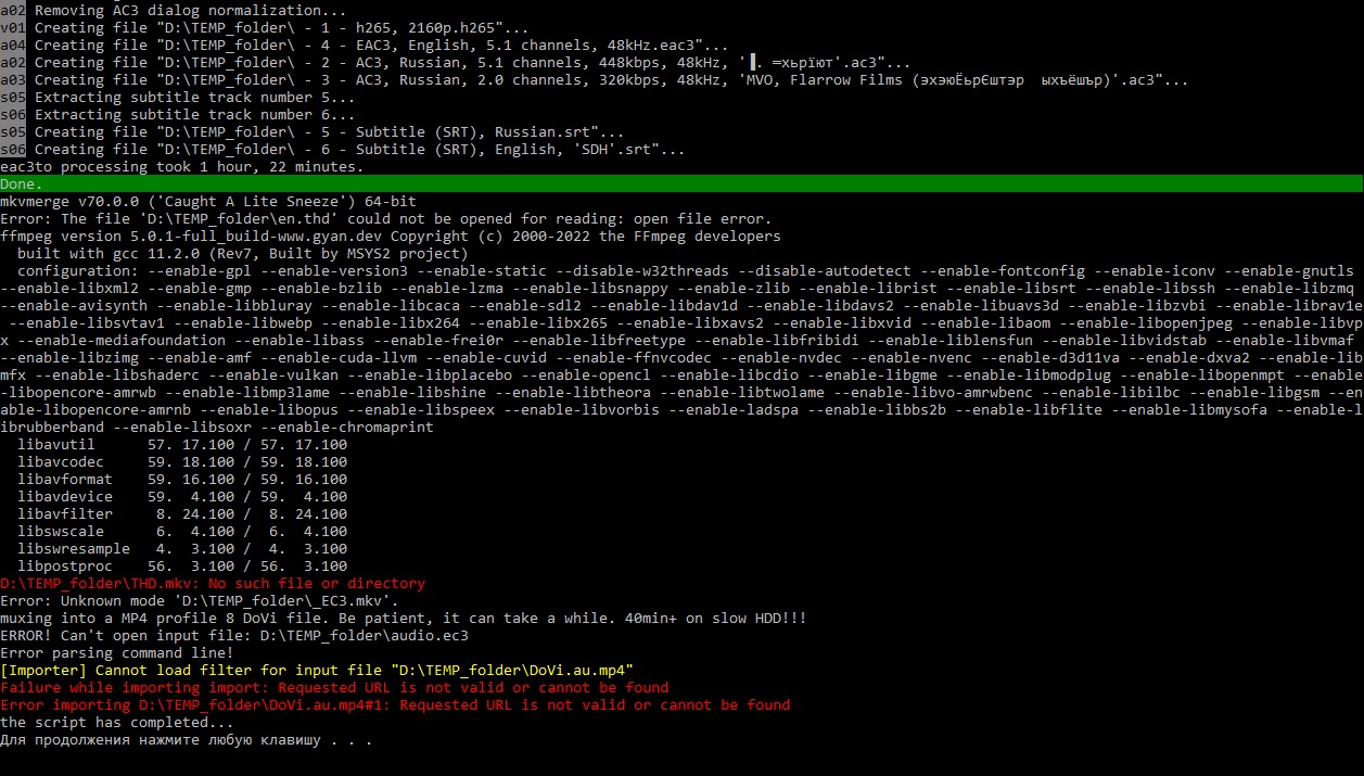

Hi Guys!
Could someone pls tell me what i do wrong when trying to "repack" mkv p8 to mp4 p8 using RESET_9999's DoVi scripts?
I got smth like this
Posts: 2392
duder wrote:
Tue Aug 23, 2022 1:28 pm
Hi Guys!
looks like it's trying to convert lossless audio to EAC3 but your file doesnt have lossless audio. I'll have a look.
right now you could just demux your file with mkvextract and then use workflow 1 and input HEVC + EAC3 + SRT
duder
Joined: Mon Aug 22, 2022 2:46 pm
Post by duder »
RESET_9999 wrote:
Tue Aug 23, 2022 1:55 pm
Hi Guys!
thx for a quick response!
i'll will give it a try a little later.
btw when i drop extracted HEVC file into mediainfo it says simple HDR. But after I remuxed it with tsmuxer mediainfo states DoVi.
I was hoping to play it in mp4 with internal TVplayer because the latter is too clumsy with m2ts (troublesome audio track changing and forwarding). And as we know Sony-800m2 in its turn does not give us eac3(
