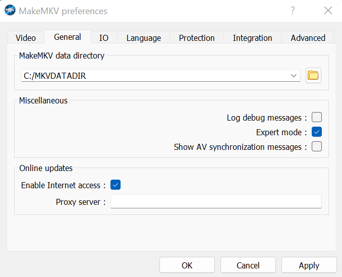

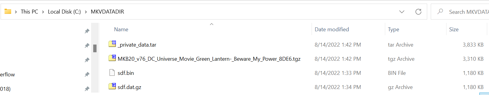

Is there a manual way to emplace the sdf.bin or sdf.dat.gz file _somewhere_ such that MakeMKV will reference it instead of hitting the "download or die" branch?
I've looked around and found various forum posts where Mike has indicated sdf.bin is the file to emplace into the data dir. I've done this and each and every time it's _STILL_ claiming:
MakeMKV v1.17.1 win(x64-release) started
Using LibreDrive mode (v06.3 id=0FA242DD4D0B)
Using direct disc access mode
Downloading latest HK to C:/MKVDATADIR ...
Automatic HK downloading is disabled or failed.
Saved AACS dump file as C:/MKVDATADIR/MKB20_v76_DC_Universe_Movie_Green_Lantern-_Beware_My_Power_8DE6.tgz
Failed to open disc

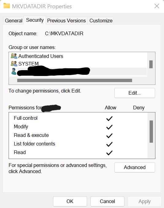

It's not the disk as I had sent that dump to Mike (svq@makemkv.com) per some other forum posts on the 07/26 and there's yet another forum post for this title claiming it works now. But, clearly, not for me. And yes, I do have View -> Preferences -> General -> Online Updates -> Enable Internet access checked. If there is a more specific box that requires checking, please advise as I don't see anything else 'net related in any of the Preferences tabs. Clearly not a 'net connectivity issue since I have curled all of the files w/out issue. As well as ensured the data dir had full access for my local user running MakeMKV.
What is the magical juju incantation required to progress here?
Posts: 6017
Re: Automatic HK download disabled or failed
the c main directory may have higher permissions requirements running as admin may help.
but then again looks like it was able to write the tgz
sdf and hk are different sdf is libre drive hk is the keys to decrypt the movies
try using a vpn isps are annoying they might still be blocking it even with your own dns
