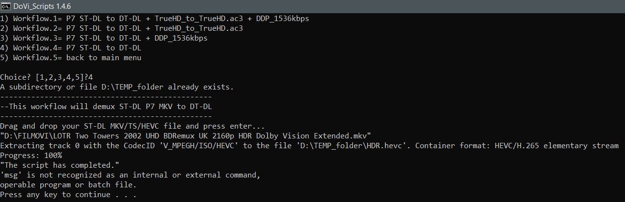

Thanks! I went through the lengthy process but got an error at the end. Any suggestions?
UHD players: Sony X700, Zidoo Z1000 Pro
Audio system: Sony HT-A9
TV: Sony 77A80J

Amused wrote: Fri Jul 29, 2022 7:52 am Thanks! I went through the lengthy process but got an error at the end. Any suggestions?
thats just "the script has completed" popup msg that didnt work. you can ignore that.
