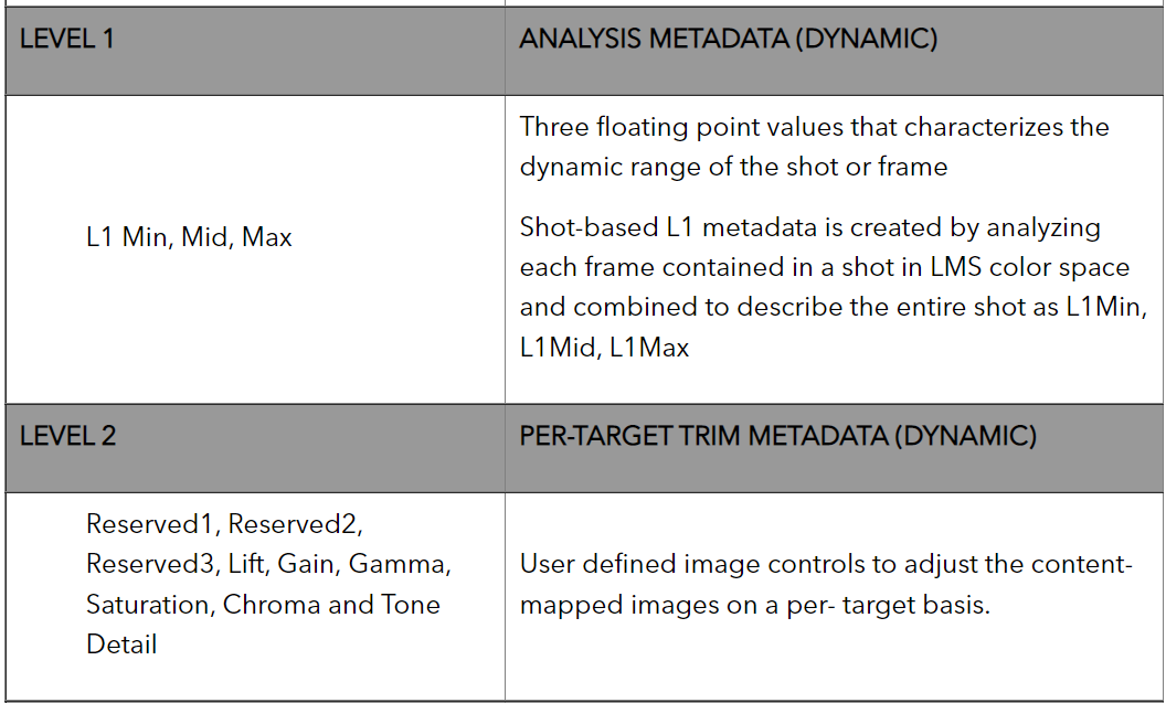

deadchip12 wrote: Fri Jul 22, 2022 12:59 am Could someone explain in layman term how this new L1 bug affects the picture quality?
From https://professionalsupport.dolby.com/s ... uage=en_US
屏幕截图 2022-07-21 221050.png (79.3 KiB) Viewed 20302 times
To my understanding, L1 contains the overall calculated dynamic range of scene.
L2 contains how exactly filmmaker would want the image to be tone mapped when L1 exceeds the limitation of the TV. It's basically like this:
When the range of a scene is 2-200 nit and TV is 0-1000, nothing will be tone mapped and just follow exactly the PQ curve.
When the range of a scene is 0-2000 and RPU has L2 metadata to instruct how image on 600nit TV should be tone mapped, the TV will follow that curve.
When the range of a scene is 0-2000 but no L2 metadata present, it should generate a default tone mapping curve based on the TV brightness and L1 data and follow that.
So if L1 is not used, it will be HDR10 without tone mapping(clipped).
Please correct me if I'm wrong.
I'm sure it can be fixed through update, so relax.

sw5163 wrote: Fri Jul 22, 2022 2:31 am So if L1 is not used, it will be HDR10 without tone mapping(clipped).
pretty much but the L2 still has an effect when present.
But the thing is that a lot of movies only have a 600nits trim( no effect on bright TV) and some others don't have any (rare).
In that case that's basically static DV. Not to mention all the HDR10plus conversions to DV.

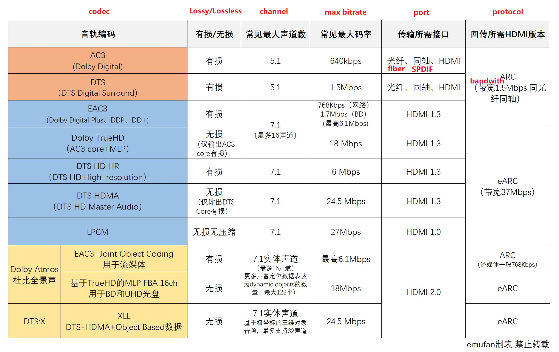

RESET_9999 wrote: Fri Jul 22, 2022 10:56 am DEE does but I'm not able to get 7.1 audio from my C2 internal player to my AVR (might be because my avr is ARC)
ARC should be able to do 7.1 eac3/atmos at best, through HDMI 2.0
7.1 eac3 without atmos through HDMI 1.3
eARC is only needed for TrueHD and PCM
In case anyone want this, it's from https://zhuanlan.zhihu.com/p/106809463. I don't own it.

sw5163 wrote: Fri Jul 22, 2022 11:19 am ARC should be able to do 7.1 eac3/atmos at best, through HDMI 2.0
well 7.1 EC3 without a core doesn't work on my C8/C2 + ARC AVR , so I don't know
7.1 EC3 with a core plays fine but only the 5.1 core.
