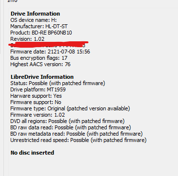

Hello, I got a BP60NB10 and I want to patch it, I downloaded the firmware from the cloud:"HL-DT-ST-BD-RE_BP60NB10-1.02-NM00800-212005070935.bin". But I'm not sure use encrypted firmware commands or use unencrypted firmware one, Thank you
