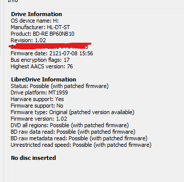

Hello, I got a BP60NB10 and I want to patch it, I downloaded the firmware from the cloud:"HL-DT-ST-BD-RE_BP60NB10-1.02-NM00800-212005070935.bin". But I'm not sure use encrypted firmware commands or use unencrypted firmware one, Thank you

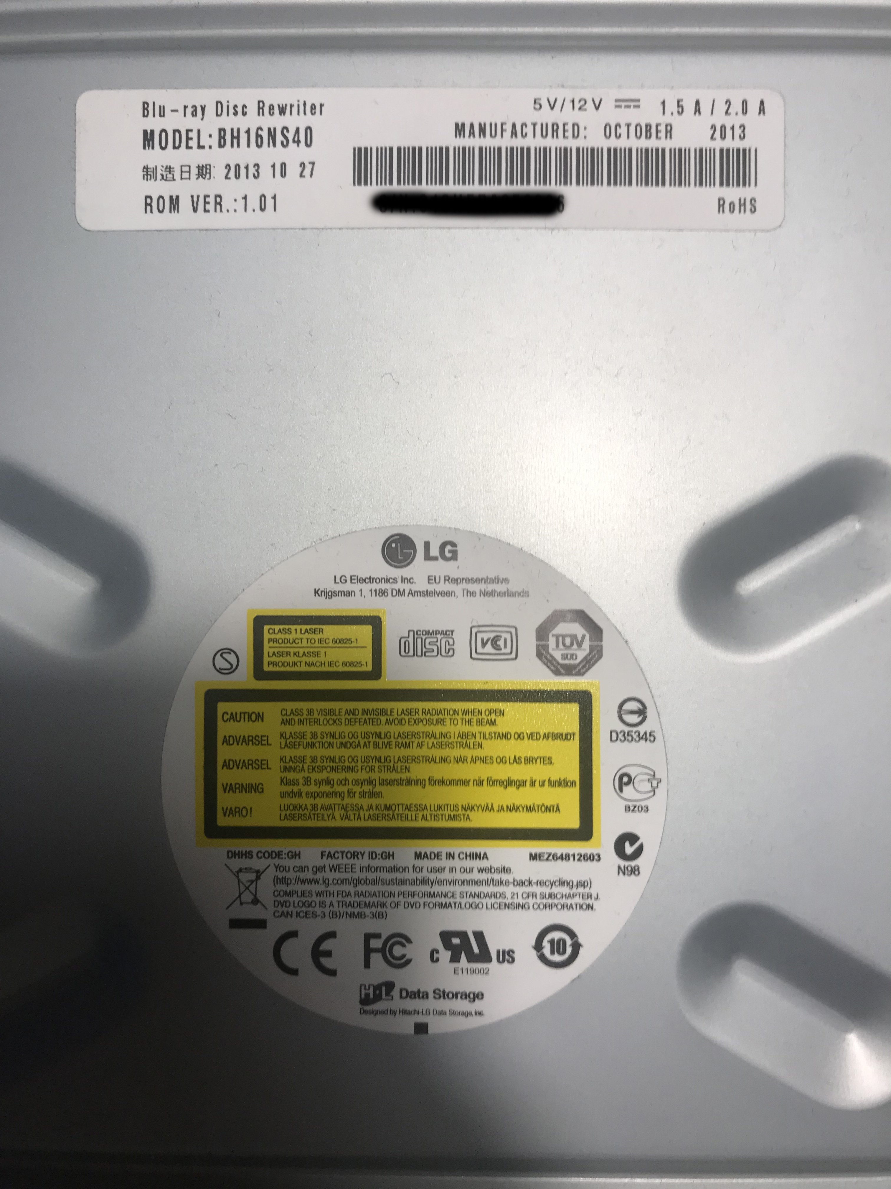

I just bought this hardware second hand, should I upgrade the firmware, if so what version?
Current profile: BD-RE
Product: BD-RE BH16NS40
Revision: 1.01
Firmware date: 2113-04-04 22:50
Drive platform: MT1939
Firmware version: 1.01
BD raw metadata read: Partial
Posts: 1718
Post by d00zah »
jeaveci55 wrote: Thu Jul 21, 2022 2:41 pm Hello, (sorry for my english)
Revision: 1.01
Hardware is (pre-Oct 2015) too old to support UHD & the current FW supports LibreDrive. Best to leave it be.

What are the benefits of flashing the firmware on this drive, and how would I go about doing it (I see several warnings about NB12)?
If you want to be able to rip UHD discs with your drive, flash it to BP60NB10 1.02-MK and that's it.
