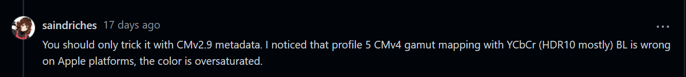

According to saindriches, cmv4 seems to have a problem on Apple platform. I want to give it a test but I don't know what file is FEL with cmv40.
