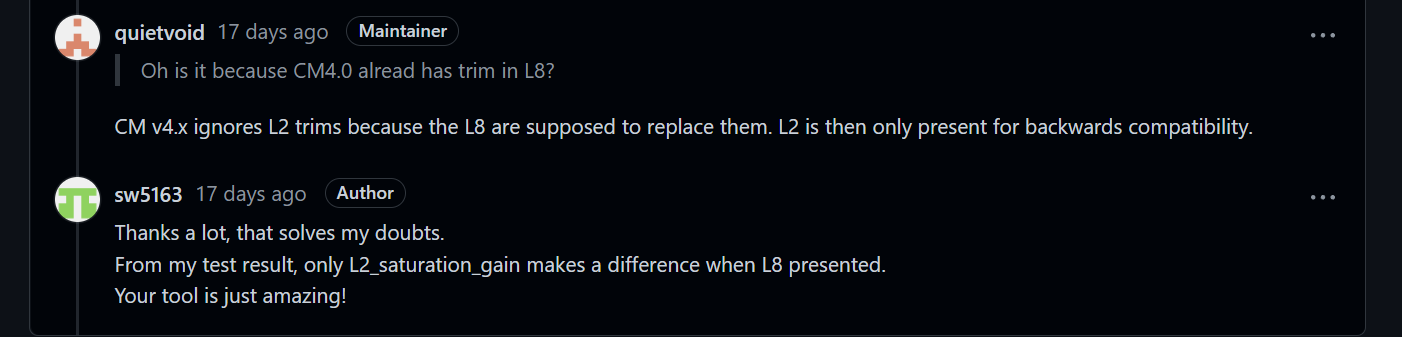

sw5163 wrote:
Mon Jun 27, 2022 1:50 am
Converted p8.1 sample:
Anyone can make this with the following command:
ffmpeg -i p81_cmv29_tests.mkv -c copy cmv29.hevc
mp4muxer -i cmv29.hevc --dv-profile 5 --dvh1flag 0 -o cmv29.mp4
They can directly play by iPhone in safari and have dolby vision.
Im not sure about ATV, but l2 trim works in cmv29 on iOS devices.
Only saturation in l2 works in cmv40 since cmv40 has l8 for replacement, according to quietvoid.
