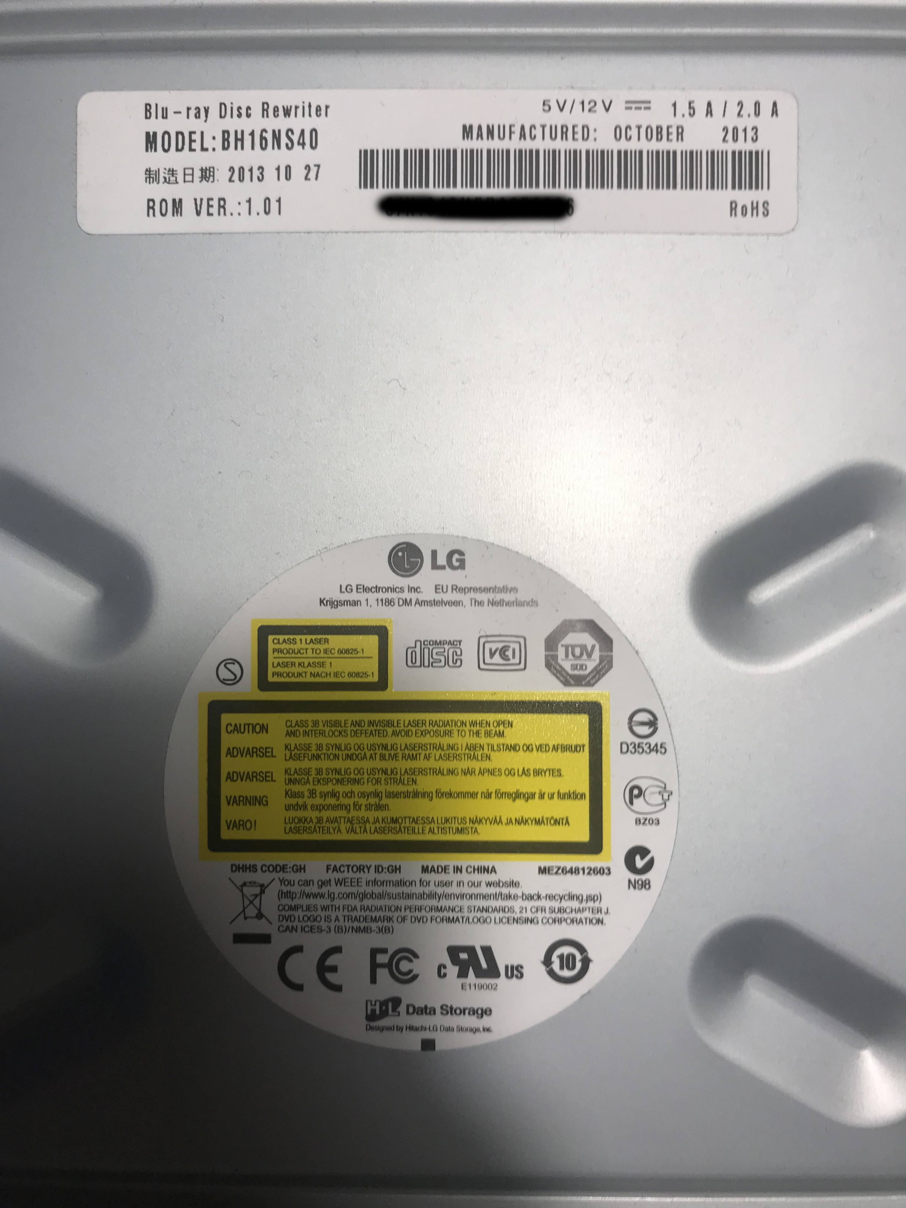

jeaveci55
Joined: Sat Jul 16, 2022 8:02 am
#1265 Post by jeaveci55 » Thu Jul 21, 2022 2:41 pm
Hello, (sorry for my english)
I just bought this hardware second hand, should I upgrade the firmware, if so what version?
Current profile: BD-RE
Product: BD-RE BH16NS40
Revision: 1.01
Firmware date: 2113-04-04 22:50
Drive platform: MT1939
Firmware version: 1.01
BD raw metadata read: Partial
Posts: 1716
#1266 Post by d00zah » Thu Jul 21, 2022 3:44 pm
jeaveci55 wrote: Thu Jul 21, 2022 2:41 pm Hello, (sorry for my english)
Revision: 1.01
Hardware is (pre-Oct 2015) too old to support UHD & the current FW supports LibreDrive. Best to leave it be.
jeaveci55
#1267 Post by jeaveci55 » Sat Jul 23, 2022 8:26 am
d00zah wrote: Thu Jul 21, 2022 3:44 pm
Revision: 1.01
I will do that, thank you very much

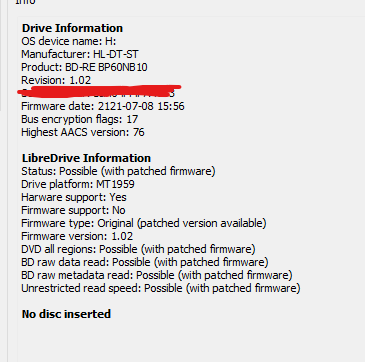

#1268 Post by xbmchermit » Sat Jul 30, 2022 4:03 am
I've tried reading earlier in this forum, but I just can't seem to piece together what I need to do.
I just got a BP60NB10 with 1.02 firmware and SVC: NB12.
What are the benefits of flashing the firmware on this drive, and how would I go about doing it (I see several warnings about NB12)?

#1271 Post by MartyMcNuts » Sun Jul 31, 2022 4:41 am
xbmchermit wrote: Sat Jul 30, 2022 4:03 am I've tried reading earlier in this forum, but I just can't seem to piece together what I need to do.
If you want to be able to rip UHD discs with your drive, flash it to BP60NB10 1.02-MK and that's it.
