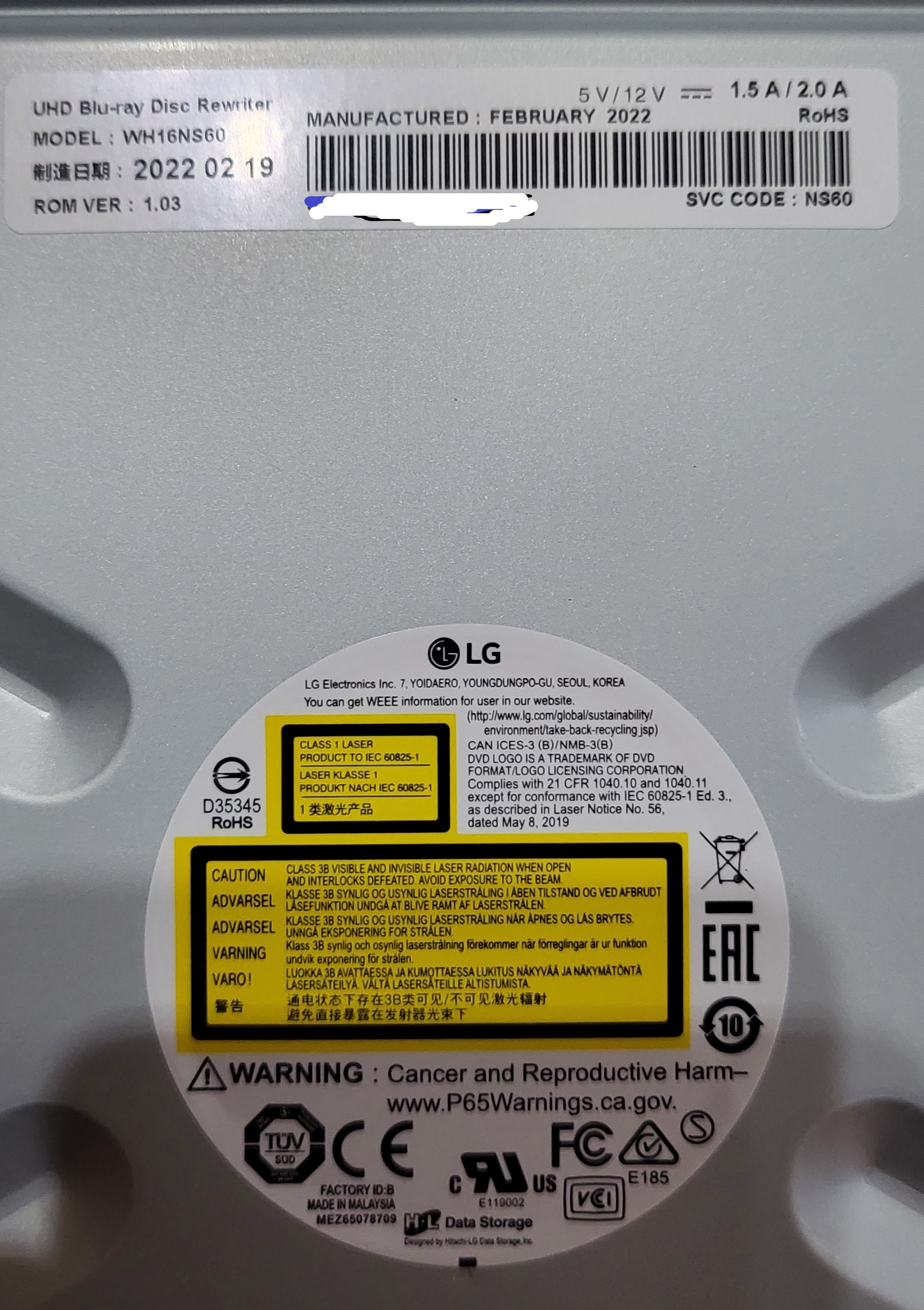

Hi guys!
Just wanted to say awesome job on mkv and the work in the background first of all!

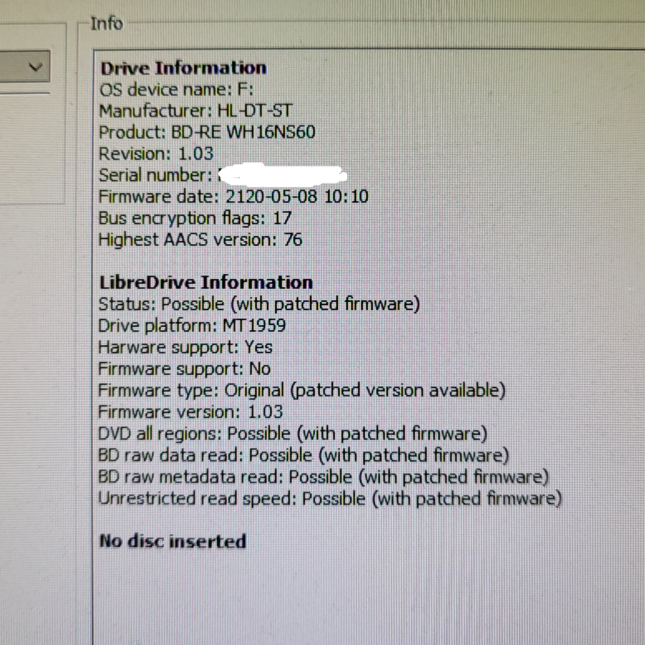

I just got an lg wh16ns60 uhd drive and was hoping a little help for the patching/flashing of this.
I have some photos here as follows:

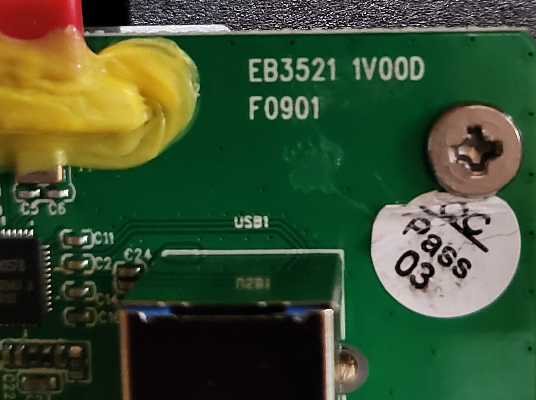

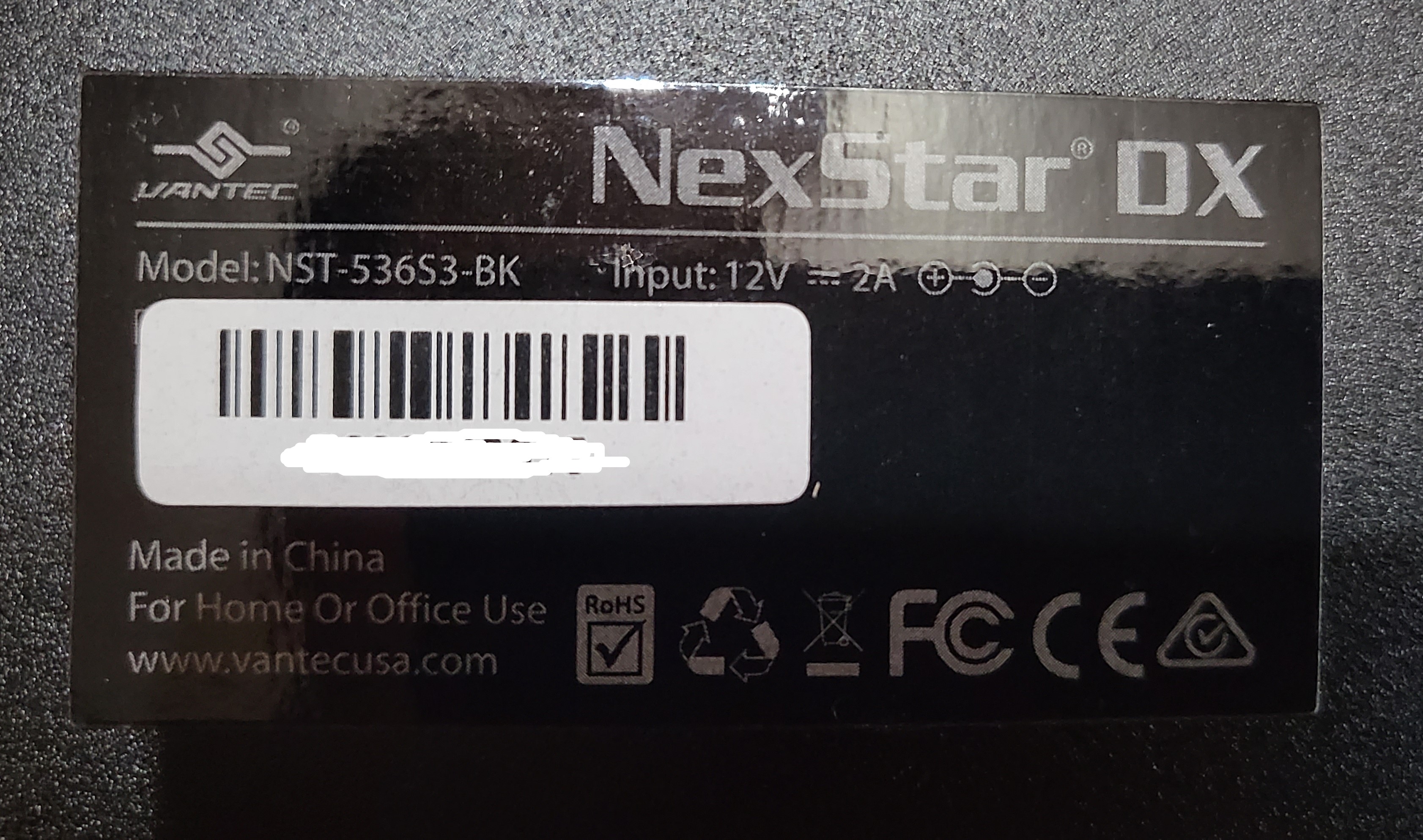

This is the case and circuit board of it,with the flasher gui and the firmware that may be the ones for me. I was hoping to not get the sleep bug,so i wondered the DE firmware. Also wondered if the rom/drive will eventually call it a night after a while or is this just a rumor. As you can see i have the 2 firmware that seem relevant to me in the same folder as the gui(or if i should go with some other firmware in the firmware packs,but is it better have the folder on my system hdd or does it not matter. Just wanted to show the case,and/or if i have to install it directly to the cabinet or is this case ok?. And when i start the gui is it something i need to check like enc or make a dump of original?
I have read a bunch so i hope i have understood correctly,thanks
TC.
TC.
Make it epic
- Posts: 5145
The WH16NS60 does not have the sleep bug.MrTCT83 wrote: Thu Jun 30, 2022 3:58 pm This is the case and circuit board of it,with the flasher gui and the firmware that may be the ones for me. I was hoping to not get the sleep bug,so i wondered the DE firmware. Also wondered if the rom/drive will eventually call it a night after a while or is this just a rumor. As you can see i have the 2 firmware that seem relevant to me in the same folder as the gui(or if i should go with some other firmware in the firmware packs,but is it better have the folder on my system hdd or does it not matter. Just wanted to show the case,and/or if i have to install it directly to the cabinet or is this case ok?. And when i start the gui is it something i need to check like enc or make a dump of original?
TC.
WH16NS60 1.03 is an encrypted firmware. Don't use 1.03-MK as 1.02-MK is far better, so flash it to WH16NS60 1.02-MK. You could either leave it on 1.02-MK or flash to DE WH16NS60 1.00. The latest version of SDFtool Flasher will autoamatically detect and apply the encrypted firmware flag for you.

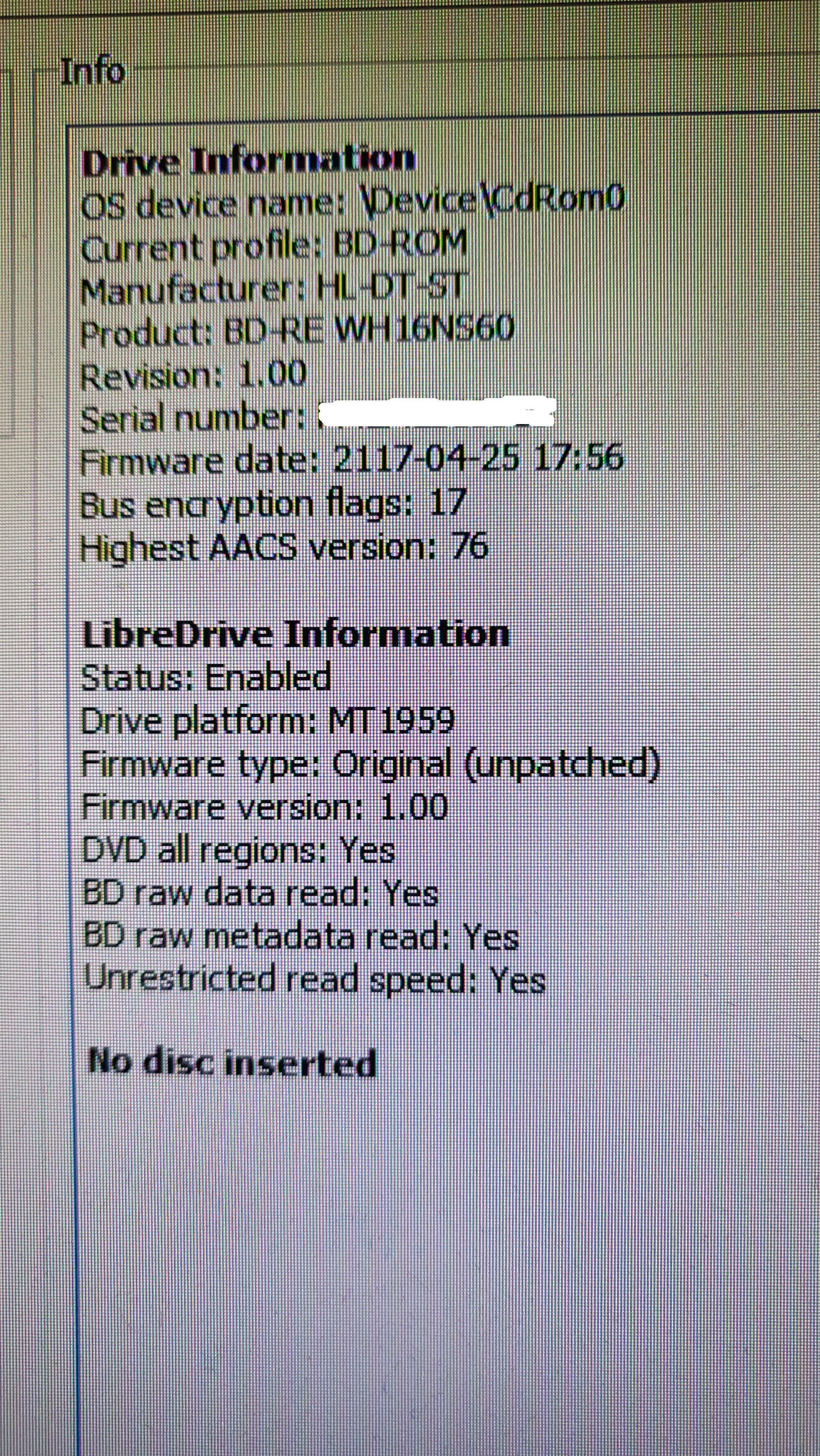

Thanks @MartyMcNuts i flashed it to 1.02 - MK,then DE 1.00. Is it possible to go back to 1.02 - Mk if i want later?

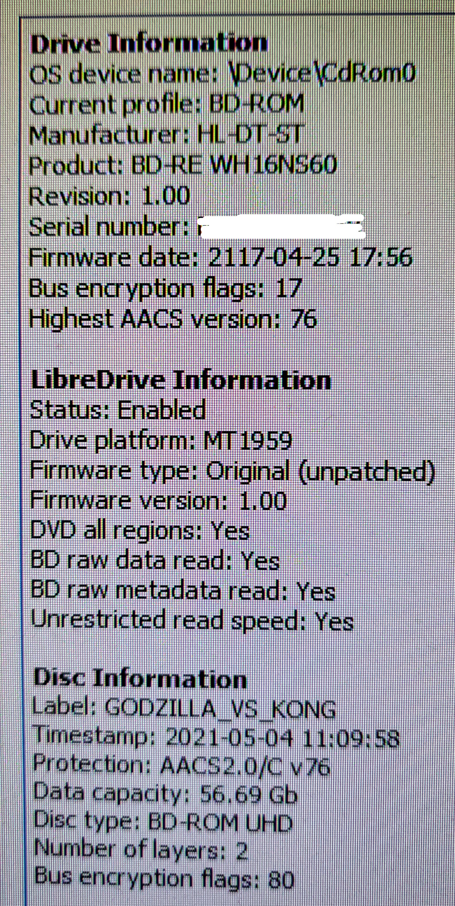

It cant read the discs or open on DE 1.00 firmware.Tried two movies and one is not detected at all,the other is detected and but fails to open. (ready player one and prince of darkness is the movies btw)

Try cleaning your discs. It is rare for a UHD disc to not need cleaning as more often than not there can be an invisible to the eye film residue left on the disc from processing. First, try wiping the disc with a microfibre cloth. If it still won't read, try a more thorough cleaning using sopay water and dry with a microfibre cloth.MrTCT83 wrote: Fri Jul 01, 2022 11:26 am Hi again!

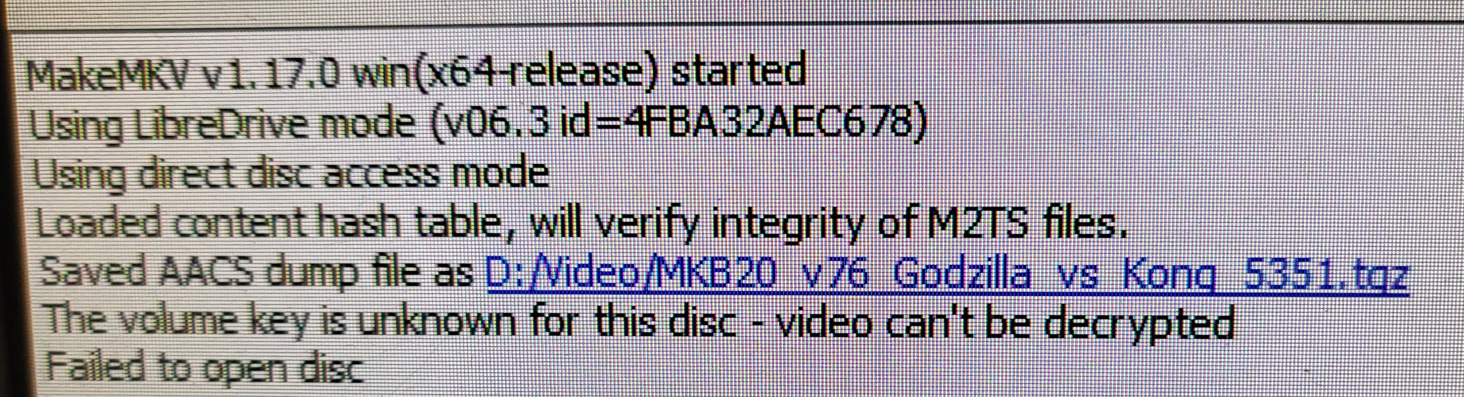

Im sending the error i get from mkv here. Tried a bunch now still all same answer as in the photo:( The discs is almost never used brand new for the most part,but taken out maybe once or twice for viewing it with my blu ray player.

Lines 5 & 6 are what you need to take notice of. Line 6 tells you that the VUK for this disc is unknown and can't be decrypted. Line 5 tells you that MakeMKV has saved a dump file for you to send in.MrTCT83 wrote: Sat Jul 02, 2022 12:26 amMartyMcNuts wrote: Fri Jul 01, 2022 11:53 pmTry cleaning your discs. It is rare for a UHD disc to not need cleaning as more often than not there can be an invisible to the eye film residue left on the disc from processing. First, try wiping the disc with a microfibre cloth. If it still won't read, try a more thorough cleaning using sopay water and dry with a microfibre cloth.MrTCT83 wrote: Fri Jul 01, 2022 11:26 am Hi again!
Hi Marty!
TC
Before doing any of this, please make sure that you have checked the box to allow MakeMKV internet access in preferences so that the VUK's for UHD discs can be downloaded. You cannot decrypt any UHD discs without them.
Once you have enabled internet access, try again.

That was it:)MartyMcNuts wrote: Sat Jul 02, 2022 12:35 amLines 5 & 6 are what you need to take notice of. Line 6 tells you that the VUK for this disc is unknown and can't be decrypted. Line 5 tells you that MakeMKV has saved a dump file for you to send in.MrTCT83 wrote: Sat Jul 02, 2022 12:26 amMartyMcNuts wrote: Fri Jul 01, 2022 11:53 pm
Hi Marty!
TC
I can post a later time just to confirm it,but so long so good.
Thanks so much for all your help!
TC
