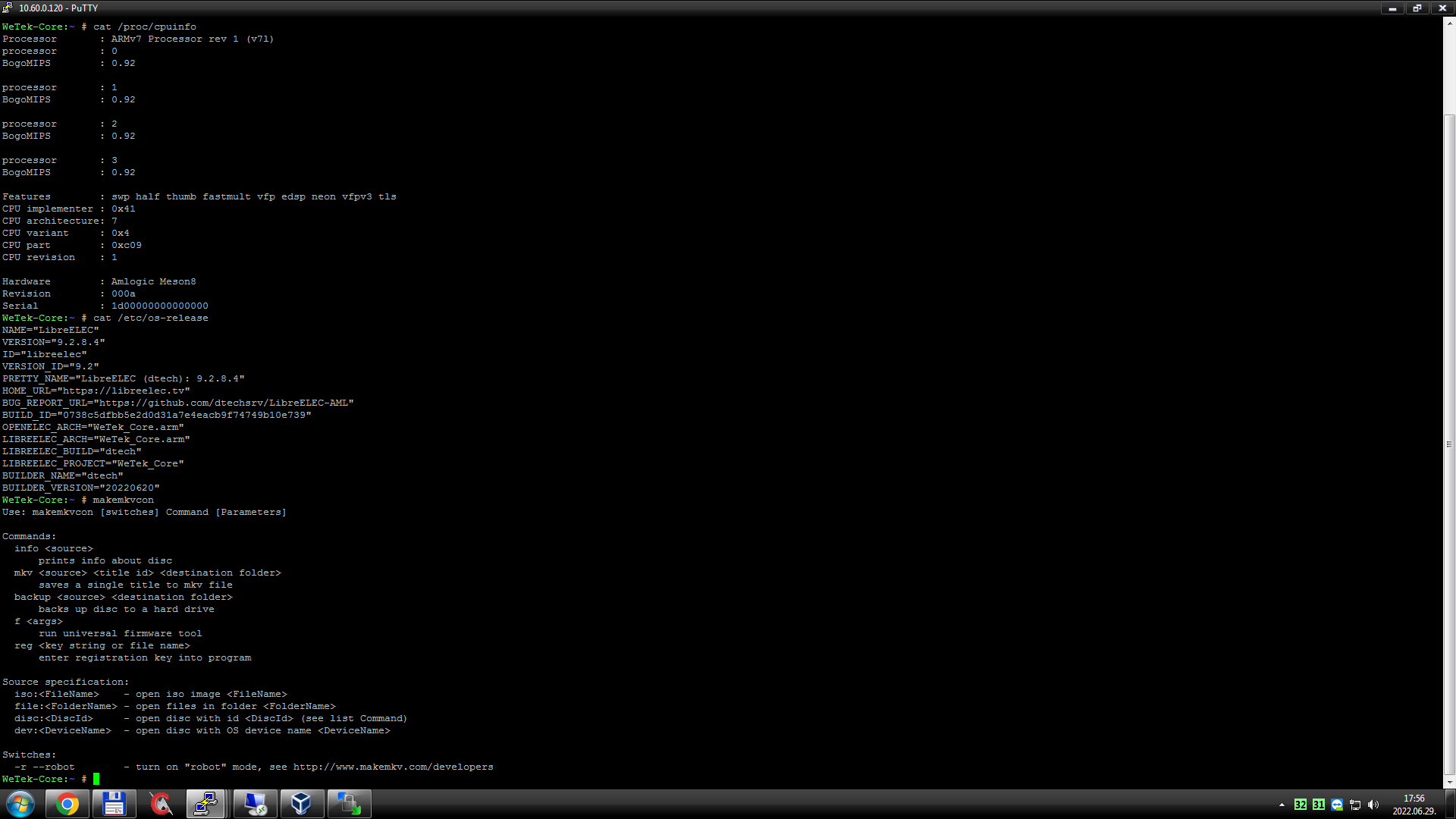

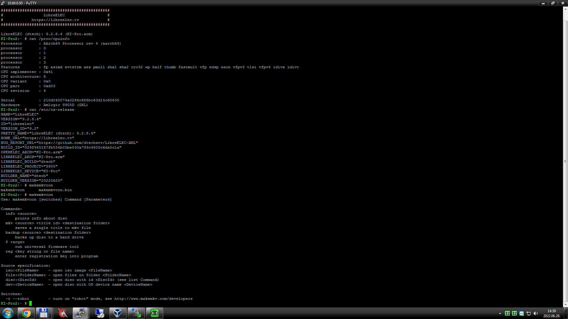

Samui
Joined: Wed Jun 29, 2022 2:47 pm
Re: Request for an 'armhf' version (32-bit)
Post by Samui » Wed Jun 29, 2022 3:00 pm
Hi there,
just would like to let you know that i can confirm that this binary is working. I also tested the playback with an UHD disc. Unfortunately it stopped after some minutes of playback while normal BD's are playing fine including the chapter search.
Thank you very much for made it happen !
dtech
Posts: 44
Joined: Mon Jun 06, 2022 7:02 am
Post by dtech » Wed Jun 29, 2022 3:59 pm
It also looks good on S812 (ARMv7, 32-bit only)

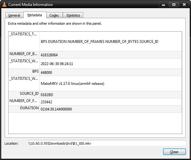

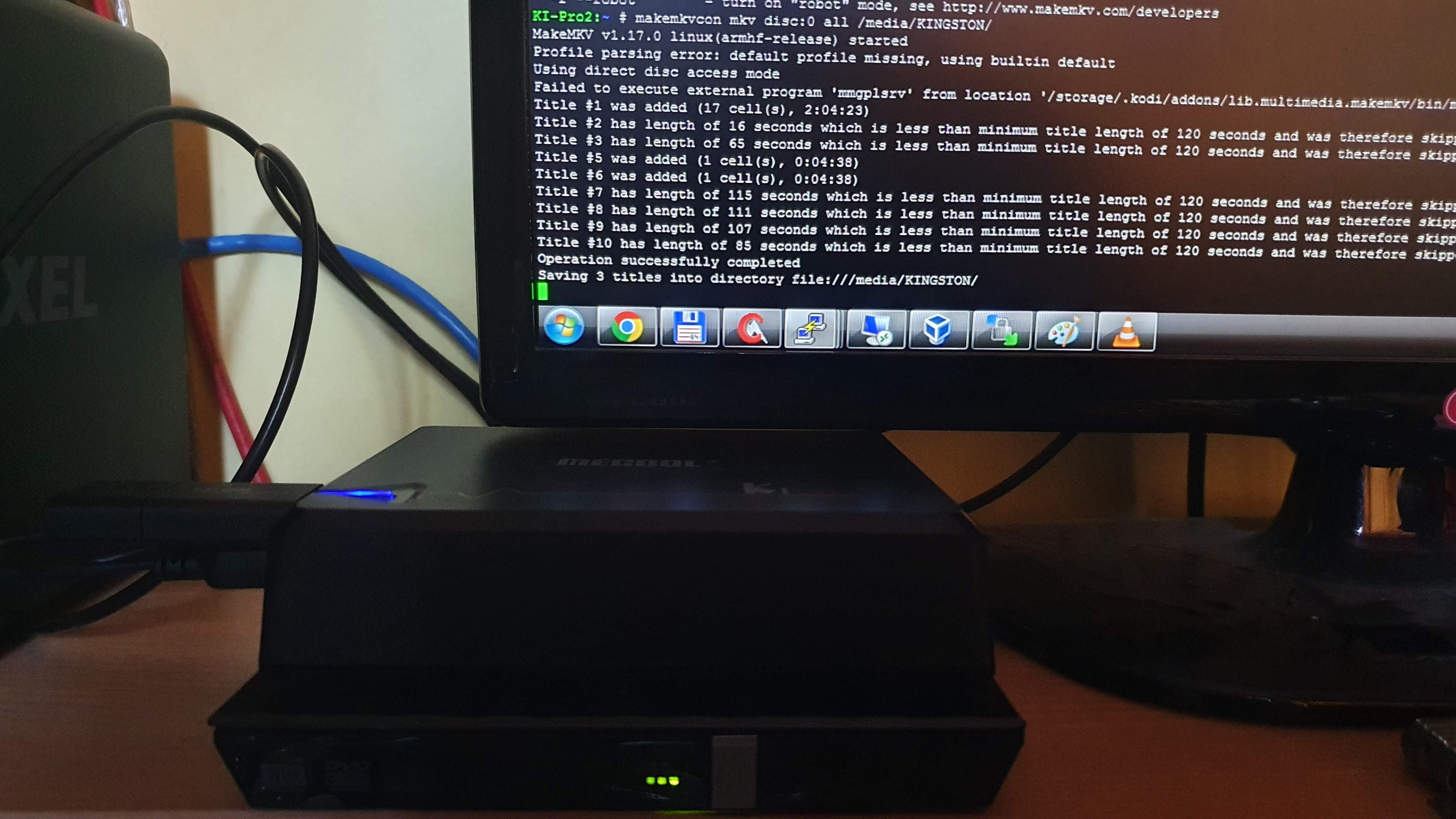

I finally managed to try it on an external DVD-RW drive with DVD-Video disc.
Edit: missing binaries ('mmgplsrv' and 'mmccextr') added to package bin directory.
KI-Pro2:~ # makemkvcon mkv disc:0 all downloads/dvd/
MakeMKV v1.17.0 linux(armhf-release) started
Profile parsing error: default profile missing, using builtin default
Using direct disc access mode
Title #1 was added (17 cell(s), 2:04:23)
Title #2 has length of 16 seconds which is less than minimum title length of 120 seconds and was therefore skipped
Title #3 has length of 65 seconds which is less than minimum title length of 120 seconds and was therefore skipped
Title #5 was added (1 cell(s), 0:04:38)
Title #6 was added (1 cell(s), 0:04:38)
Title #7 has length of 115 seconds which is less than minimum title length of 120 seconds and was therefore skipped
Title #8 has length of 111 seconds which is less than minimum title length of 120 seconds and was therefore skipped
Title #9 has length of 107 seconds which is less than minimum title length of 120 seconds and was therefore skipped
Title #10 has length of 85 seconds which is less than minimum title length of 120 seconds and was therefore skipped
Saving 3 titles into directory file://downloads/dvd/
3 titles saved
Copy complete. 3 titles saved.
Edit 2: I got a new feedback from Samui that 4K Bluray disc playback is also working perfectly now, there was something wrong with the previous attempt, but it is not related to makemkv.

In the meantime, I also tested it under the native 32-bit ARMv7 SoCs: Amlogic S812 (Cortex-A9) and Amlogic S805 (Cortex-A5), and I didn't experience any errors under them either, the armhf version works fine.
