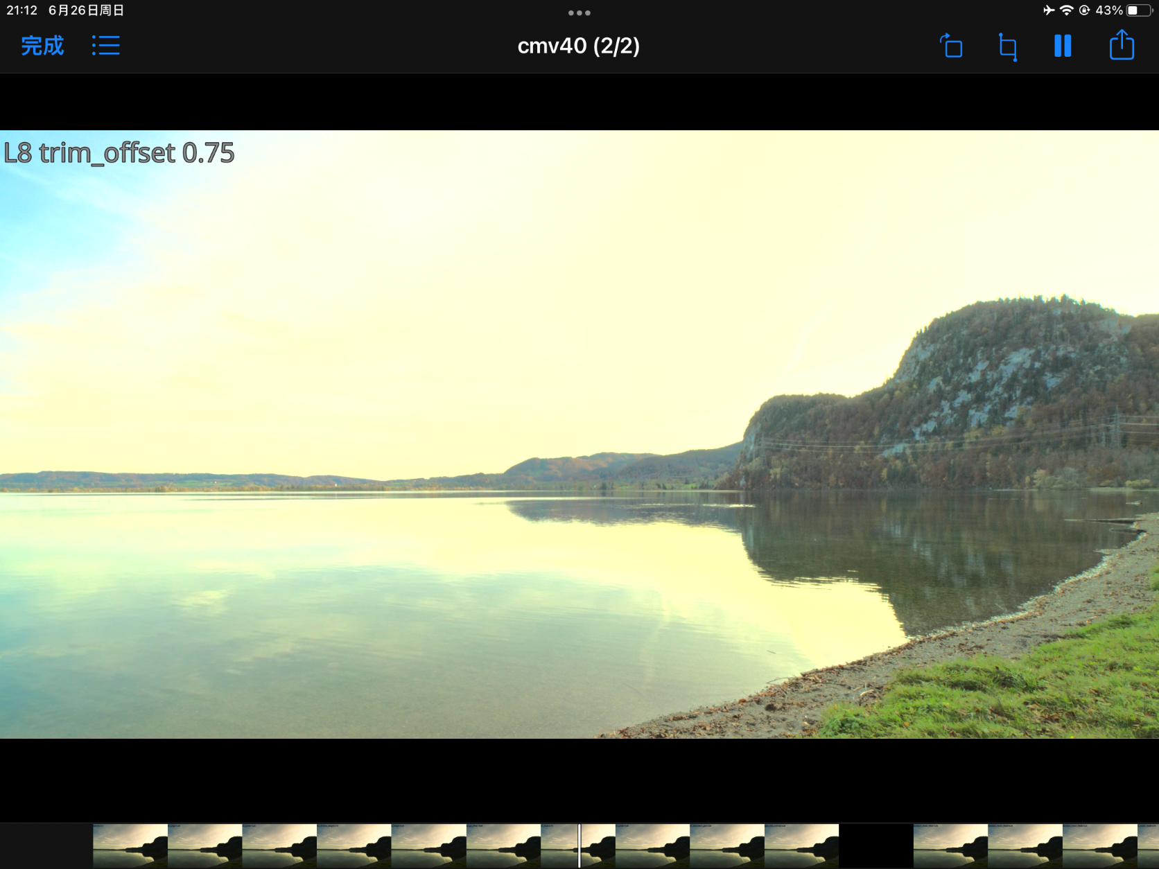

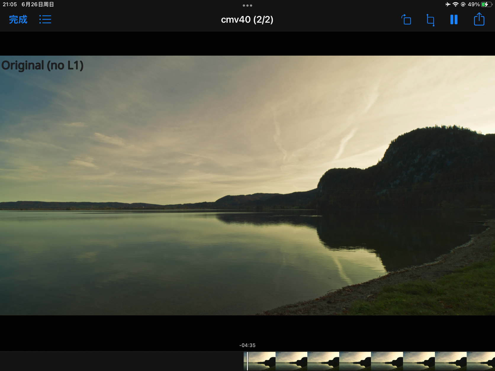

Those p8.1 HDR one work on iPad once I convert them to dvh1 p5.
Don't much like HLG, maybe I will test HLG later.
Maybe im wrong but it makes no sense iOS devices can play them yet Apple TV can't.
Im using this Apple's "file app" smb video from my computer instead of INFUSE. Not sure if that's what it's called.
https://support.apple.com/en-us/102570
The attachment fileapp.png is no longer available

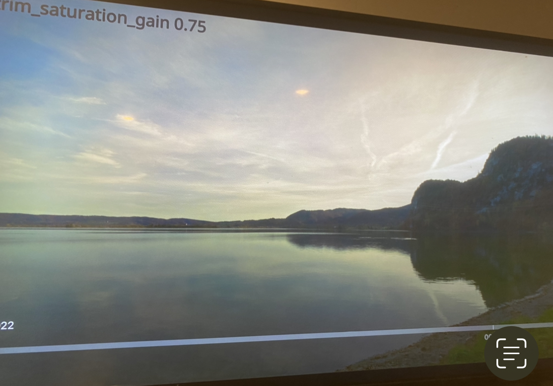

CM v2.9 test result:
https://drive.google.com/file/d/1ojAXiv ... sp=sharing
L1 works
L2 works except ms_weight, can't see a difference.
CM v4.0 test result:
https://drive.google.com/file/d/18uibAw ... sp=sharing
L1 works
L2 some works
L3 works
L8 some works
Those screenshots can stand for what I have seen.
Now im 99% sure I found the way to play p8.1 on iOS devices.
Converted p8.1 sample:
Anyone can make this with the following command:
ffmpeg -i p81_cmv29_tests.mkv -c copy cmv29.hevc
mp4muxer -i cmv29.hevc --dv-profile 5 --dvh1flag 0 -o cmv29.mp4
update:
Now im 100% sure since iPhone can play the sample link directly in safari and have dolby vision.
Anyone with Apple tv feel free to test.
HLG also works on iOS device.
mp4muxer -i hlg.hevc --dv-profile 5 --dvh1flag 0 -o p5_dvh1_8.4_HLG.mp4
mp4muxer -i hlg.hevc --dv-profile 8 --dv-bl-compatible-id 4 --hvc1flag 0 -o p8.4_dvh1_8.4_HLG.mp4
Both work to some extent.
Can't believe I got both cmv2.9 and cmv4.0 to work on 5 years ago iPad.
Credit goes to quietvoid and yusesope and their amazing tool!
Thanks again for everyone's help!
aside:
When converting "real" streaming profile 5 dvhe->dvh1 (for iOS native player compatibility)
mp4muxer results in black screen, mp4box works fine. They have exact same RPU.
Infuse shouldn't have this problem since it doesn't even need the conversion.

Well it's interesting but the output is definitely SDR on your iPad.
Someone with the Apple TV should be able to test if your files work in regular HDR Dolby Vision output.

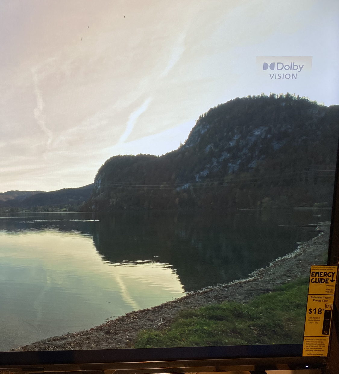

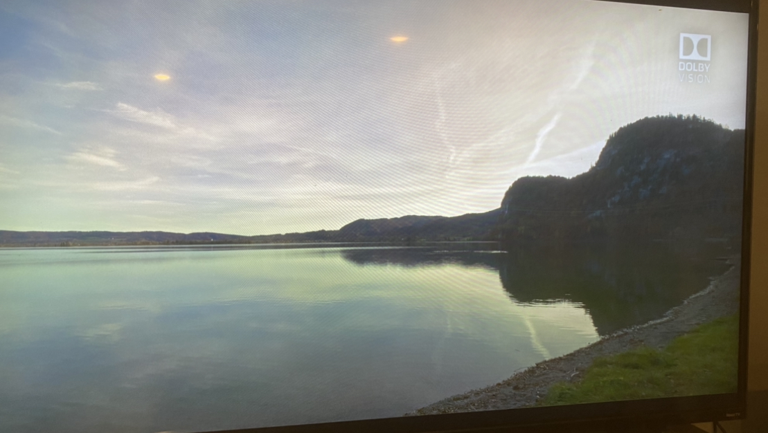

#6759 Post by Manixx2020beyound » Mon Jun 27, 2022 8:39 pm
sw5163 wrote: Mon Jun 27, 2022 1:50 am
RESET_9999 wrote: Sun Jun 26, 2022 8:24 pm go read the past weeks in this thread, all the test have been done and confirmed that the appletv only support genuine p5 DV. ( i dont know about other apple devices)
You mean these files? Many thanks to quietvoid for providing them!
quietvoid wrote: Wed Jun 08, 2022 1:51 am You can try the files here: https://mega.nz/file/xNcAVQhJ#ldoifbK6D ... dXkzw2HYgs
On a DM v1 (CM v2.9) supporting display/device: p81_cmv29_tests, p84_cmv29_tests.
On a DM v2 (CM v4.x) supporting display/device: p81_cmv40_tests, p84_cmv40_tests
LG C2:
- CM v2.9: L1, L2 works
- CM v4.x: L1 works, L2 alone doesn't work. L3 works, L8 works up to clip_trim, the rest makes no difference.
FireTV Stick 4K Max:
- CM v4.x: L1, L2 works, L3 and L8 don't.
CM v4.x L8 trims are also very different to L2.
There's a bug with the first 3s for HLG since I forgot to add the reshaping.
L1 works
L1 works
L2 some works
L3 works
L8 some works
update:
aside:
Hum,
We’ll it plays doblyvision on my pc all trims as well & triggers pc dv.
Are the colors correct is a good question doe.
But I’ll test it on my appletv but I would say it should play on appletv.
Yes it plays on appletv & all the l/trims
And u can upload that to your apple tv library
Stream it from Mac m1 to Apple TV
Stream it form pc to Apple TV works
