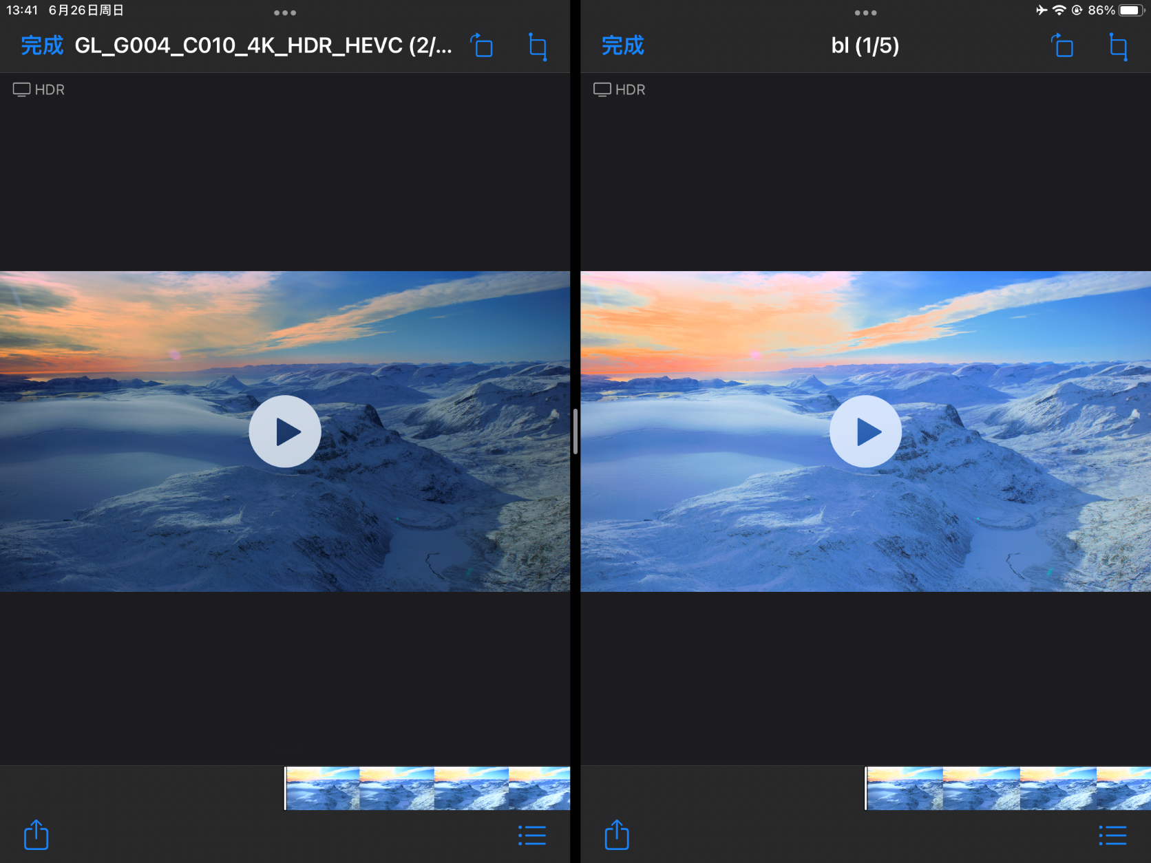

RESET_9999 wrote: Sun Jun 26, 2022 12:53 pm Appletv only support real profile 5 from streaming services which you cannot get from profile 7 rip.
Check Apple tv's screensaver, they are HDR10 based profile 5 with similar RPU just like my sample.
https://sylvan.apple.com/Aerials/2x/Vid ... R_HEVC.mov
https://sylvan.apple.com/Aerials/2x/entries.json
dolby vision(left) looks very different from base HDR10 one(right)
The use of profile 5 is just to get 'dvh1' flag and trick Apple's player to play proper dolby vision p8.1.

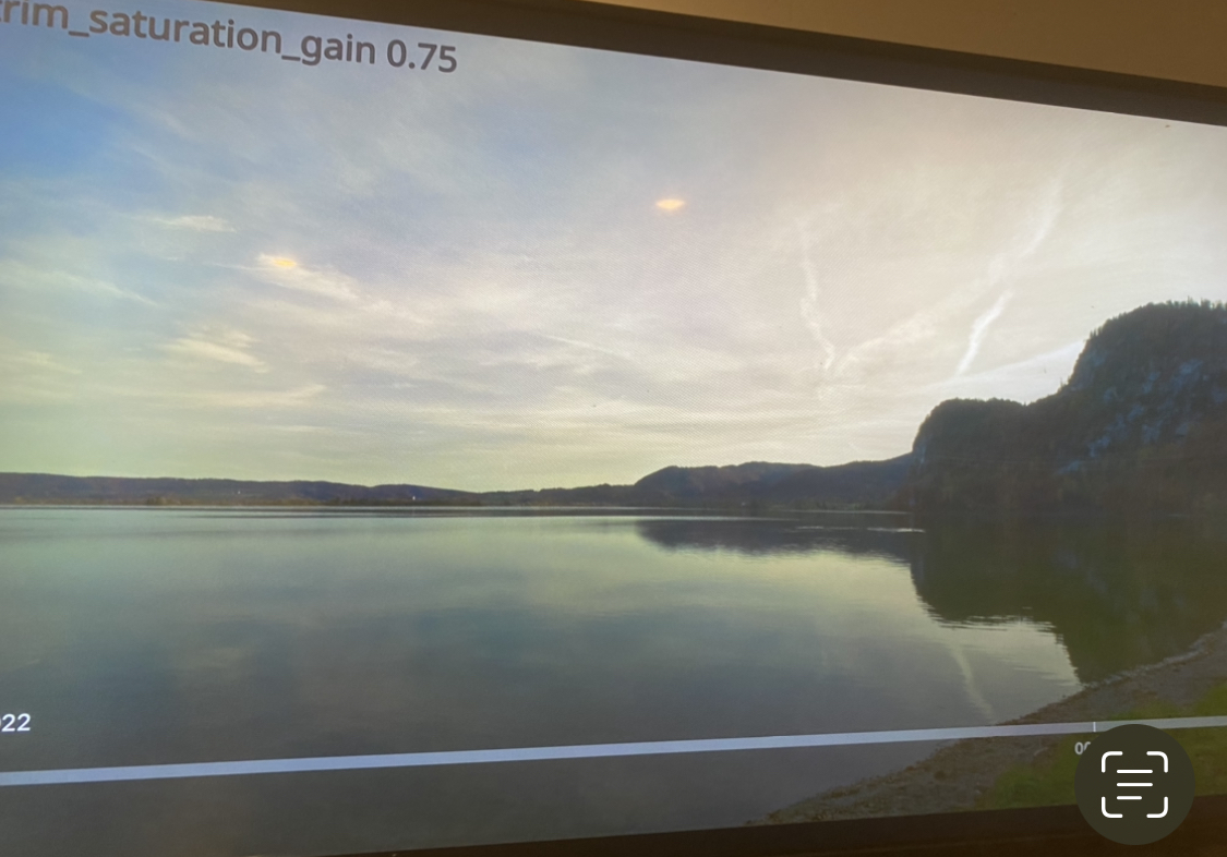

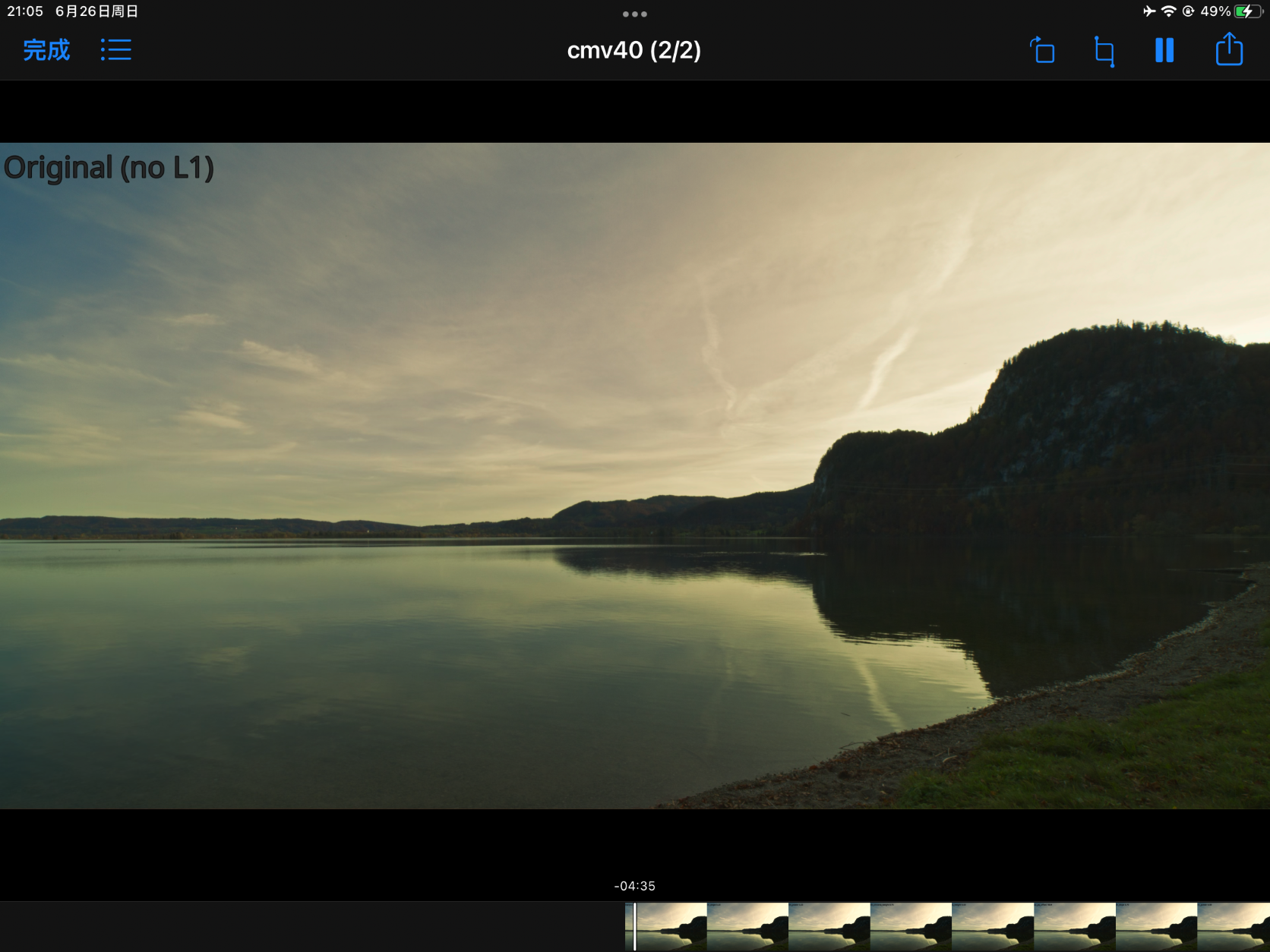

CM v2.9 test result:
https://drive.google.com/file/d/1ojAXiv ... sp=sharing
L1 works
L2 works except ms_weight, can't see a difference.

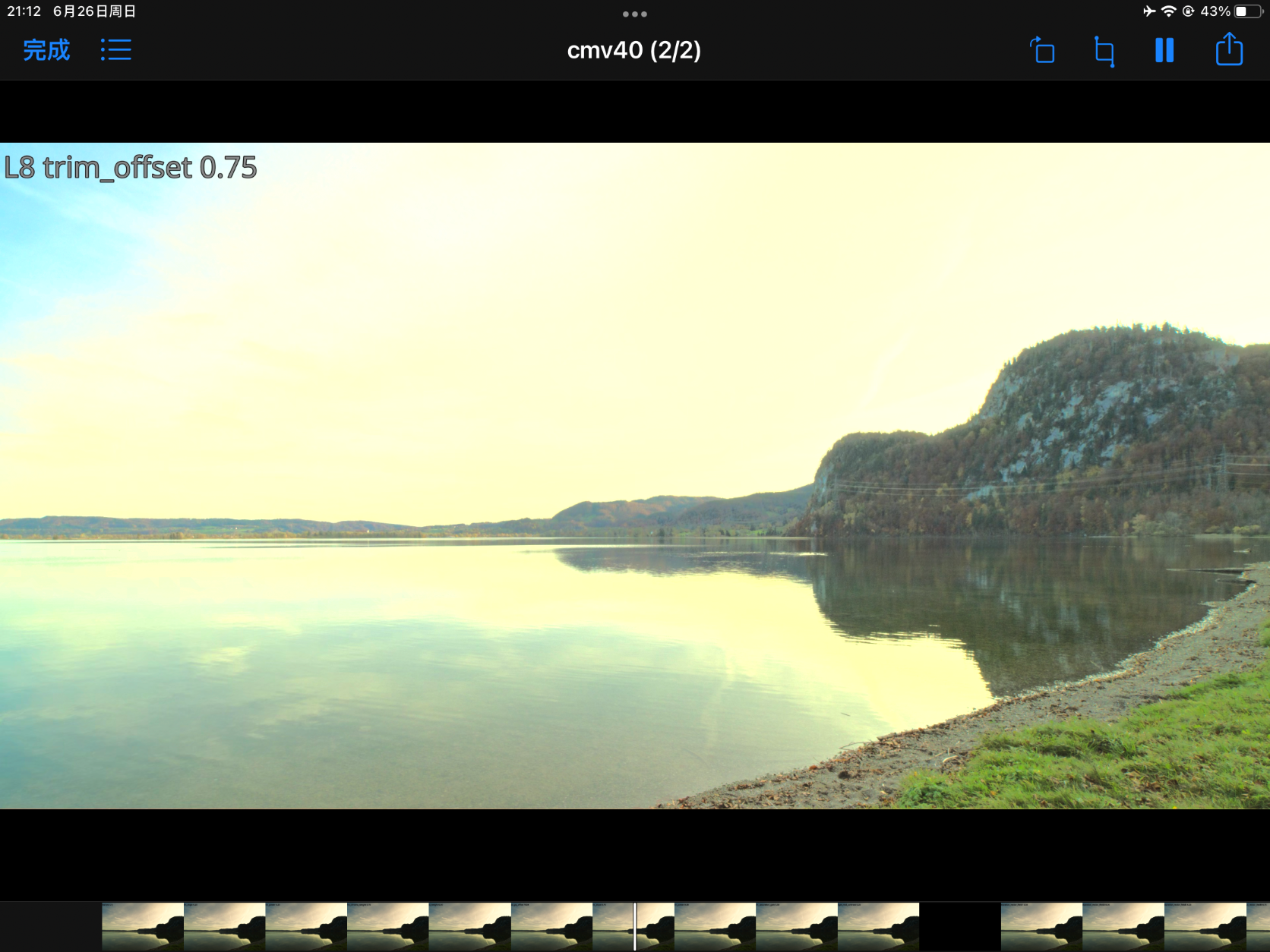

CM v4.0 test result:
https://drive.google.com/file/d/18uibAw ... sp=sharing
L1 works
L2 some works
L3 works
L8 some works
Those screenshots can stand for what I have seen.
