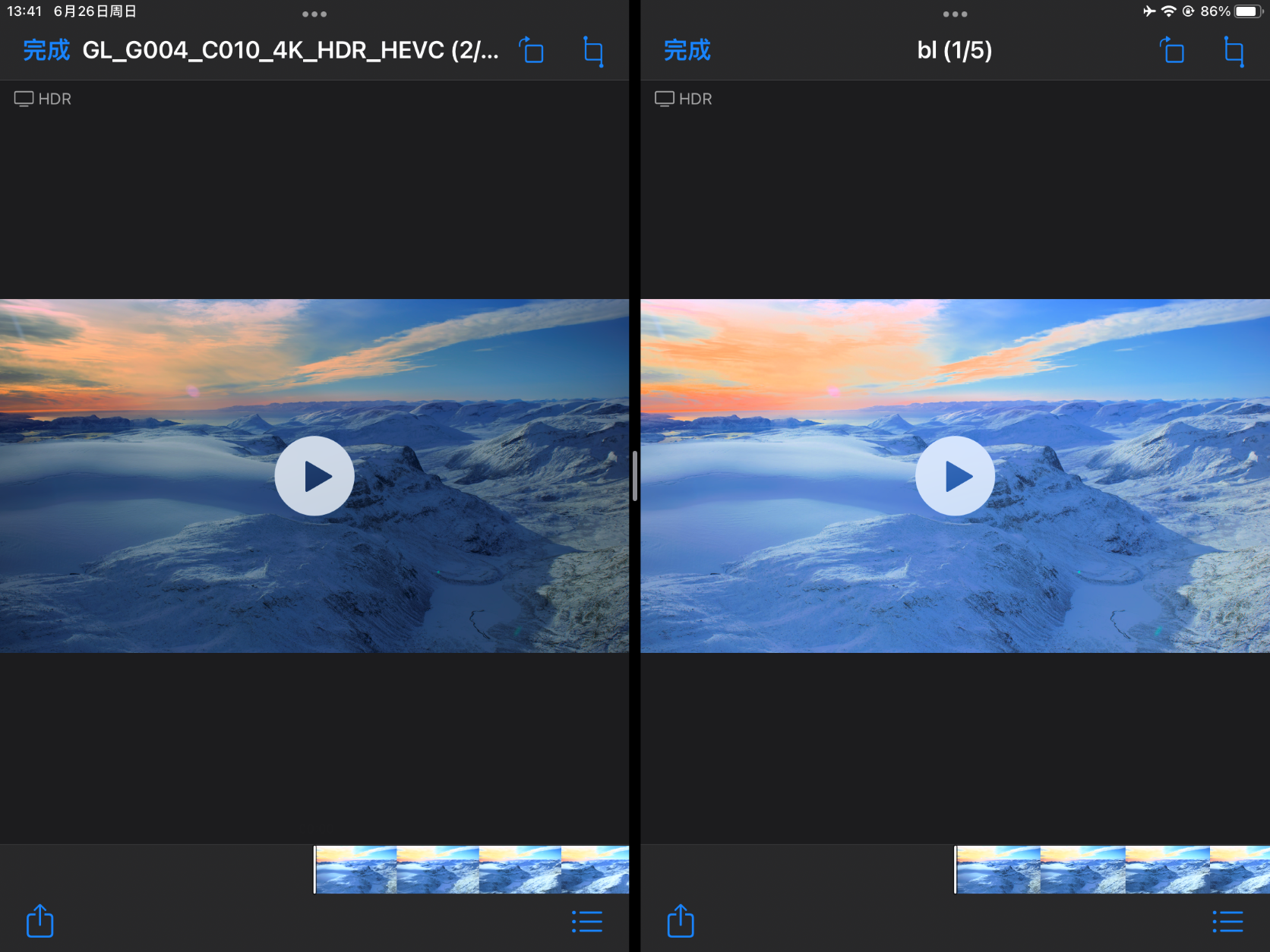

Well, i'm using ios device but i'm pretty sure it is playing dolby vision with dynamic brightness adjustment.RESET_9999 wrote: Sun Jun 26, 2022 12:53 pmAppletv only support real profile 5 from streaming services which you cannot get from profile 7 rip.sw5163 wrote: Sat Jun 25, 2022 7:51 am I think it is possible to convert dual layer FEL to Apple compatible BL+RPU.
Apple TV needs more test but I believe it will play properly.
Check Apple tv's screensaver, they are HDR10 based profile 5 with similar RPU just like my sample.RESET_9999 wrote: Sun Jun 26, 2022 12:53 pm Appletv only support real profile 5 from streaming services which you cannot get from profile 7 rip.

dolby vision(left) looks very different from base HDR10 one(right) The use of profile 5 is just to get 'dvh1' flag and trick Apple's player to play proper dolby vision p8.1.

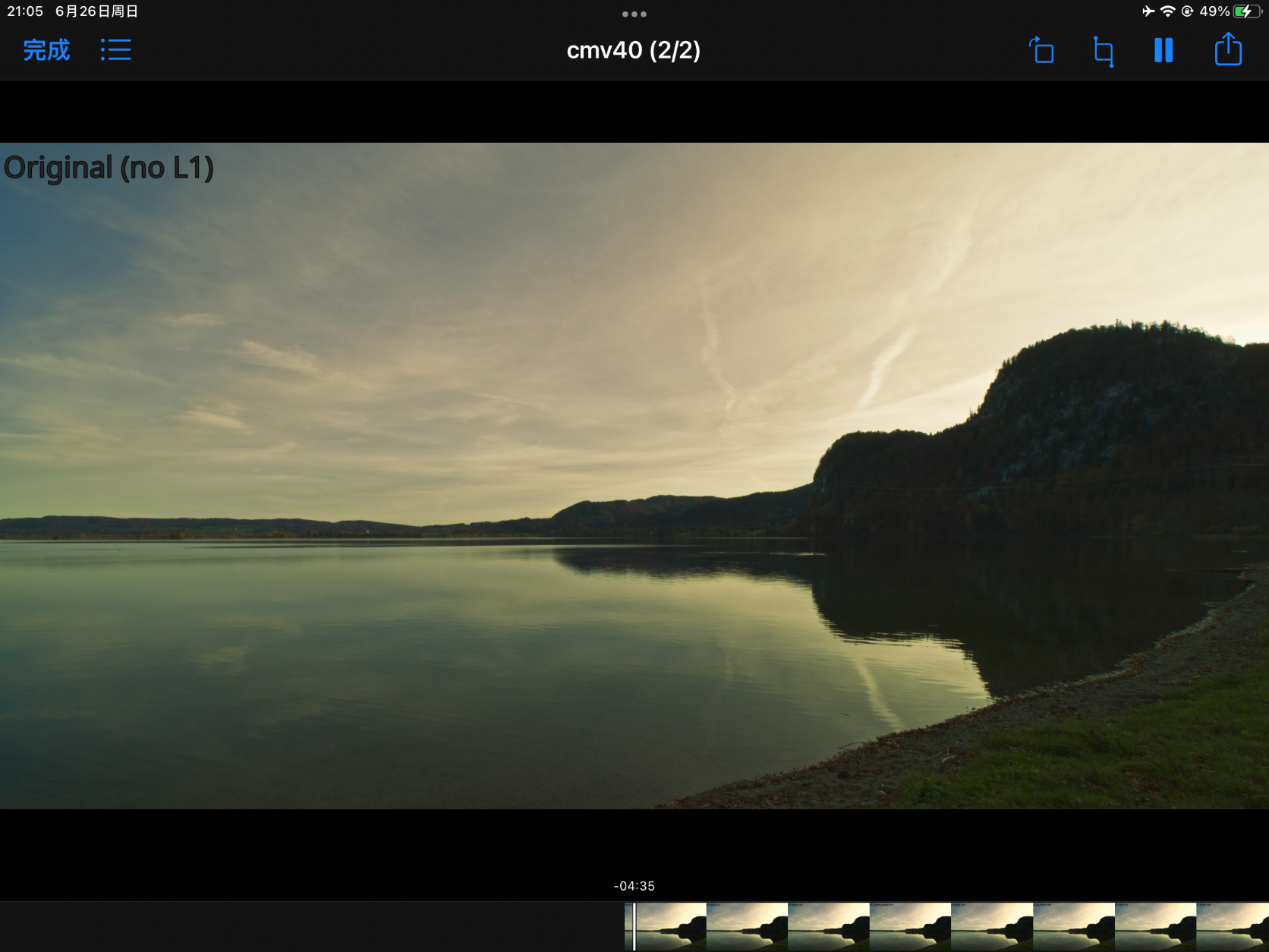

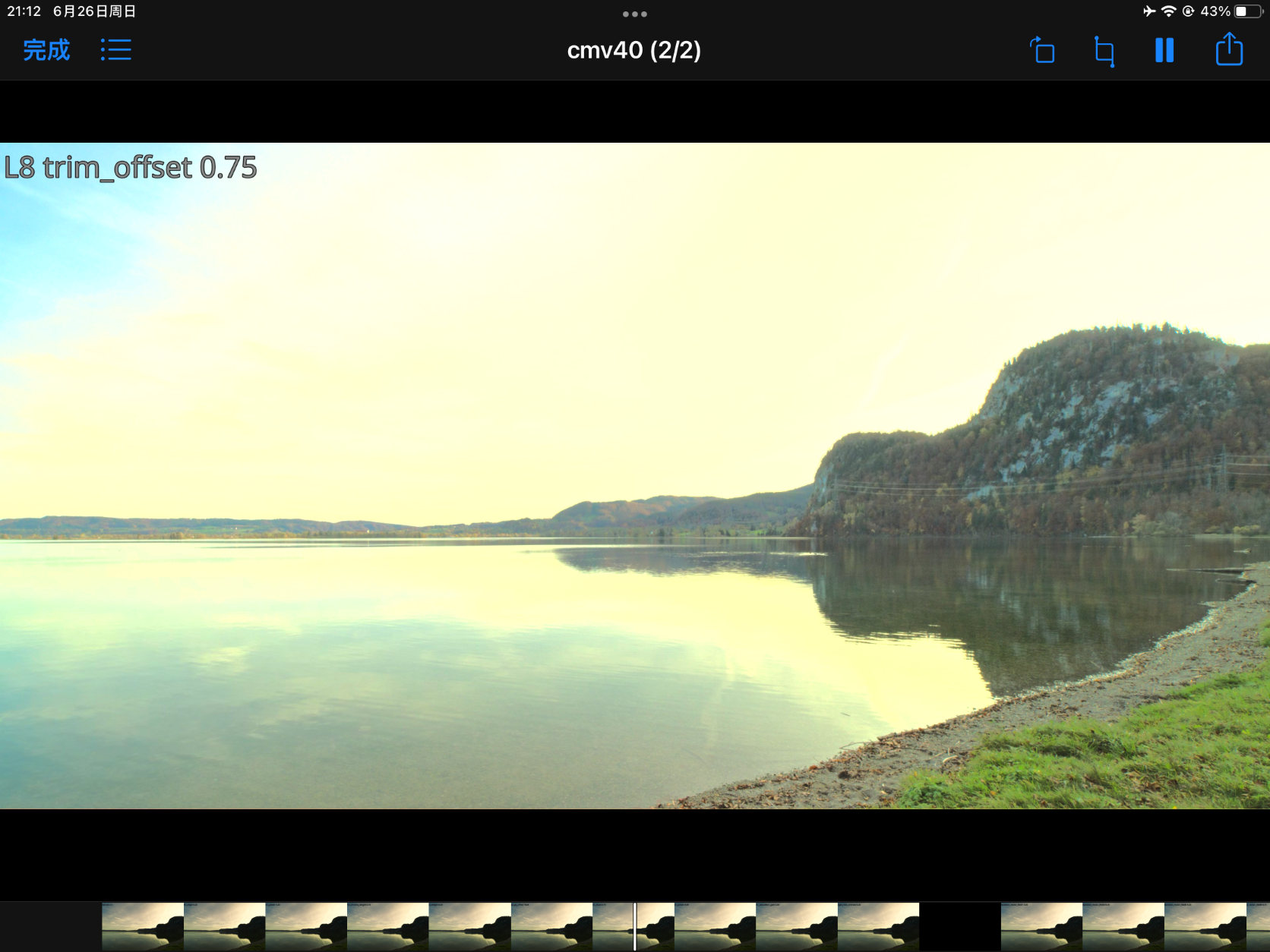

https://support.apple.com/en-us/102570 CM v2.9 test result:
https://drive.google.com/file/d/1ojAXiv ... sp=sharing
L1 works
L2 works except ms_weight, can't see a difference.
CM v4.0 test result:
https://drive.google.com/file/d/18uibAw ... sp=sharing
L1 works
L2 some works
L3 works
L8 some works
Those screenshots can stand for what I have seen.

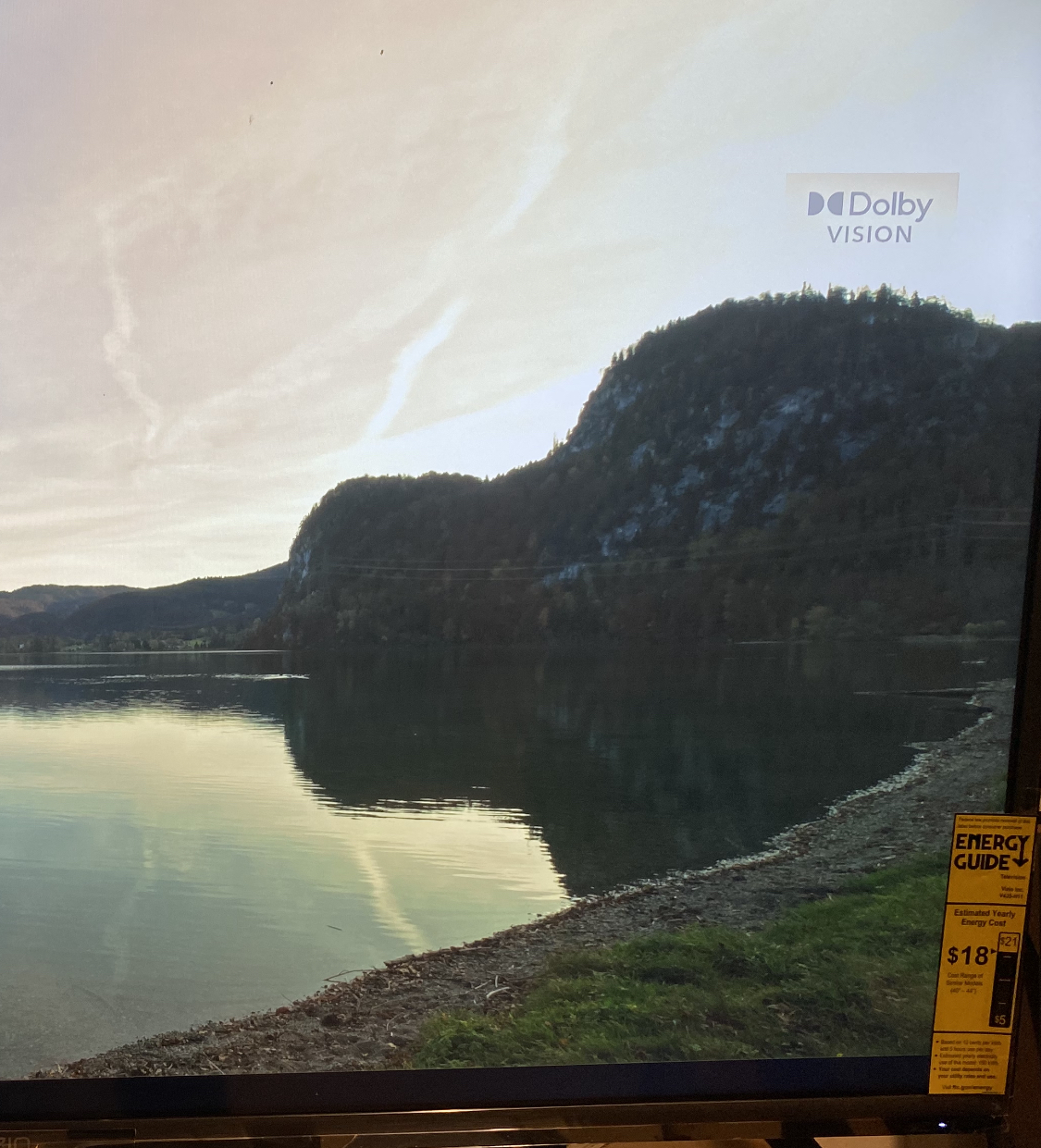

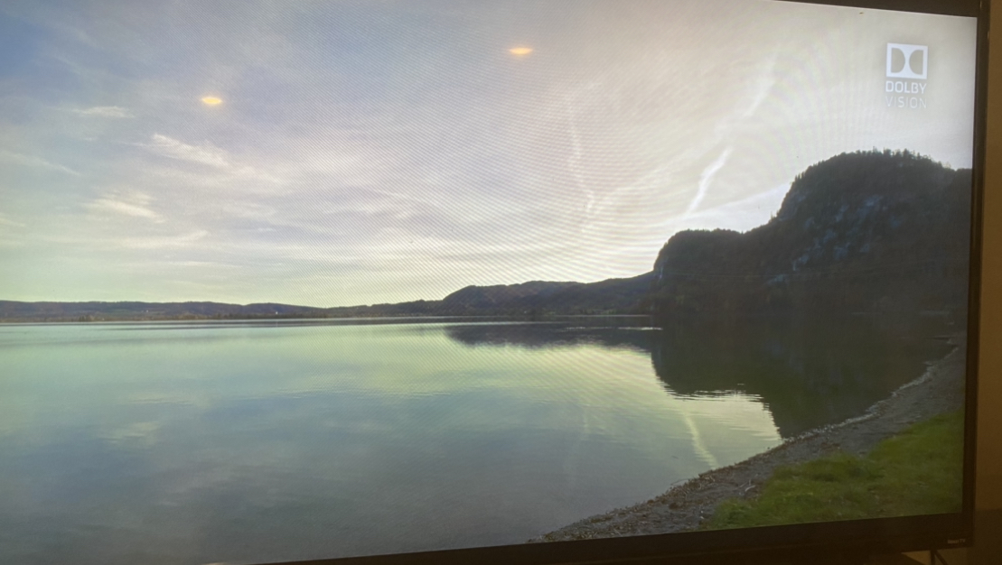

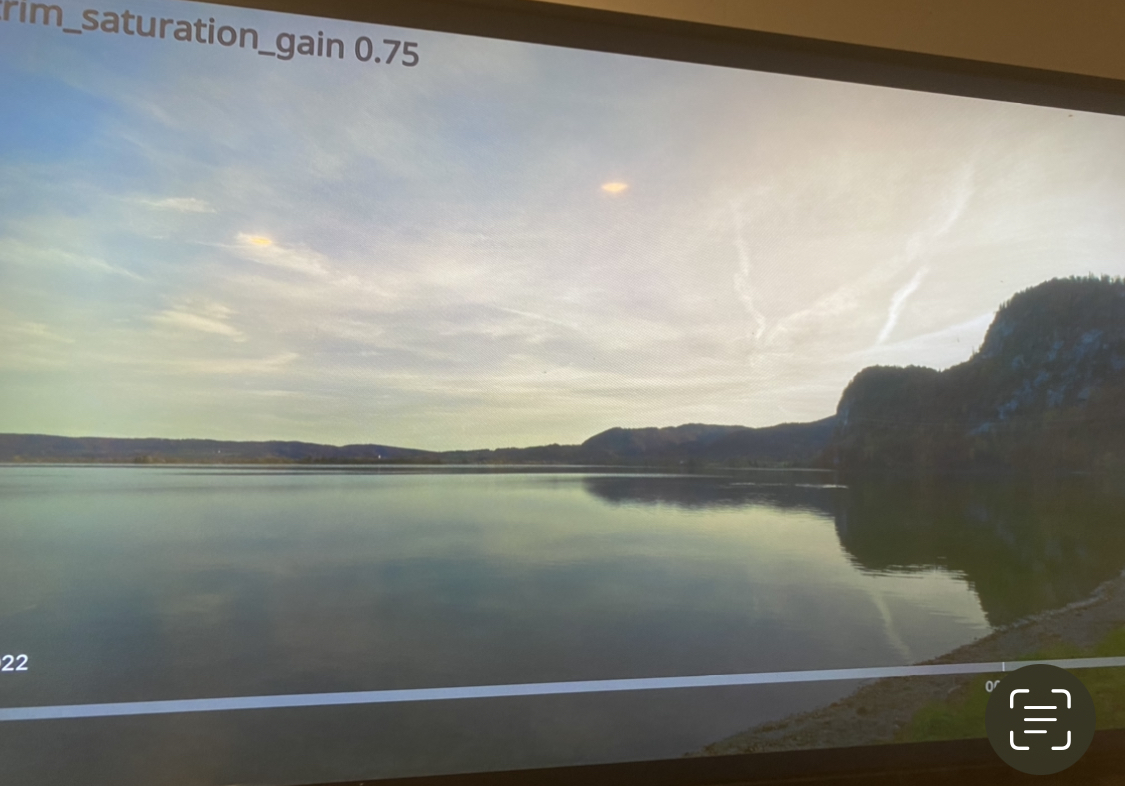

We’ll it plays doblyvision on my pc all trims as well & triggers pc dv.
Are the colors correct is a good question doe.
But I’ll test it on my appletv but I would say it should play on appletv.
Yes it plays on appletv & all the l/trims
And u can upload that to your apple tv library
Stream it from Mac m1 to Apple TV
Stream it form pc to Apple TV works

Nice it works!Manixx2020beyound wrote: Mon Jun 27, 2022 8:39 pm Hum,
I thought they have no reason to not work on apple tv.
So BL+RPU can now play on iPhone, iPad, apple tv.
How interesting we can play Bluray MEL in phones, lol.
