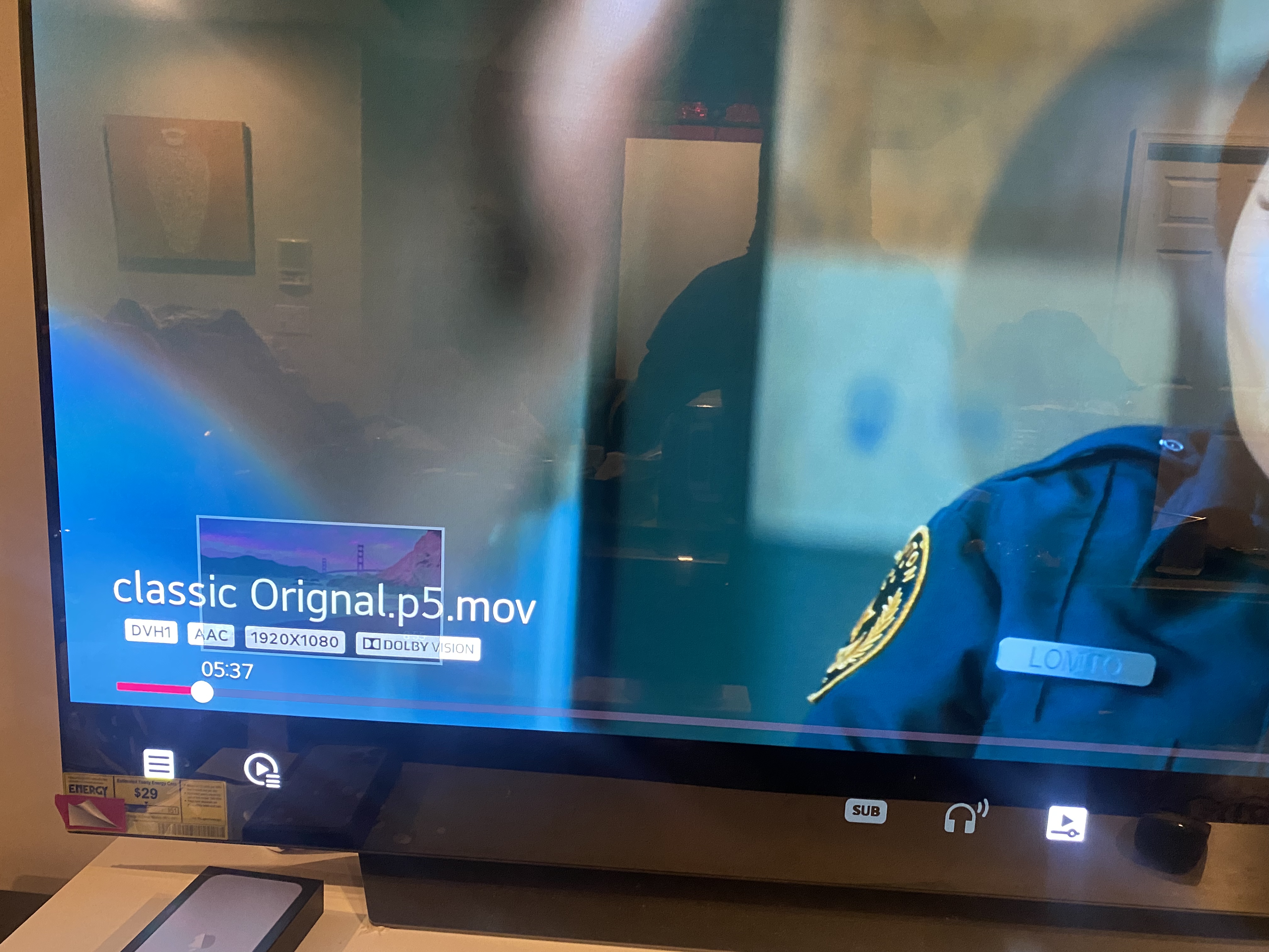

#6599 Post by Manixx2020beyound » Tue May 24, 2022 11:57 pm
I just made a profile 5 doblyvision encode (now-possible) encoded on a pc
This test was made from a hdr10 base layer.
And it works on apple 🍎 tv
I’ll wait for reset9999 to compare
