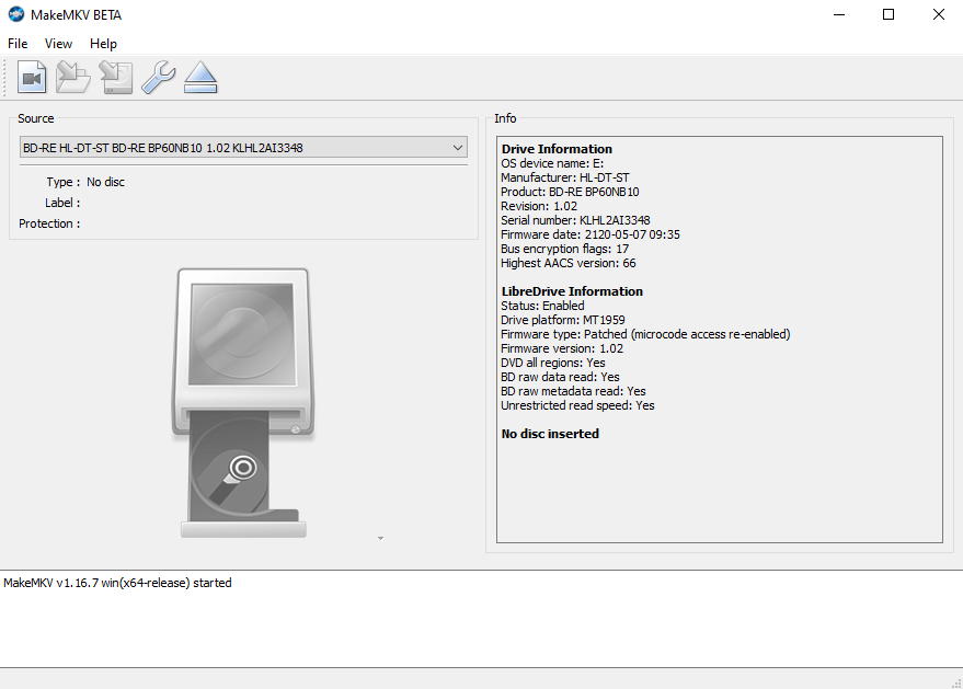

Yes, I did exactly all of those steps you mentioned already, multiple times. I tried it again now and did it a few more times too. It says ready after a few seconds.
Then when I enter Make MKV, it still shows me the incorrect drive.
I also cant open the tray or close it. It always shows me like the tray is open (In Make MKV) even though it's not.

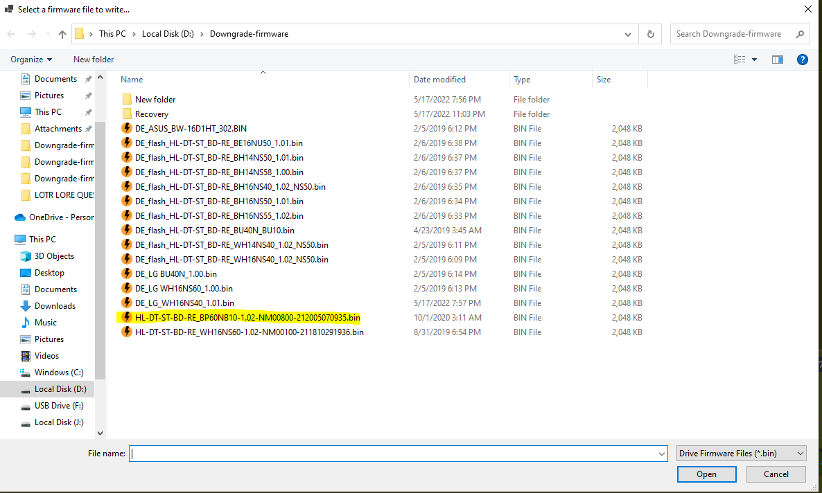

Done that too, multiple times. Did it again now, still same outcome.
I attached an image and highlighted the firmware I flashed to the first time.

It worked now! I can open and close the tray, but it doesn't seem to recognize any Blu-ray Discs I place in it.
What can I do?

Because if so, I don't know what to do. I just bought this drive not too long ago, and that will be $80 gone down the drain, with no way to play/rip my discs :(
That was my own experience with this scenario. After flashed the wrong firmware blue light always on, no matter if eject button pressed or not and a very strong
smell of something overheated, like I said before.
You can try anyway this method:
1) Flash any compatible MK firmware.
2) Use the SDF Tool flasher (or the asus) selecting a DE firmware (Downgrade Enable).
3) Use now the SDF Tool flasher with the dump full syntax command in order to produce a 2048 kb file size.
4) That's the difficult part. You should copy and paste some hex values from the sdftool full dump (which doesn't contain the first 0x400 hex bytes data of the real LG firmware)
in order to get a full firmware to recovery and make the relative full rawflash write (with sdftool) to your unit, to revert it to the stock default firmware.
But, even doing this and turn back your unit at its factory firmware, I'm pretty sure engine unit is gone, but I will be happy to be proved wrong.
I don't know how to use those types of commands you mentioned; I just used the SDF Tool's Recovery option to try and restore the correct firmware after accidently flashing to a Slim drive. Which I did, but the problem now, as I said, is that the driver does not seem to recognize the discs. But the tray does open and close now however, with a blue light flickering once I either open or close it.
TeddyRaspin
Posts: 202
#1230 Post by TeddyRaspin » Sun May 22, 2022 7:58 pm
sapphire wrote: Sun May 22, 2022 6:33 pm
Try to do a full dump of your firmware (you should now have a non slim firmware) and send it to me.
