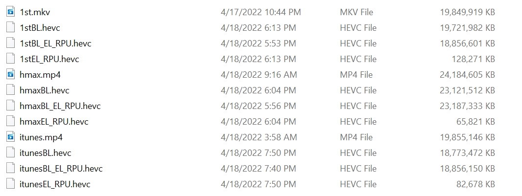

Post by quietvoid » Tue Apr 19, 2022 2:18 pm
RESET_9999 wrote: Mon Apr 18, 2022 9:54 pmItunes RPU is much larger even without L5 and L4. @Quietvoid, any idea why?
The iTunes stream has extra chroma reshaping, which makes reds slightly brighter.
https://slow.pics/c/Oa5JZnp6
So the reshaping params take a lot more bytes:
"num_pivots_minus_2": [
      7,
      3,
      3
