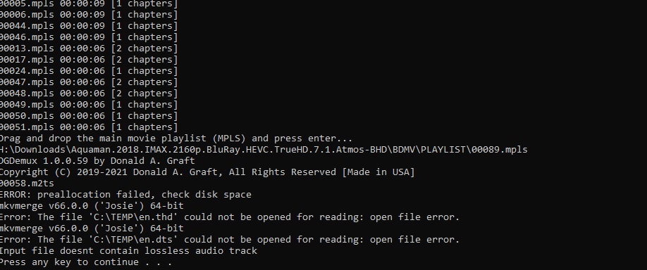

Thank you for the Reply i did Try that but i got an error here is an Img ( there is plenty of space)
Post by RESET_9999 » Sat Apr 16, 2022 10:05 pm
redoine322 wrote: Sat Apr 16, 2022 2:54 pm i did Try that but i got an error here is an Img ( there is plenty of space)
yeah DGdemux wont work if you place the folder on your C:\ drive... do you have another drive you can put the folder on?
redoine322
Joined: Fri Apr 15, 2022 2:16 am
Post by redoine322 » Sat Apr 16, 2022 10:24 pm
RESET_9999 wrote: Sat Apr 16, 2022 10:05 pm
Same Problem i did try it on two different drives
Post by RESET_9999 » Sat Apr 16, 2022 10:28 pm
redoine322 wrote: Sat Apr 16, 2022 10:24 pm
try 1.2.1, it should work.
https://drive.google.com/drive/u/0/fold ... L2KFZWTqKr
