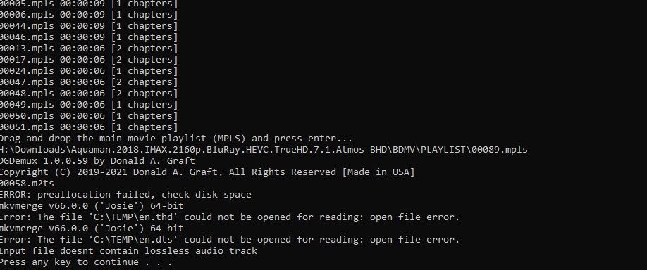

Thank you for the Reply i did Try that but i got an error here is an Img ( there is plenty of space)

yeah DGdemux wont work if you place the folder on your C:\ drive... do you have another drive you can put the folder on?

Same Problem i did try it on two different drives

redoine322 wrote:
Sat Apr 16, 2022 10:24 pm
try 1.2.1, it should work.

thank you So much it working Great Now here is the result the Dv is triggered but No audio on the Tv it says "this video does not support audio" .

Hi guys, Im kinda new to all this so here it goes:
I have some 4K files in p07 that I would love to convert to p8.1 or p5. I saw several messages here but Im kinda lost with this coding and muxes. I was able to instal ffmpeg in my mac (m1) but now i dont know what to do to convert a file. do i need to install anything else? Is there a tutorial for this?
